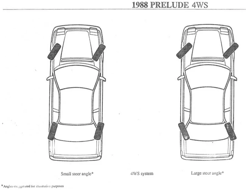

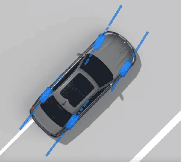

4 Wheel Steering is not active at high speed.
I think that is incorrect. The rear steering is active at high speed too.
There are different steering directions & angles used for slow speed vs high speed.
At low-speed the rear steering is in the opposite direction to the front steering.
At high-speed the rear steering is in the same direction to the front steering.
( all wheels steer in same direction).
This makes vehicle kinda move sideways and this is more stable handling than when just normal front steer only is used.
How Does Four-Wheel Steering Work?
Let's get that rear end to shimmy and slide.
Updated on Sep 12, 2023
By Jonathon Klein
https://www.thedrive.com/cars-101/41613/rear-steering
Rear-wheel steering is a mechanism that, when the steering wheel is turned, actuates the rear wheels’ angles and either turns them in tandem with the front wheels or in the opposite direction to better increase a vehicle’s low- or high-speed agility.
** A high speeds the small steer angle mode is used.

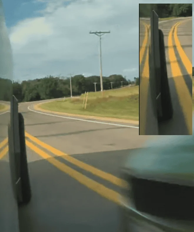

The 4 wheel steering actually caused your back end to move closer to the other car so not sure it saved you but glad you missed it
That's not what I saw. Looks like he was going fast enough that the rear steer was in phase so the rear wheels steered *away* from the wayward car along with the front. It is subtle, but the image below shows the rear wheel during evasive steering and I inset a shot from the same video a couple seconds before and if you look closely, the wheel is turned slightly inward during the evasive steering.

Over about 40 MPH the rear wheels steer in phase, around 2 degrees max.
