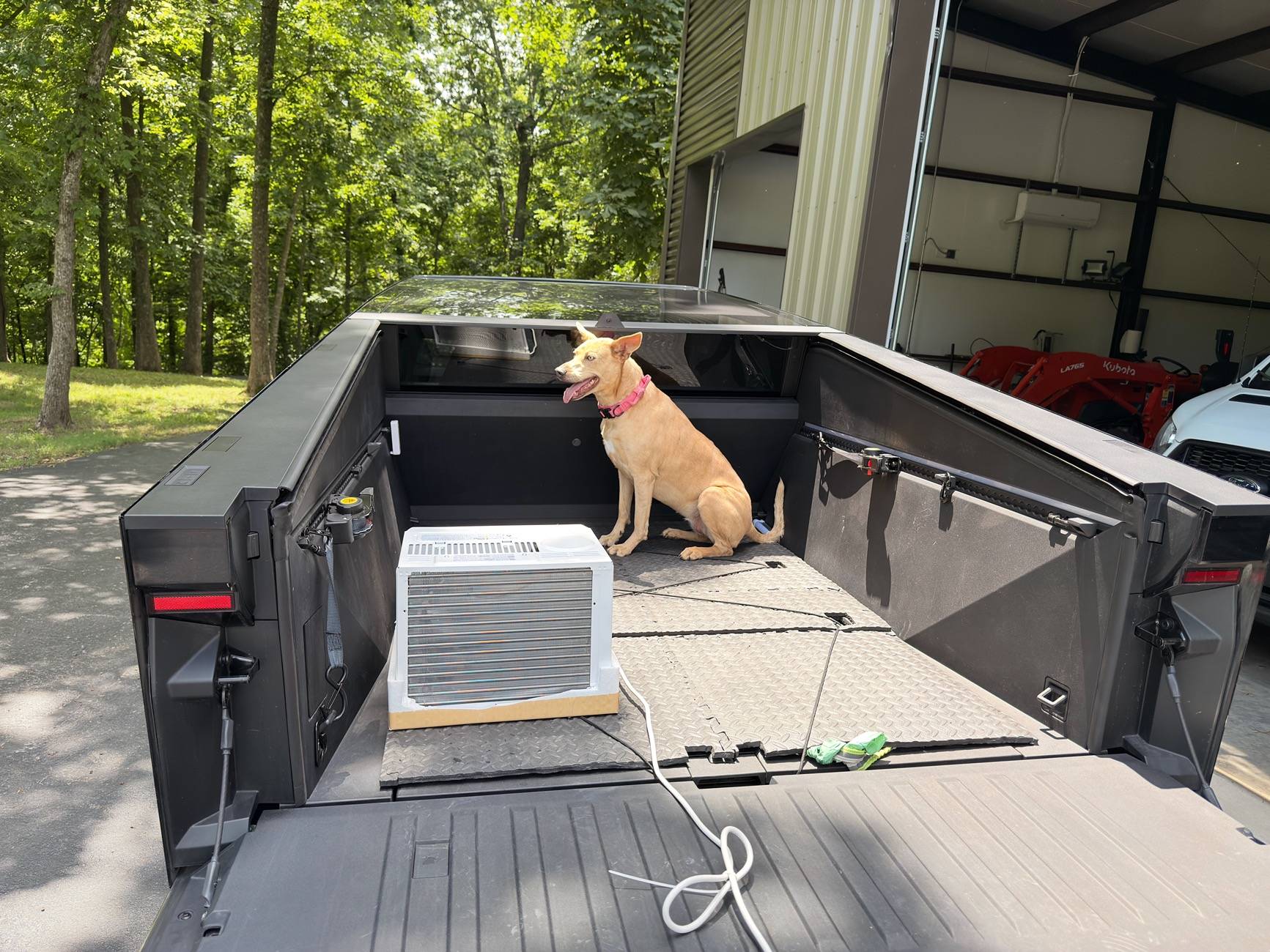

I take my dog on a few long road trips a year. She sheds a ton, and the cab is full of people. So I put here on the back, dogs love the back of trucks. The problem is on the highway I need to close the cover so she doesn’t get blown away. So I put in an AC system.

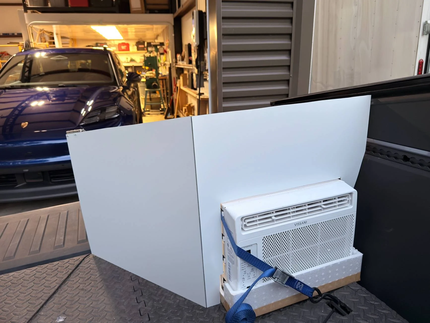

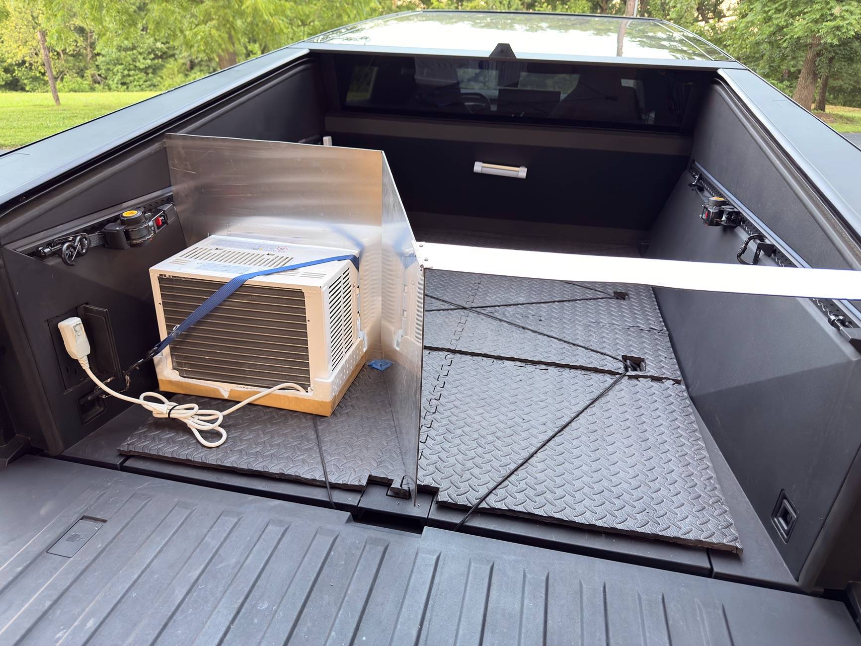

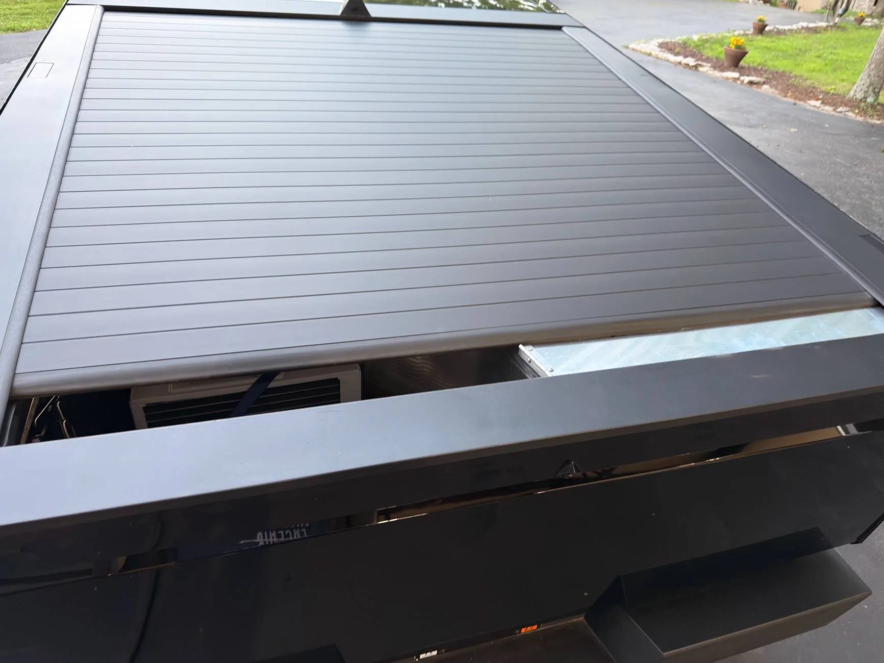

Simple window unit, uses 0.6 watts at full power, and it doesn’t run at full power once it reaches 72 in the back. I separated the back into two separate areas, a cold area that is the where the dog sleeps, and a “outside” area. I leave a small gap in the cover so the hot air can escape and gets swapped out by the rushing air over the top.
I’ll add some foam around everything for insulation, to make it a bit more efficient, but as is I only loose about 1/2% per hour of driving

We tested it out. Not that loud back there. The AC unit is louder than the wind and road noise. She is actually very comfortable back there, enough that she sleeps. When the cover is open she stands there a bit scared with her tail between her legs.

I have a remote thermometer back there, and in my testing with the cover slightly opened, it easily got up to 108 degrees back there.
I'm not sure how a kennel would be any safer, the bed closed is just a large kennel. If I get in a wreck, the dog is going to be doing some bouncing around either way.
