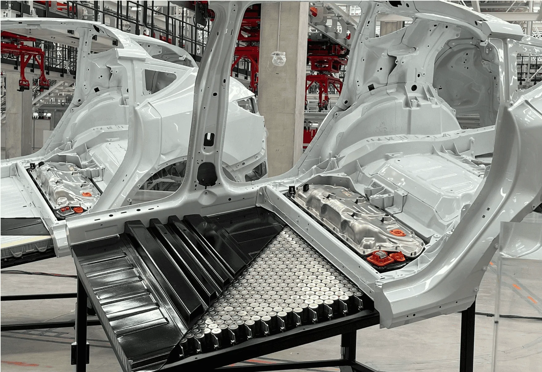

If this 4680 pack was in Berlin wouldn't it be for ModelY? Does ModelY get a structural pack? Perhaps cooling for non structural 4680 and structural are different....
They could also use aluminum for cooling. Most heat sinks are aluminum. While aluminum is not quite as good a thermal conductor it might not matter for 4680.
Battery heat is from internal resistance and the shortened electrical path via shingled contact surely reduces internal resistance. Indeed this has to be true, If heat has an easier means of escape from the cell than electrical resistance does not increase, then less heat is created. End result is a pack that can charge faster and creates less heat needs less thermal management and maybe doesn't need copper tube.
The 4680 pack pictured is definitely the "structural" pack, and if that is a MY chassis, then the MY is getting a structural pack. Plus, the body in white has no floor. The battery pack's top lid is the body's floor.
And I agree with everything else you wrote. Less electrical resistance, less heat, less cooling efficiency needed.

Yes, MY is first the get Structural pack with front and back casting.

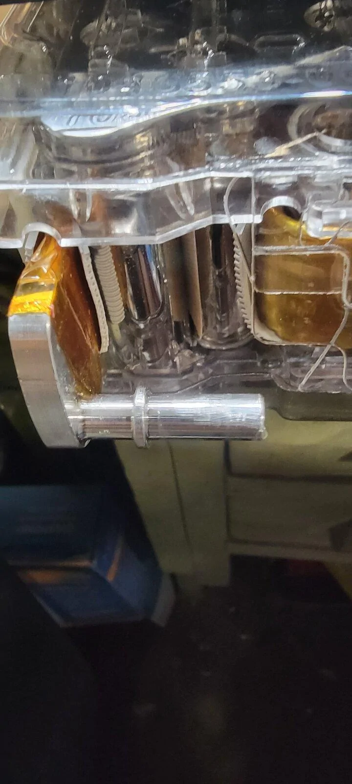

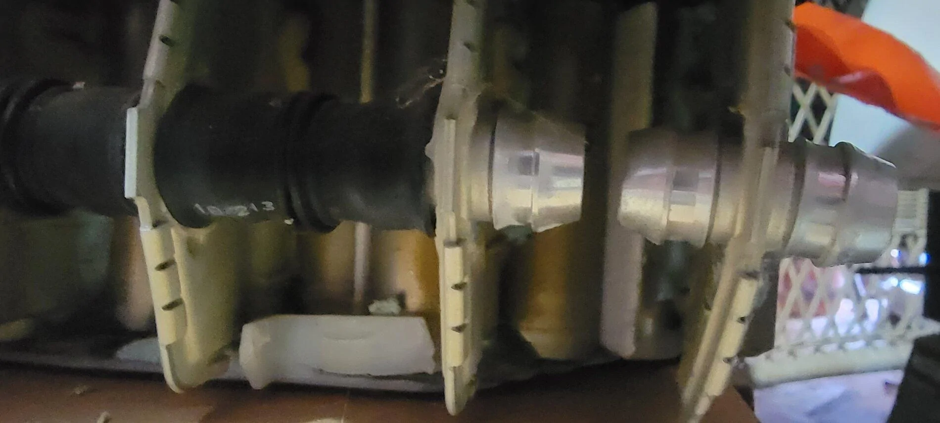

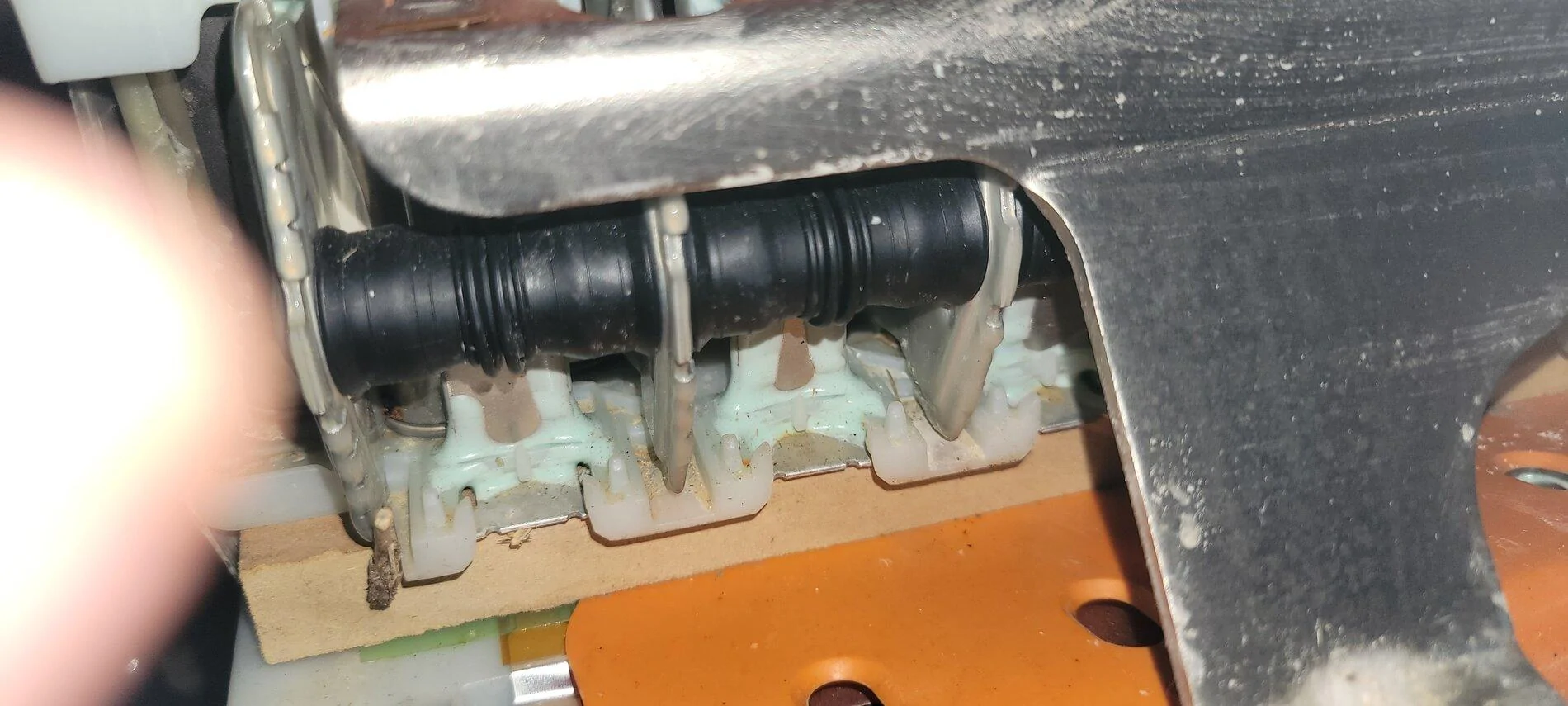

According to US8758924B2 " Exemplary materials for the cooling tube include metals such as aluminum, an aluminum alloy, steel or copper."
Does not specify which or the combination of which they use.
From all the packs I tear down to the cell level, which includes removing the cooling ribbon. All have been aluminum that us covered with the same damping material as mentioned in the number above.
Only one different is the LFP Packs, I have not touched one yet, but Sandy has and that is a complete different beast, and it's a Beauty!!
It is structural, it is on the Model Y. Photo below is same pack, on the vehicle.

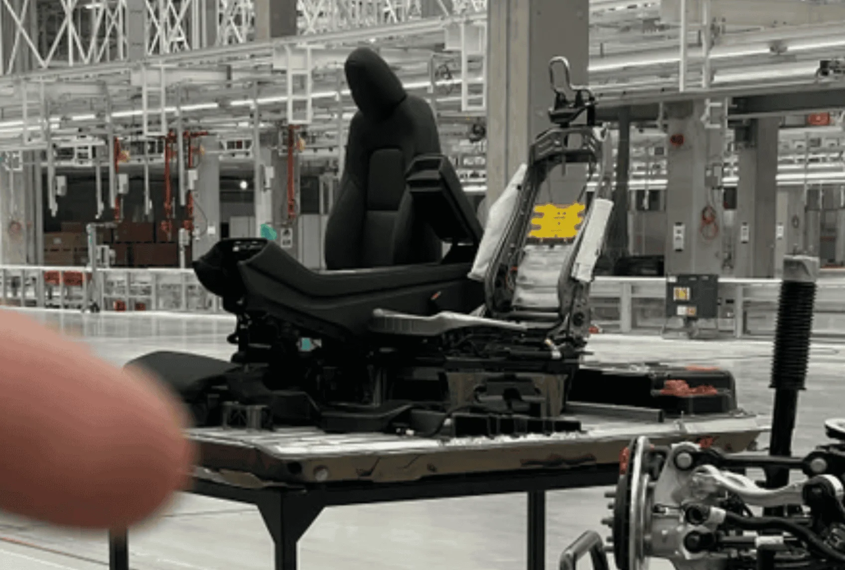

In another place on the tour, they have the seats bolted directly to that formed metal which is right atop the battery. Apparently they now bolt the seats and console onto the battery pack before the Body is attached then lower the body down onto the pack with the seats attached.
This all makes me wonder how similar the Cybertruck process is going to be.
Isn't this going to make it impossible to replace the battery when it reaches EOL?
Apparently they can drop the whole battery pack out the bottom of the car, seats and all.
Tesla Cybertruck 4680 Battery Anode at Giga Berlin 1633975498445
Thats how they assemble it, they put the seats on the pack first, then they slide it into the body. I assume you could do the reverse if you need to replace the battery.
