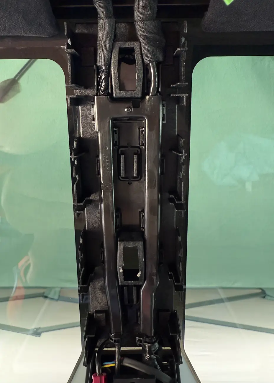

What the white plastic male clips look like with console removed:
Tesla Cybertruck Fix for loose overhead console assembly (where magnetic sunvisors attach) 1758145231630-mi
