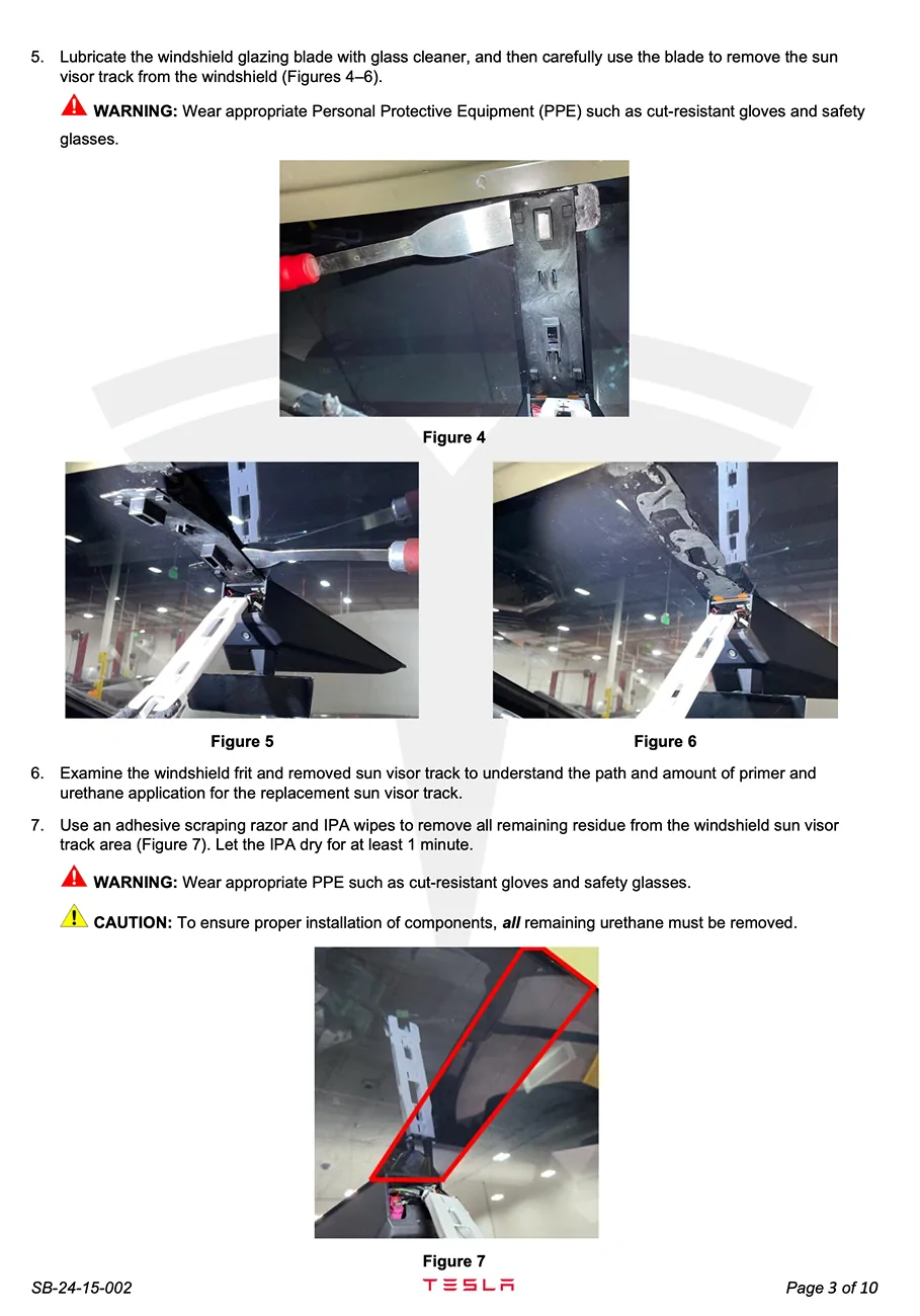

That procedure shows the bracket is integral to the windshield and has no removal/ install steps for it. (Note: some windshield photos are pre-production and from other models)
It does for the wire harness which clips on though.
Because the windshield comes with the bracket installed doesn't mean there's not a procedure for replacement. I'll point you to the PDF I posted earlier.
The pdf outlines prying off the glued part, and re-gluing a new one in its place.
This is correct.
