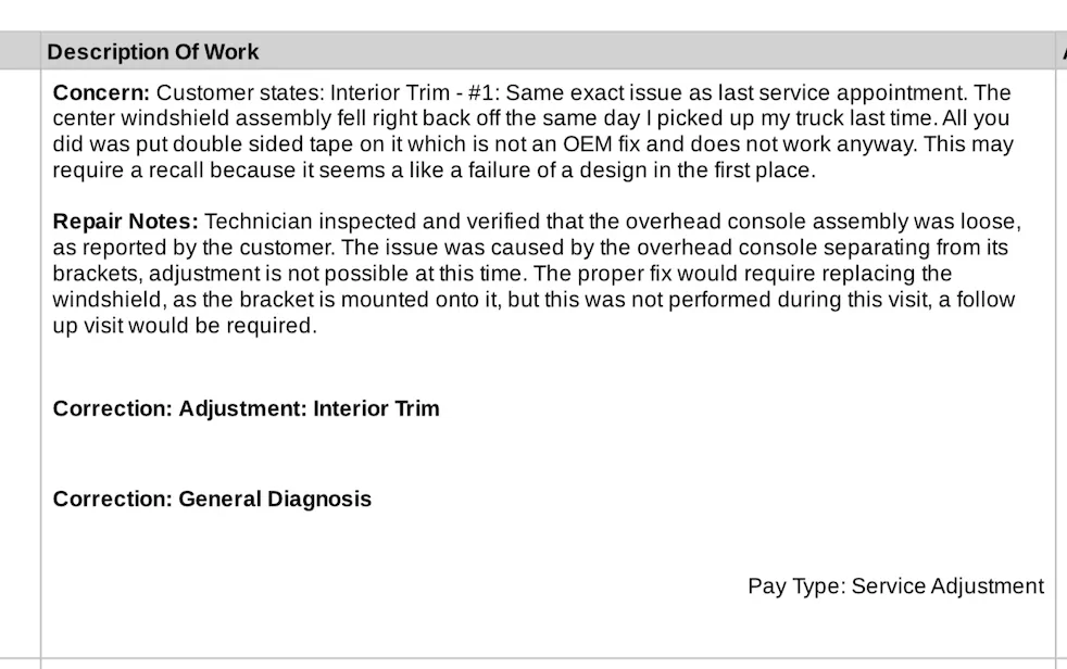

They told me they could not replace the top component without replacing the entire windshield since it is part of the windshield assembly. The service manager thought it was stupid but blamed it on a bad CT design (it is stupid). They are either full of shit, or your SC didn't replace the top part unless they replaced your entire windshield.

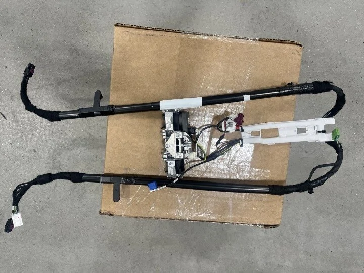

Yours was probably just lazy. Mine replaced Front Overhead Console, Sun Visor Track, And Windshield Harness Bracket. There is a procedure in the service manual for replacement and it involves prying off the part that is glued to the windshield and re-gluing the new part.
What service center? Seems like they were feeding you a load of BS.
This is basically what they did:
https://service.tesla.com/docs/Serv...isor_Track_And_Windshield_Harness_Bracket.pdf Sponsored
Wow, still crazy overcomplicated though when I just fixed it the way I did. I could see that procedure being necessary when something is seriously wrong with the overhead unit, but for a 1-cent plastic clip not grabbing well? Just reshaping the plastic makes way more sense.

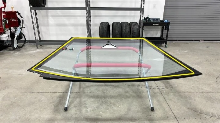

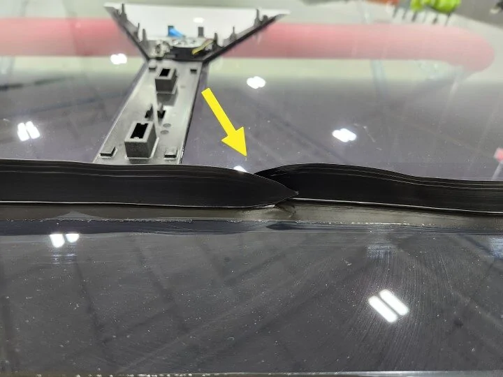

From the Tesla service manual, it looks like the back of the overhead console is mounted to the glass with glue. Here in the manual it shows the window replacement, and they showed the overhead display being removed from the original window and then applied to the new one.
I think your service center couldn't find the correct answer and made one up or they are just Lazy.
I know there’s some questionable design choices for the Cybertruck, but it would monumentally stupid if the only way to replace the plastic overhead console would have to include replacing the large and expensive front windshield too. :ROFLMAO:
https://service.tesla.com/docs/Cybe...:text=Release datums from <em>windshield</em>.
May 27, 2024
4,659
5,661
https://service.tesla.com/docs/Cybertruck/ServiceManual/en-us/GUID-28743D4C-E164-4741-8C95-D09F014DC857.html#:~:text=Release datums from <em>windshield</em>.
That procedure shows the bracket is integral to the windshield and has no removal/ install steps for it. (Note: some windshield photos are pre-production and from other models)

I have had this issue since I bought the truck almost a year ago. I have brought it to the service center twice for a fix. The first time they simply stuck double sided tape on it, which did not work at all, and it literally fell back down as soon as I picked my truck up from them. I have just been dealing with it hanging down until I got fed up and recently brought it back in again. This time, they updated my service ticket to bring it back in a third time after they ordered a new windshield replacement since that assembly is permanently attached to the windshield and that was all they could come up with to fix it. Well, both me and the service advisor thought that was stupid as hell to fix a 1-cent plastic clip's failure to hold, but they didn't know what else to do. So, I put some thought into it, especially since my windshield is also tinted with high-quality cermic tint, and Tesla does not reimburse for that.
