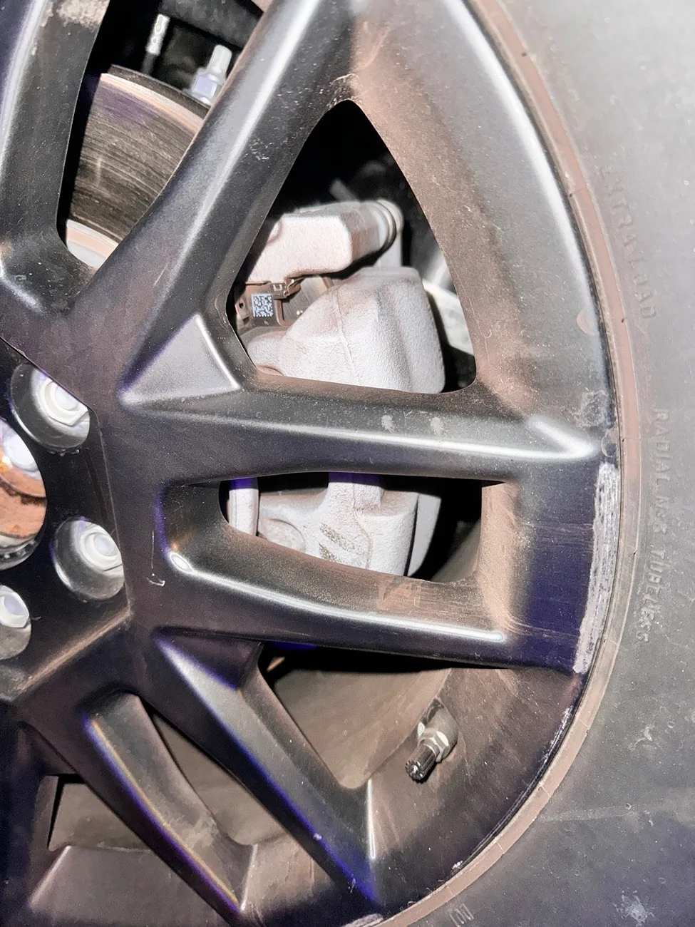

I was inspecting my Cybertruck wheels before the winter snowfall.
And, I noticed the core wheel covers making these 7 abrasion marks around the rim:
Tesla Cybertruck Prevent wheel abrasion from core wheel covers by using liquid rubber padding or wire harness tape 20251221_125717
This is where the core wheel covers made of hard plastic contact the rim.
(Images show before and after the rim was cleaned)

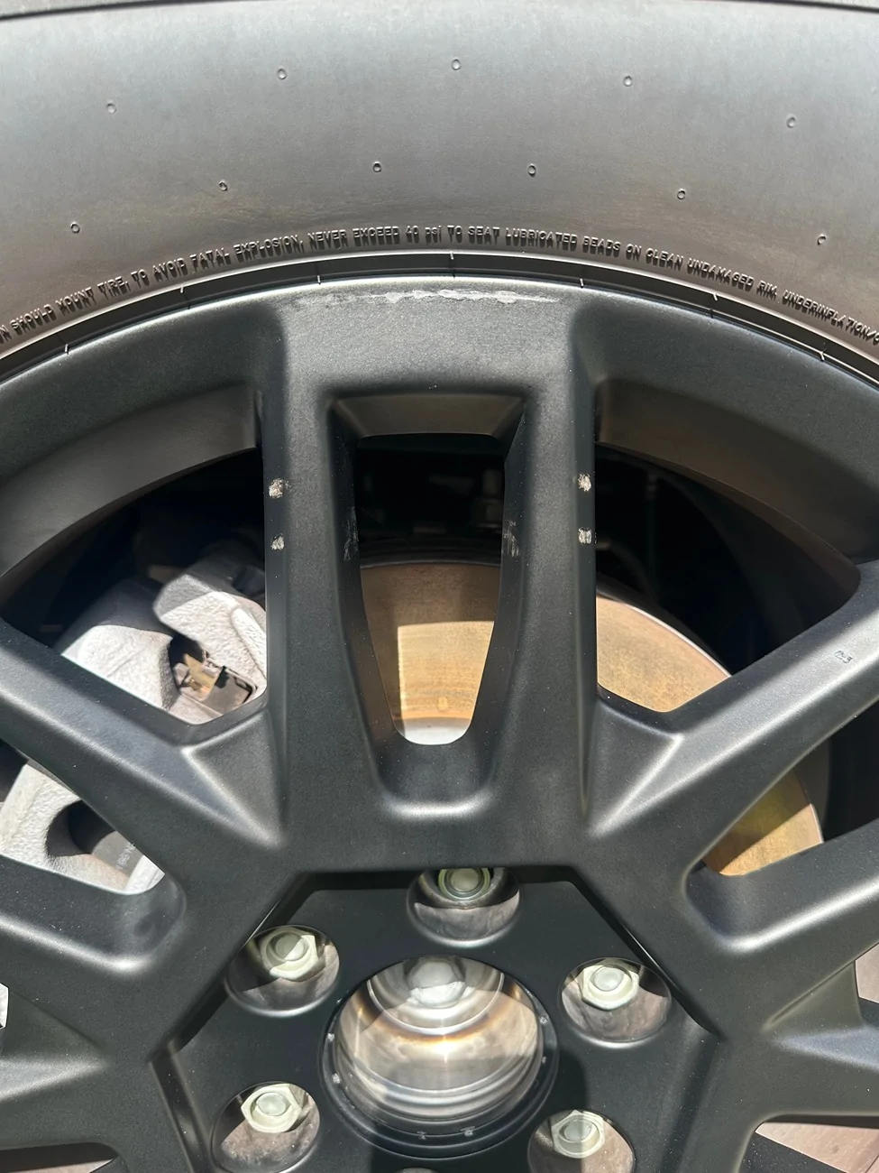

Tesla ultimately replaced all 4 of my wheels under warranty due to this damage. They acknowledged that this is kind of damage is a known issue with these wheel covers.

I had to push back. At first they tried “buffing” the wheels. They said “this kind of damage is not covered by warranty and can be caused by “improper removal”. Then they acknowledged that this was a “known issue” with the wheel covers and replaced my wheels after i spoke to the manager.

Mine damaged all 4 wheels even with nothing broken. They did say that this type of damage isnt typically covered, but then they said its a known issue with the covers and that gave me leverage to push that an oem part functioning normally should not damage the truck. If it does its a defective design and warrants that the damaged parts be either repaired or replaced. They tried to repair it by buffing out the scratches, and couldn't so i pushed for replacement.
