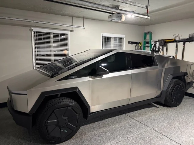

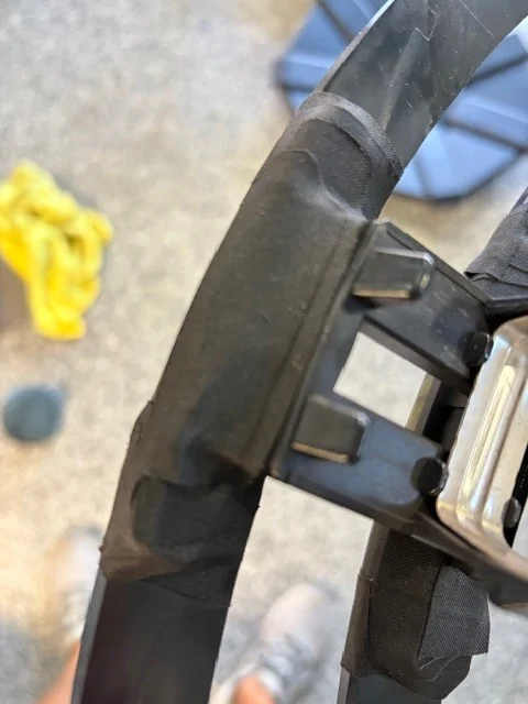

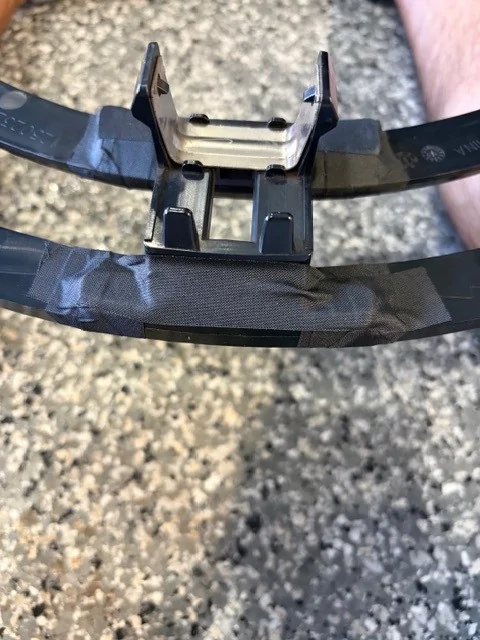

I used wire harness tape to wrap the areas of the Cyber wheel aero cover where it rubs the wheel. So far so good. I love the covers and feel the look is what makes the cybertruck look like a cybertruck!

Nice! Will have to get some of that wire harness tape to try on this and other things. Thanks.

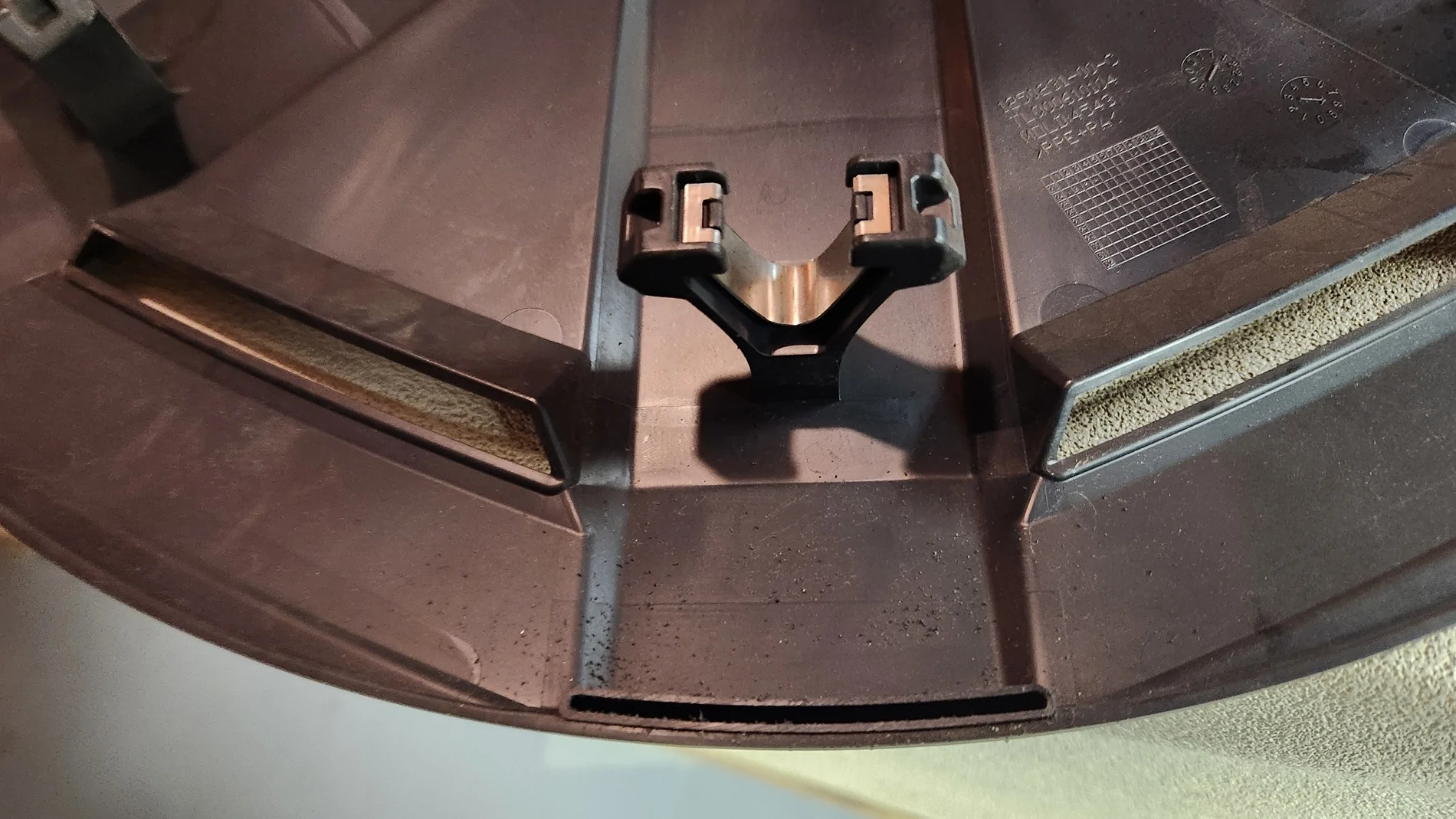

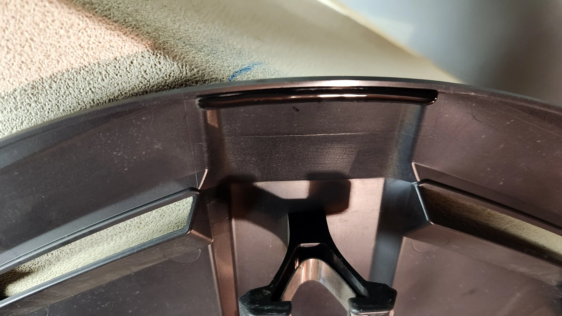

After some thought, I came up with an idea to add rubber padding to the core wheel covers.
STEP 1: Use a file to smooth out the contact surface (7X) and remove any sharp edges.
STEP 2: At you local hardware store, buy a can of FLEX SEAL (black),
and a syringe with a small needle.
STEP 3: Fill the pocket with FLEX SEAL as shown.
FLEX SEAL is thin enough to suck up into the syringe for re-filling.
Important, over-fill the pocket to create a rubber pad (7X).
I ended up with a .030" to .040" bead above the surface.
You can wipe up any excess if necessary.
STEP 4: Allow the FLEX SEAL to cure 24 hours.
FLEX SEAL does not shrink much at all, and I was happy with the results.
Hopefully, this will at least slow down any further abrasion.
This took around 2 hours from start to finish.
