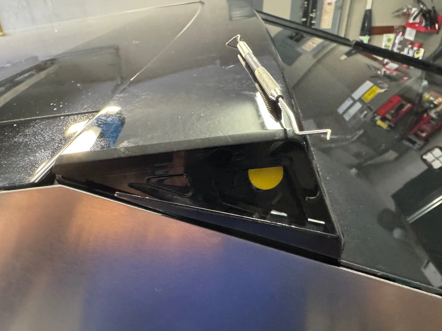

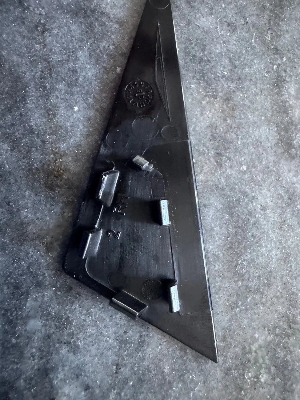

Well you do have an option. You can remove the bracket after they install it. Before taking it in for that application pop off the side plastic covers and keep them. Two screws with a plastic insert can be removed. Above the plastic appliqué nearest the windshield edge they will install a rivet nut Remove that screw and the bracket comes off, replace it with the plastic pieces you removed. Just my .02 cents.
Tesla Cybertruck Light Bar Recall for 2024 Foundation Series Cyberbeast (6,197 Units Affected) IMG_2122
Tesla Cybertruck Light Bar Recall for 2024 Foundation Series Cyberbeast (6,197 Units Affected) IMG_2124
