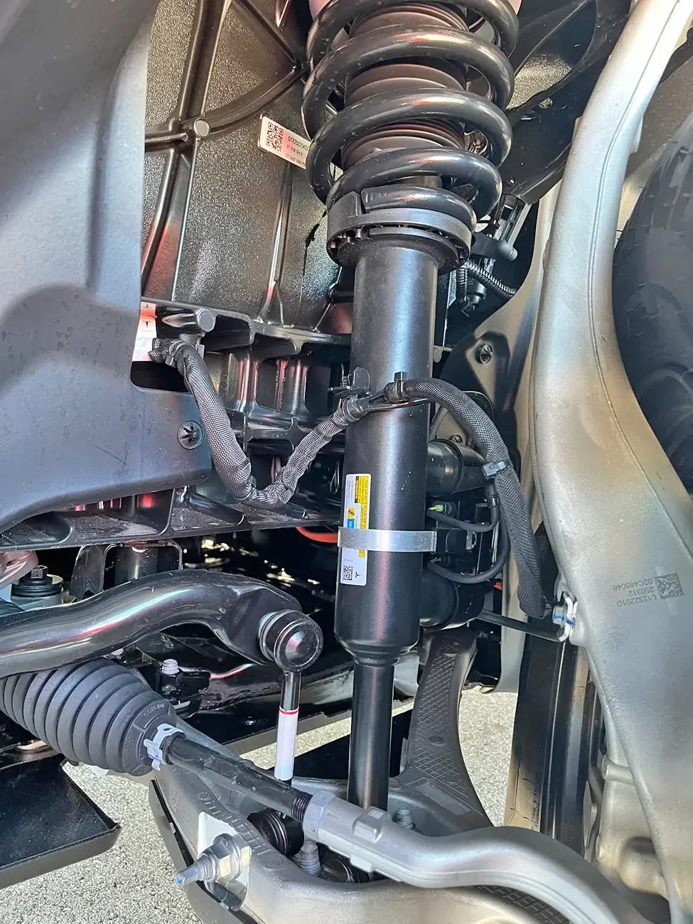

Yeah. Almost every car in the world uses springs. I don’t even think it’s the reason for the lower towing capacity. I think the lower towing capacity is not really lower just listed as lower, to help push the sale to the premium model, also less warranty claims. But I bet there is no difference in actually what you can tow. Unless they added some software limit.
When towing heavy loads, the air suspension does a lot of work keeping the truck fairly level and reduce how much the rear sags. If they tuned the suspension for more comfort, it will likely be on the softer side. Which with a lot of tongue weight, would cause the rear to sag quite a bit. Combine that with independent rear suspension and it compounds. I'd bet the tow rating decrease is almost entirely due to that. Trucks simply can't accept nearly as much tongue weight.

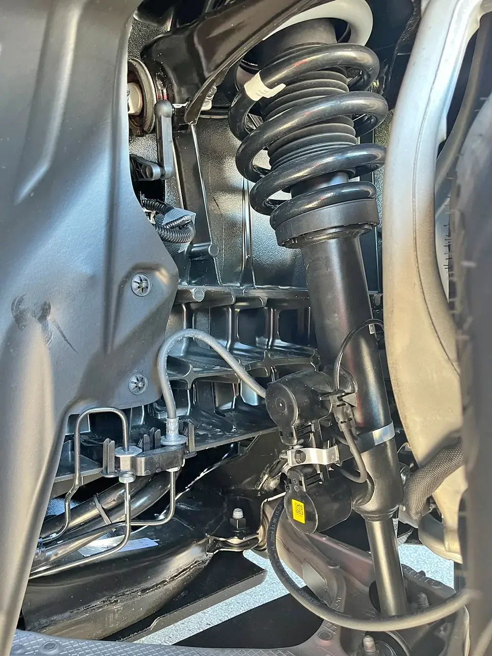

With coil springs, it is difficult to have variable rate springs that can compete with the old leaf springs. Primary reason almost every (maybe every?) heavy hauling pickup truck uses leaf springs in the rear. It would make sense to lower the tow capacity on a truck with coil springs over air suspension.
It can be done... the Lightning, GM EV trucks, and Ram 1500s all use coil springs in various trims. It is simply a compromise of ride quality vs capability. Given how few people tow loads that large, especially with EV trucks, it makes sense to lean towards comfort over capability.
