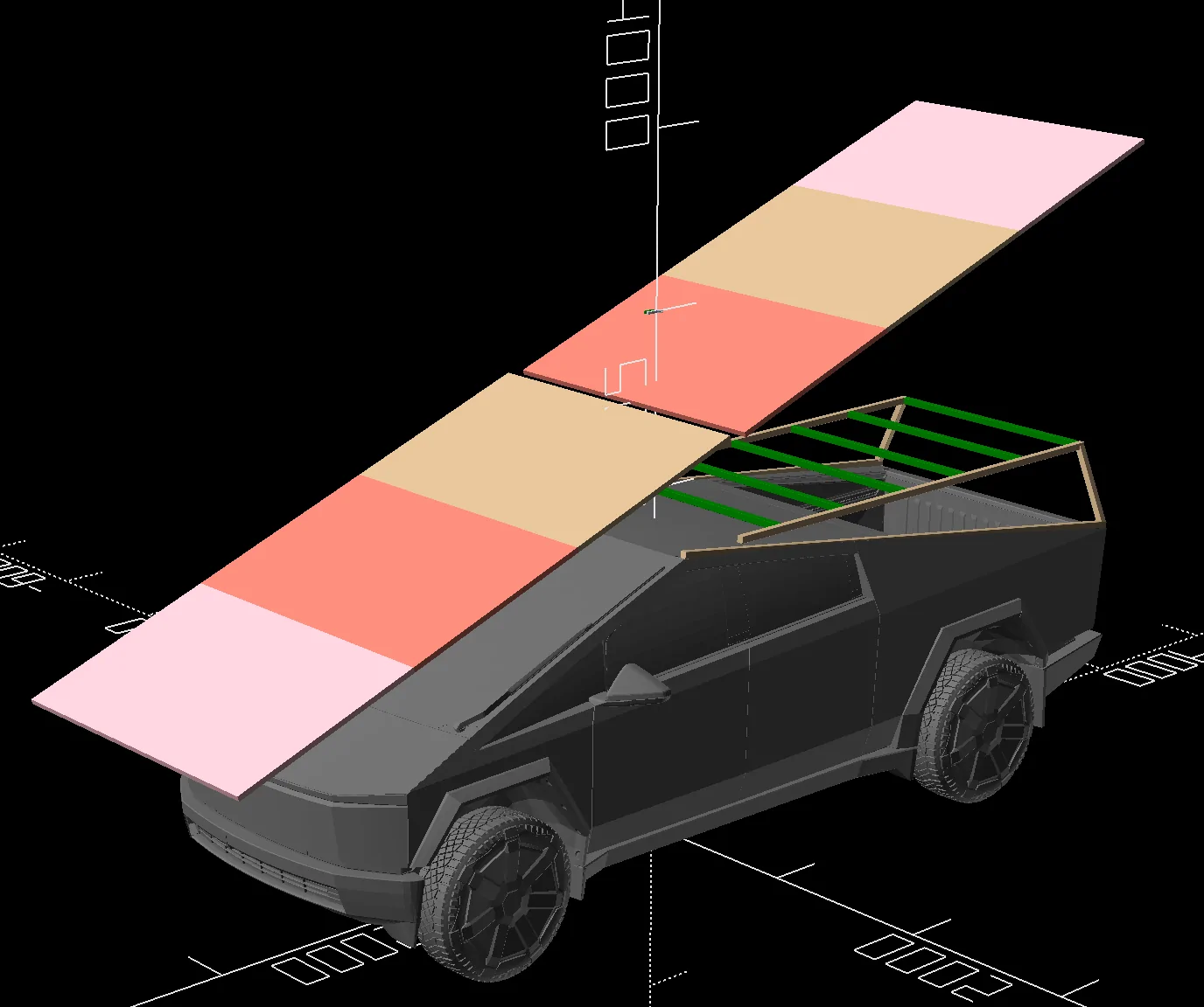

I've been thinking about that for what I would want. First, make a door and move the rear camera to the door. Once you recalibrate the cameras, FSD will come back after some driving. Second: This allows for greater roof surface for solar panels. I one orientates the standard 1762 mm x 1134 mm solar panels with the long ways cross wise, one can put three of them on the roof behind a reasonable wind deflector from the windshield. This is overhangs the top of the bed wings, but is not larger than the footprint of the CT. If you make the solar panels as a roof for a roof top tent, it can be pointed south for better solar gain. You also end up with a virtual palace of a roof top tent. Being ingenious with design it would be possible to have two or three layers of solar panels. Thus allowing them to serve as awning while collecting sun. This gives you a significant solar gain above all electric cooking would require.
How to hold extension body panels onto the base. Pins for alignment, and draw clamps for holding them tightly in place and compressing seals for waterproofness.
I have a number of ideas for how to open it up and have roof top tent and some awning shade too. Each design has it's advantages and disadvantages. I have ideas in my notes on how to make the mechanisms needed in the designs. I just need to CAD them out to see if they really work. The single layer of panels obviously will work. The question is do I hinge it at the front or use even or uneven scissor lifts. An uneven scissor lift allows it to tilt as it lifts, and provides more height at the low end.
Down sides: It would make backing into a V3 or V2 Supercharger problematic. Can you back into a V2 or V3 Supercharger with the tailgate down? Obviously more weight and up high. More wind drag. Ruins lines.
These are some OpenSCAD screenshots of what a three high stack looks like close to where it may end up. It doesn't even extend past the tailgate down. These are 30mm thick frame solar panels with 10 mm gaps between the layers. No other structure. With 9 solar panels you can think of recharging the CT some.

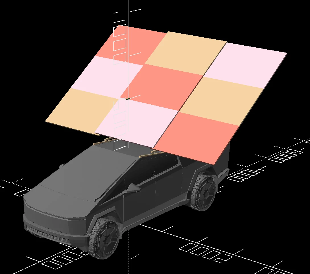

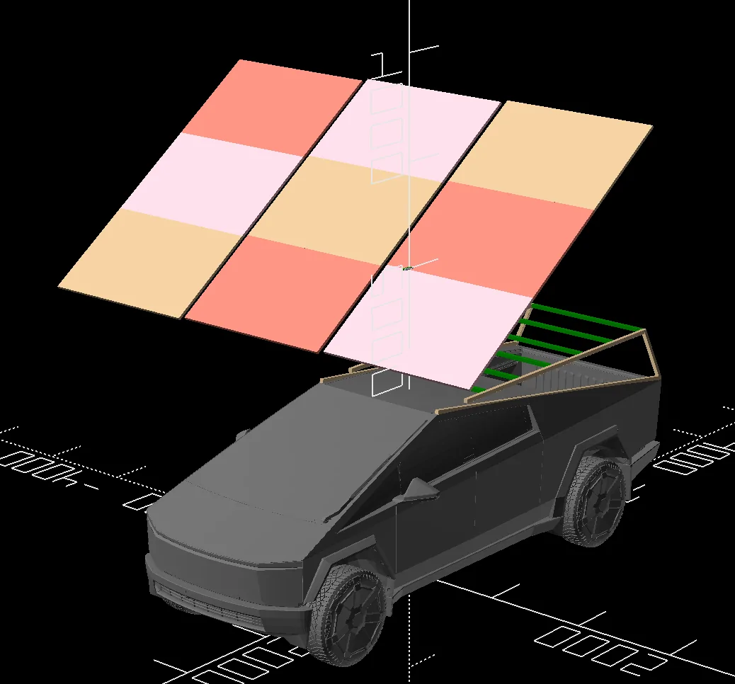

Thought it would be good to give a visual idea of some of the sloped options one could tuck a tent under. I can see easy ways to do the pulling out of the "drawers" of solar panels for these designs using standard drawer slides I've seen for sale. I can also see how to automate their extension and retraction using common off the shelf parts. I also can see how to provide support back to the CT versus poles to the ground. Some of the support methods allow partial automatic retraction if there are high winds. Another method retracts some pins and drops the supports to the ground. It then can do a full retraction.
This is the one I like best for general use. Only 2 sets of three panels. Top panel and the surrounding frame would provide a waterproof cover for all the mechanisms and the tent while stowed. At a Supercharger stop, or just stopped in a parking lot, the top could be pulled forward and provide shade and expose the root top tent roof solar panels for double the solar gain. For camping an unequal scissors lift raises the whole top up and tilts it forward. It's possible to add a third set of three solar panels off the front or rear. It gets quite high off the rear in tent mode. This style could have a side or 270 degree awning for shade in camp.
Tesla Cybertruck Urander Enclosed Bed Cap Review. "This Cybertruck Mod Changes Everything!" Screenshot From 2026-03-18 22-31-02--cro
These to show a 35 degree slope, hinged at the front, with the pull out panels to both sides and just one side. With the solar panels all to one side it is maybe too much.

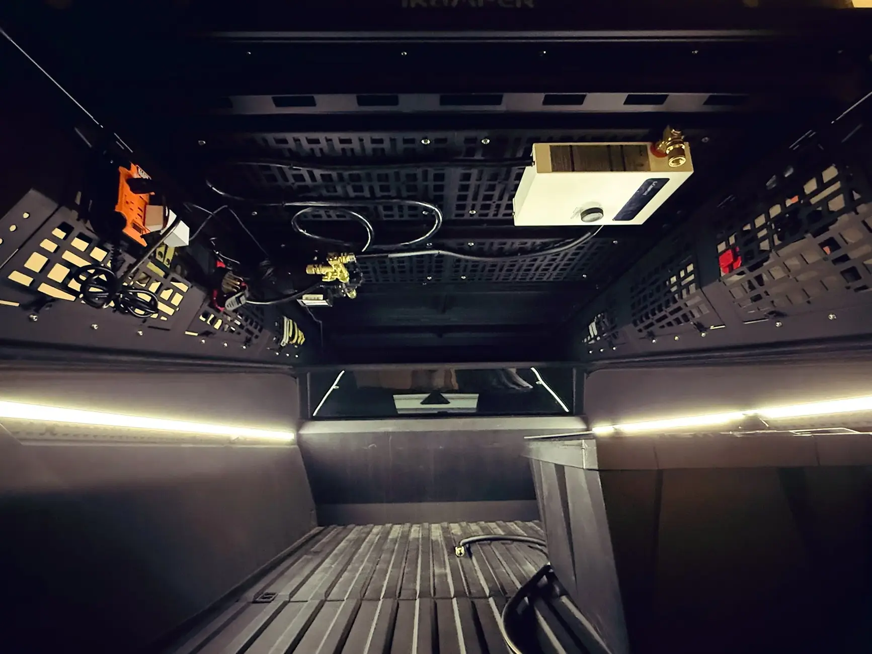

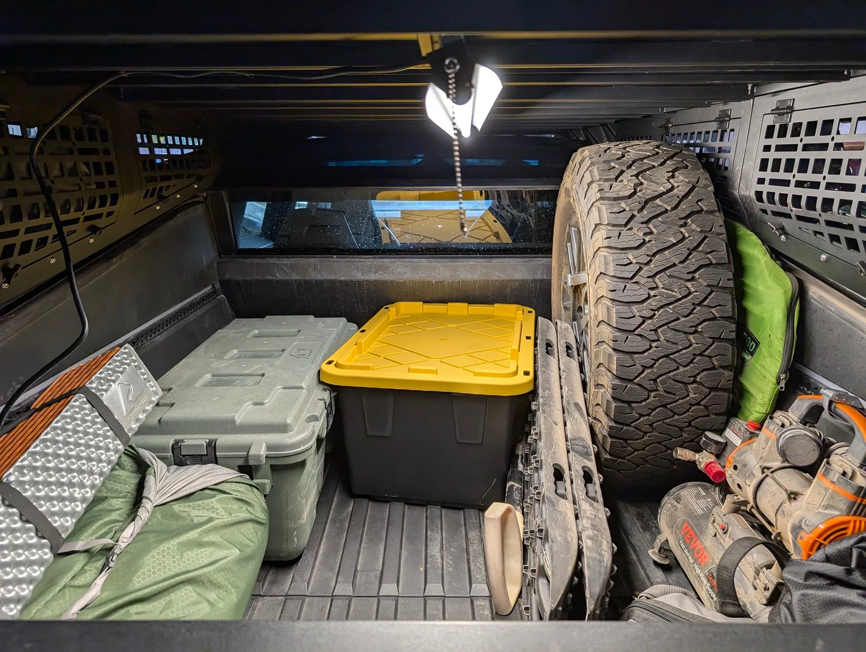

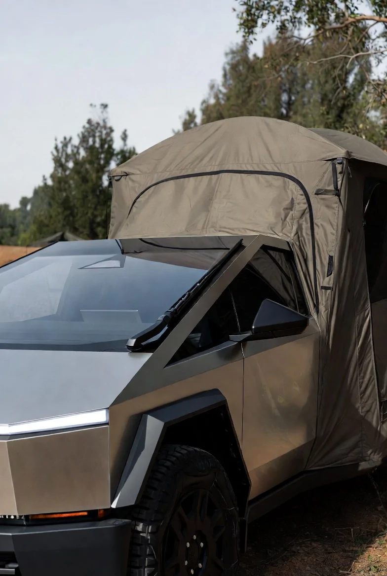

Take this concept, have the material extend to both rear windows - then you'll have an enclosed air-conditioned / heated tent. Something like this:
It works great for weekend trips, but once you’re doing week-long overlanding, that extra room really starts to matter. You won’t get double the bed space, and a bigger tent eats into your storage pretty fast. Which is probably why at any Overland Expo, you’ll notice pretty much every ICE truck out there is running a rack or a bed cap😊
