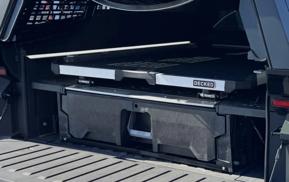

nice but it makes it so hard to use all the bed space when you can’t climb in standing.
That’s exactly what the bed slide is made for!
Tesla Cybertruck Urander Enclosed Bed Cap Review. "This Cybertruck Mod Changes Everything!" IMG_4482
Tesla Cybertruck Urander Enclosed Bed Cap Review. "This Cybertruck Mod Changes Everything!" IMG_4077

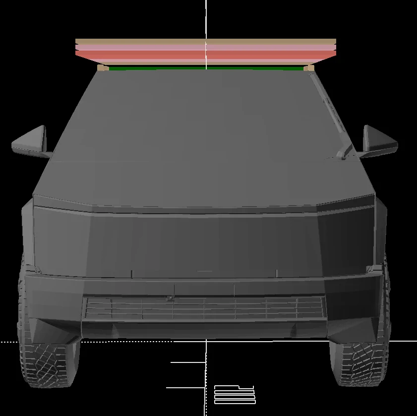

These are some OpenSCAD screenshots of what a three high stack looks like close to where it may end up. It doesn't even extend past the tailgate down. These are 30mm thick frame solar panels with 10 mm gaps between the layers. No other structure. With 9 solar panels you can think of recharging the CT some.
I'm looking at the rack as a base for a trailer wind deflector. Or it might be sufficient on its own. Spoiling the air merge at the truck's rear hurts non-towing range but likely improves things when towing.
There are some panels that are close to an exact match for the rack width and length. 4 panels for 800 watts. https://callsunsolar.com/products/n-type-16bb-200w-bifacial-solar-panel
This would be instead of the solid top and I'd connect them to the battery system in the trailer which can double as a sub-optimal range extender.

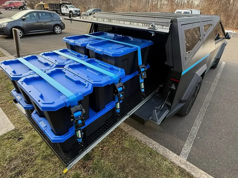

What I am wondering about the Urander unit. Would it have been possible to have the roof panels on the topside of the crossbars and would that not be better for aerodynamics? Those crossbars as they are now, do they not make for turbulence? I am considering a purchase of this cap but the places I go in both northern Canada and Navajo/Hopi lands makes range a bit critical.
That's basically what I did. Loss of range is very important to me, and I bought the bed cap for my dogs and not for hauling stuff up top. So I simply modified Urander's design and mounted the roof panels on top of the side rails instead of the bottom, creating a completely flat surface. No joke; I didn't use over 20 pounds of hardware Urander supplied! And if you have large hands like me (Size 13 gloves), you're going to have to have a curse jar for some of the tight bolts areas. :LOL:
I gained about two inches doing this way for my pack. I used SIkaflex 221 to seal everything up and then used white boat epoxy up top. The difference in temps inside the bed-cap is incredible. In direct sun the underside of the bed cap panels are cool to the touch. Although I am insulating as much as I can as I will be camping in some extreme temps.
Tesla Cybertruck Urander Enclosed Bed Cap Review. "This Cybertruck Mod Changes Everything!" signal-2026-03-23-174347_002
Some of the Urander fit and finish leaves something to be desired.. the side door panels aren't completely straight and don't fully compress the door seals. Although the worst culprit is the door locks.. sorry Urander but they are just terrible latches/locks compared to all the other bed caps I've had. I may try and source upgraded units.
Overall happy with the product and would give it a 7/10 with the current latches and would upgrade my rating to a 8 or 9/10 if they find a better latch supplier. I know they have a certain affordable price-point they try and achieve so my rating is giving some slack on that!

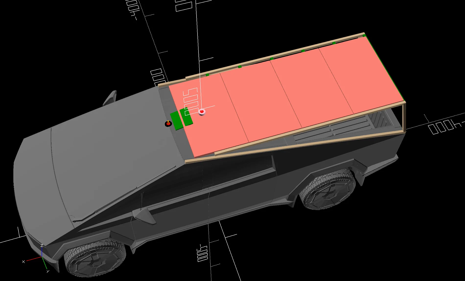

Yes, those solar panels are a great match for roof size. They would be perfect for the super sleek design I'm working on. I hadn't had the time to search for alternatives. The ones I selected will likely be the ones that go on the roof here. I'd just order extras.
I quickly placed 4 of them on my temp frame to see how they fit. Looks like they would work fine on the Urander, and my narrow and super sleek sketches. Salmon colored rectangles are the solar panels. Tan 40mm tubes are just a test frame I sketched to get a base. The green rectangle, bisected by the front panel, is a Starlink Mini orientated with it's long axis side to side, and at a 12 degree tilt. Its back is within a cm of the roof glass. The black cylinder with the red dot is the height of the top of the windshield glass. The pink cylinder is 80mm taller.
Tesla Cybertruck Urander Enclosed Bed Cap Review. "This Cybertruck Mod Changes Everything!" Screenshot From 2026-03-23 21-43-26--cro

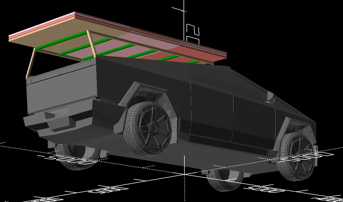

Here is my larger panel design as it is right now. Tail overhang is the same as the with the tailgate down. This is only a sketch. Actual sizes will change. There are many bit I have deliberately not filled in because I know they will change, and it would take a lot of effort to model. The CT model has issues. It will change. I maybe should buy the expensive one. This is just a free model turned into a STL file for OpenSCAD to use. This has a peak of 1275W of solar when closed like when driving..
Tesla Cybertruck Urander Enclosed Bed Cap Review. "This Cybertruck Mod Changes Everything!" Screenshot From 2026-03-23 22-15-40--cro

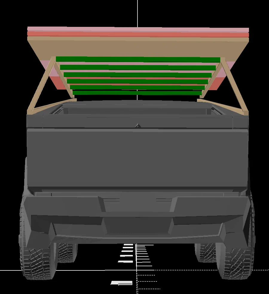

Roof extended over front, tilt not modeled yet. It extends further forward than I was expecting. This raises the solar up to 2550W peak. Operating flat or at the expected 20 degrees it won't get that.
Tesla Cybertruck Urander Enclosed Bed Cap Review. "This Cybertruck Mod Changes Everything!" Screenshot From 2026-03-23 22-21-44--cro
