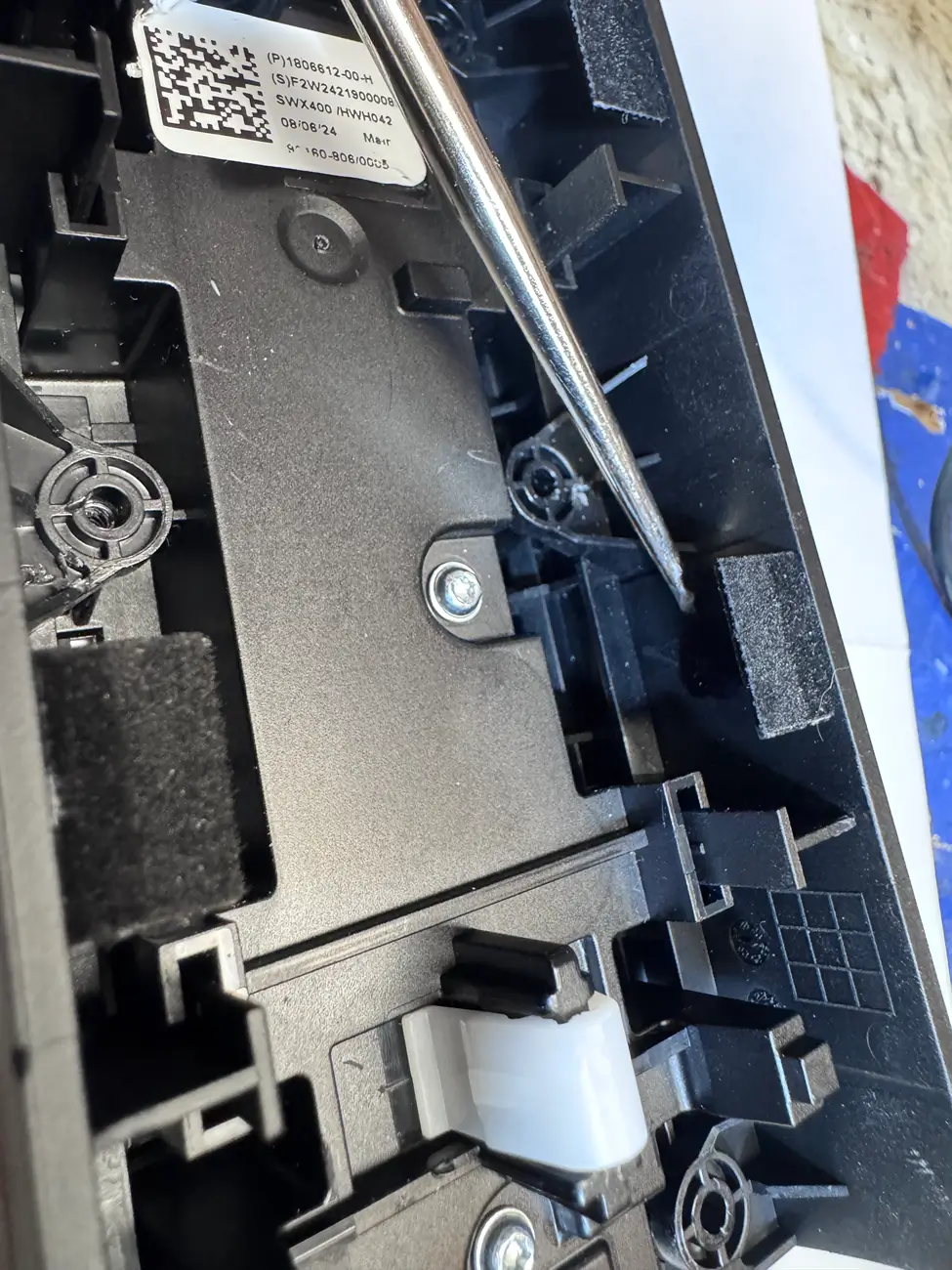

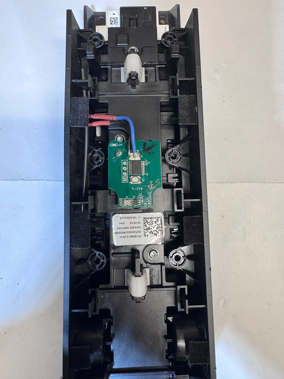

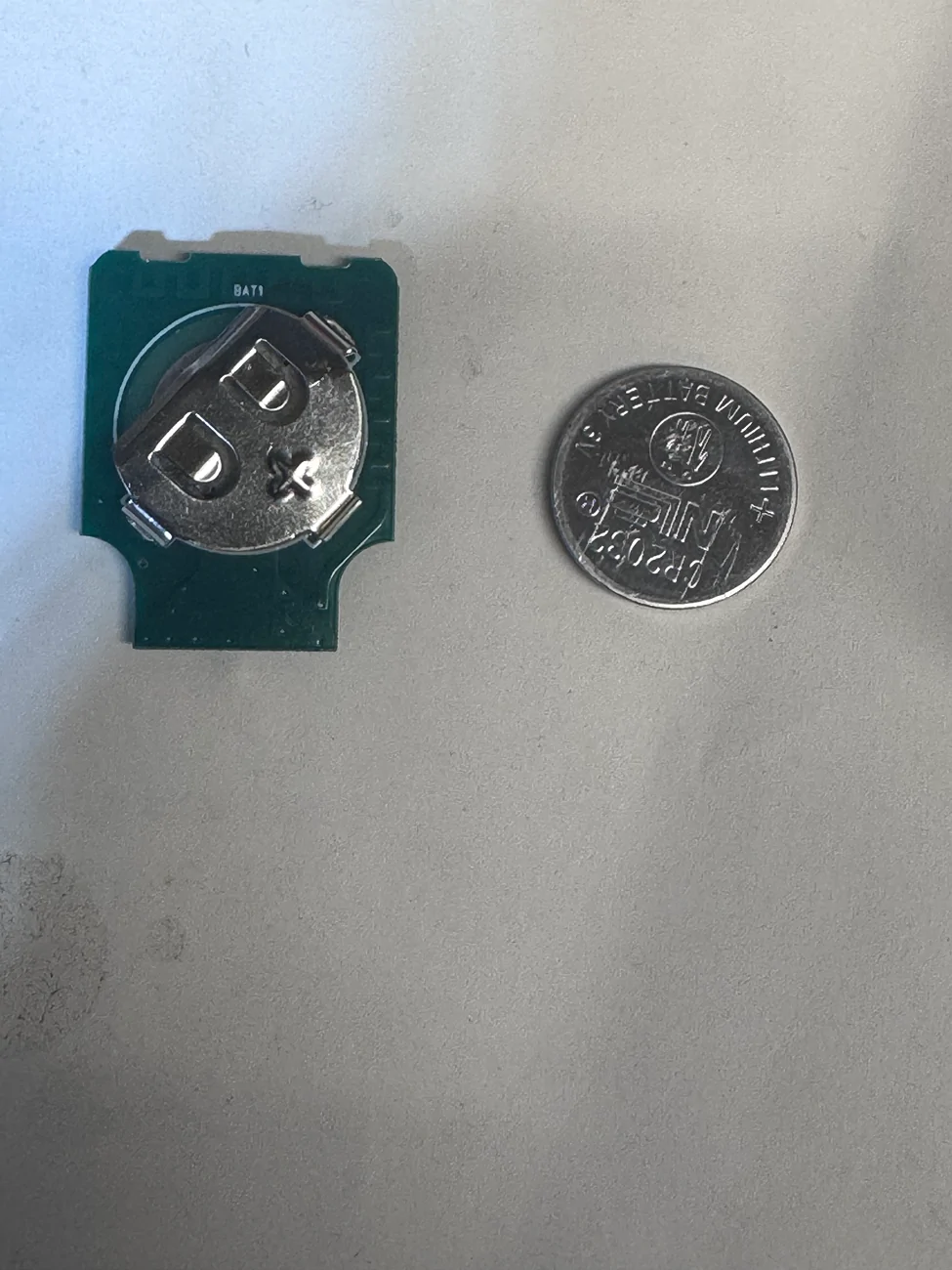

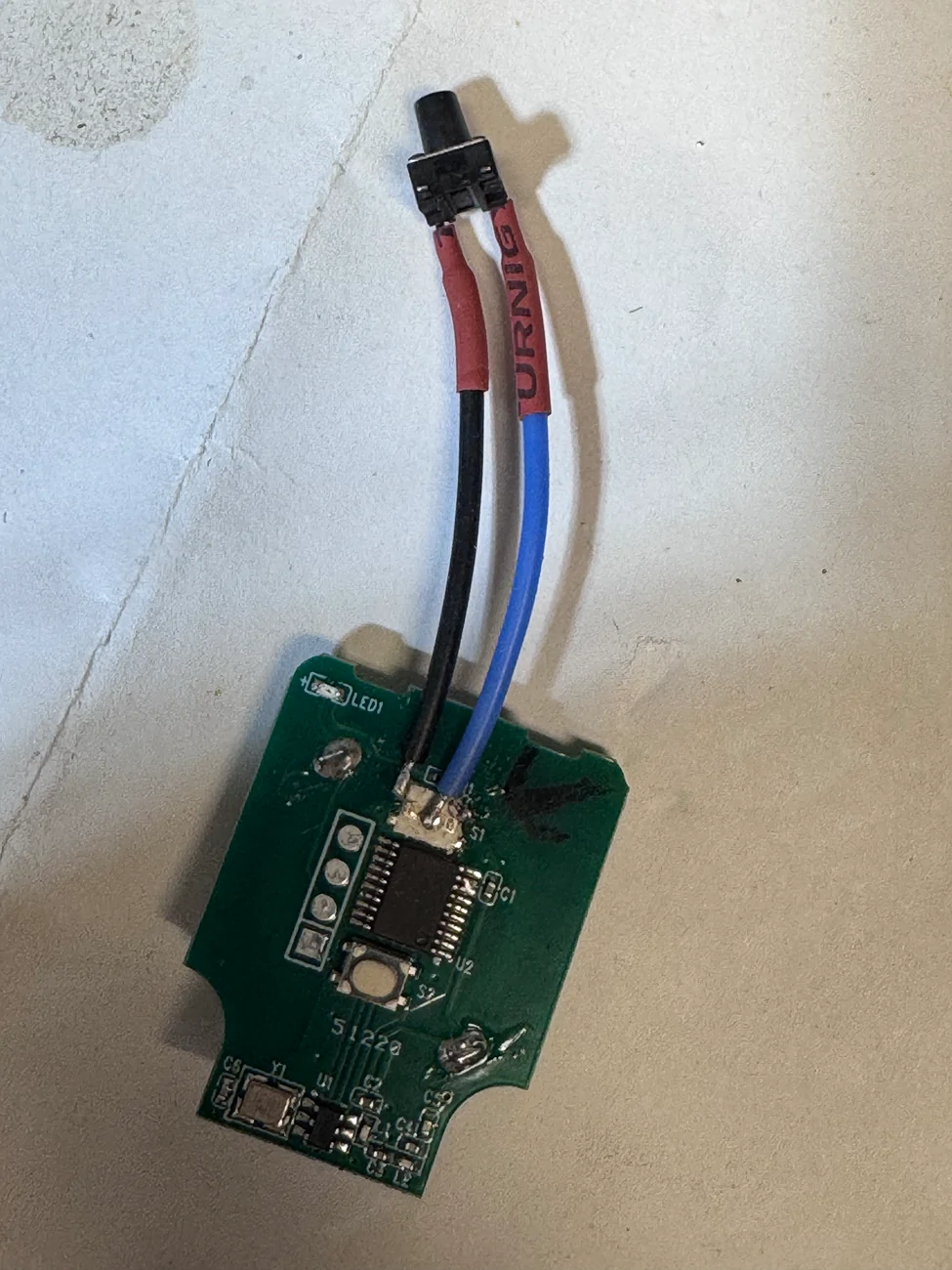

Here is what it looks like on the inside. This remote has two buttons, I only used one, but if you need a second for the gate or something - it can do that.
Tesla Cybertruck A Discrete Permanent Garage Door Remote install DIY tempImagefuc4ta
Tesla Cybertruck A Discrete Permanent Garage Door Remote install DIY tempImage7vYTe9

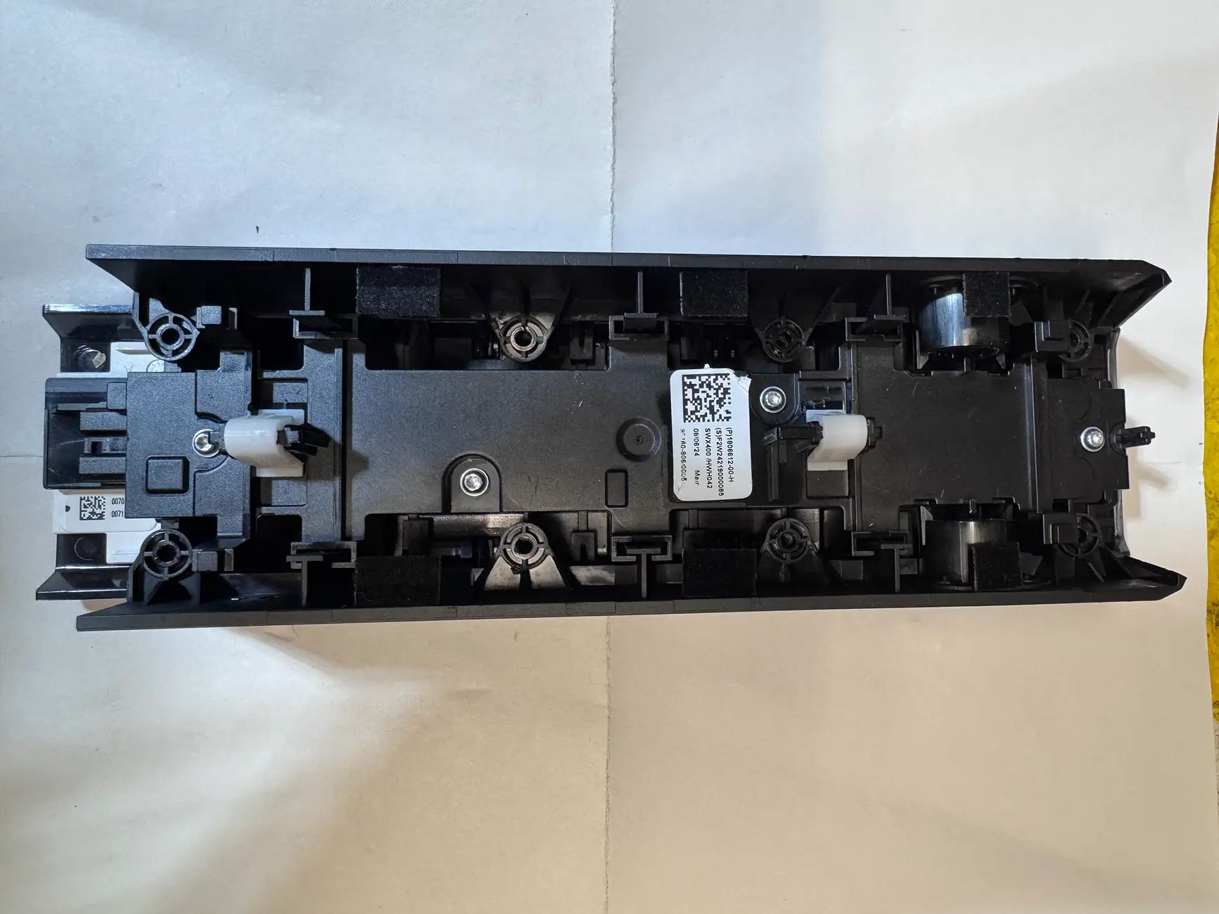

Her are the pics of the other side of the PRND console, the side screws are removed. to allow the side plastics to slide in and out, that helped me get an idea of where to place the chip.

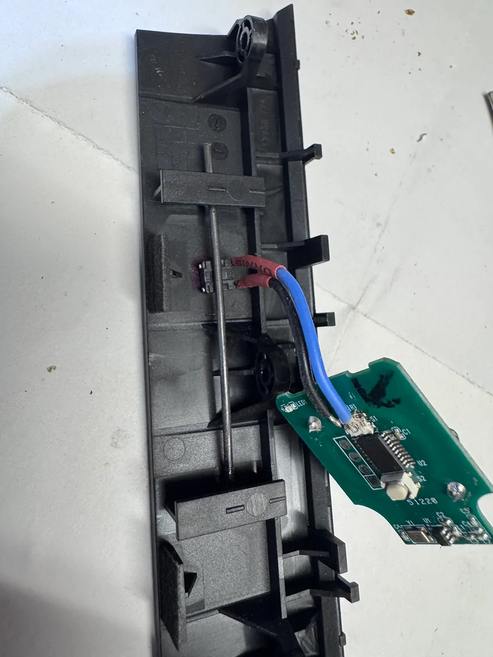

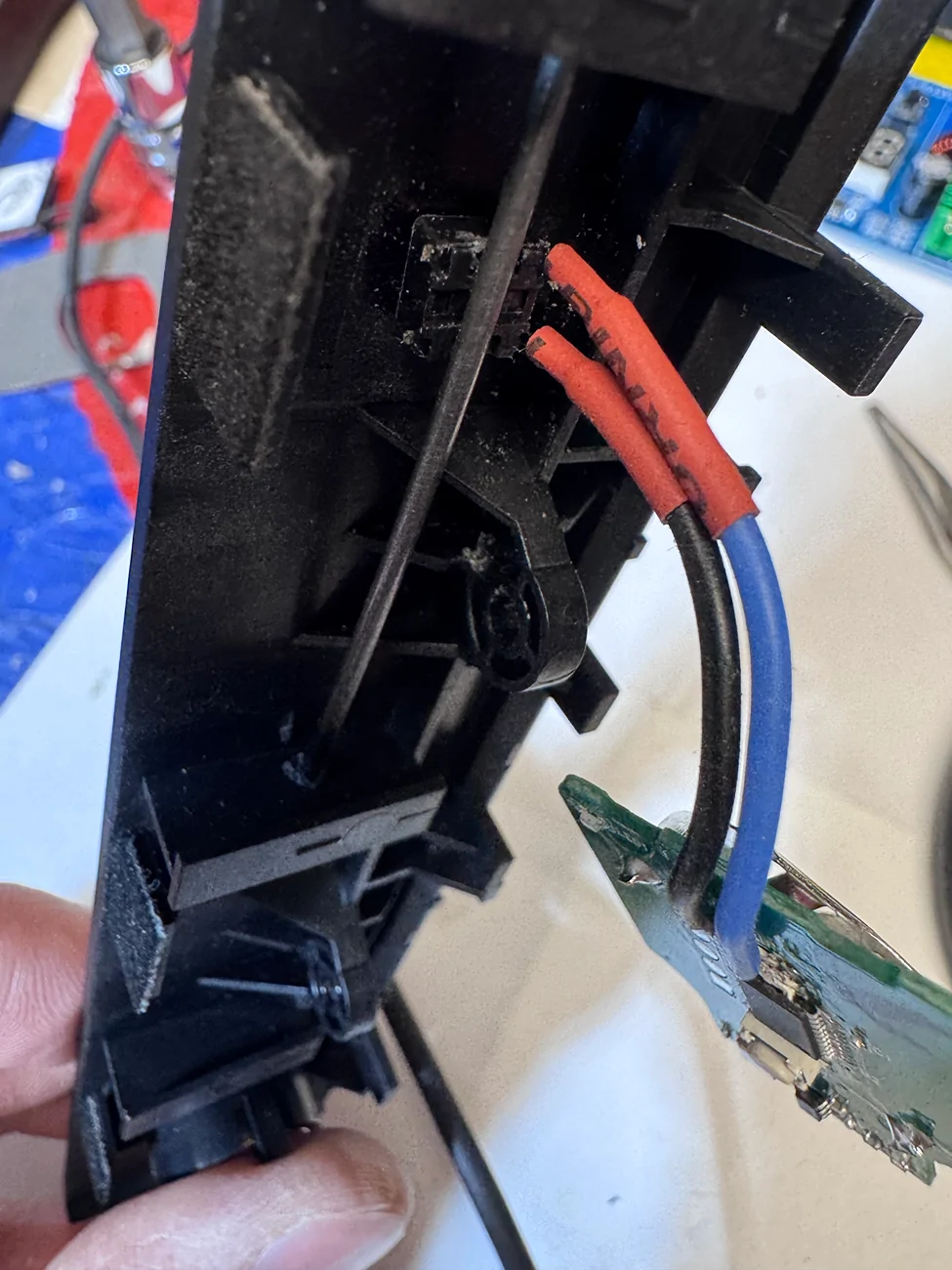

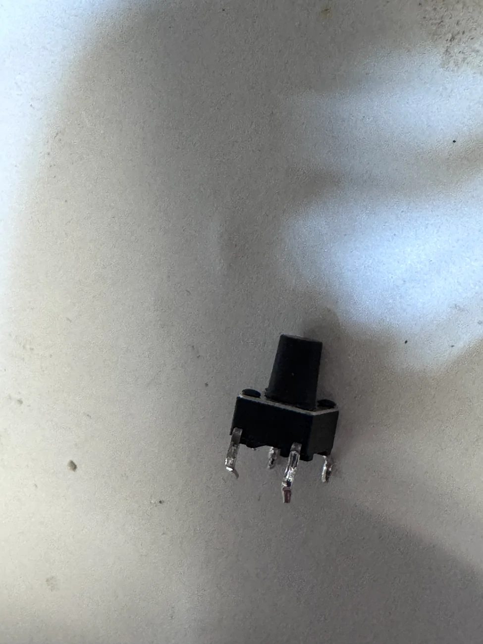

Right there is where I wanted to place the button. And here is the pic of the button. This button has a long push button thingy, long enough to pass through the plastic and protrude a few millimeters.
Tesla Cybertruck A Discrete Permanent Garage Door Remote install DIY tempImageWdOaAz
Tesla Cybertruck A Discrete Permanent Garage Door Remote install DIY tempImageeKNRu0

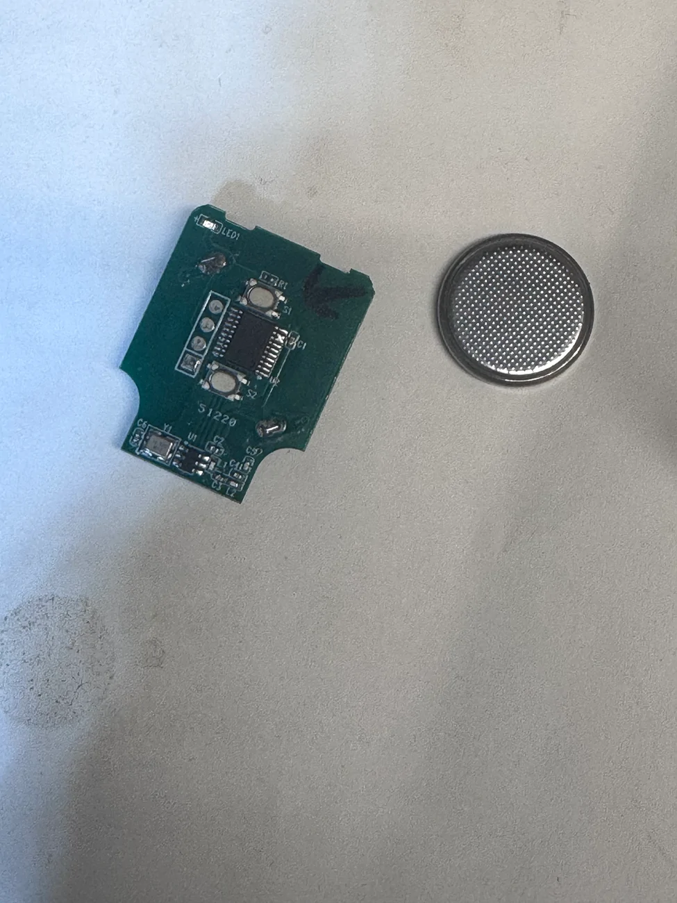

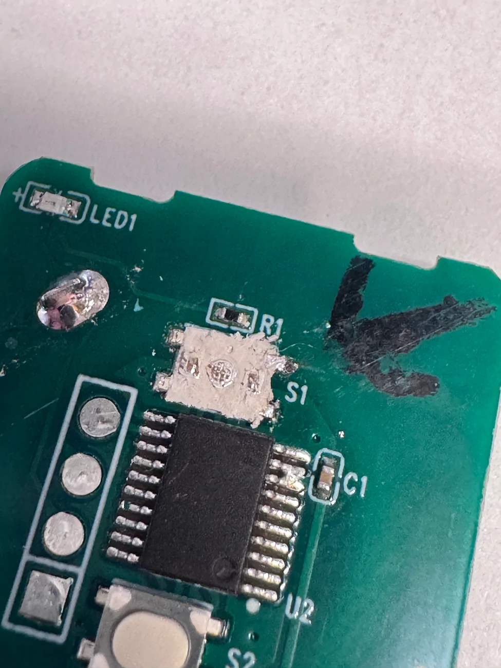

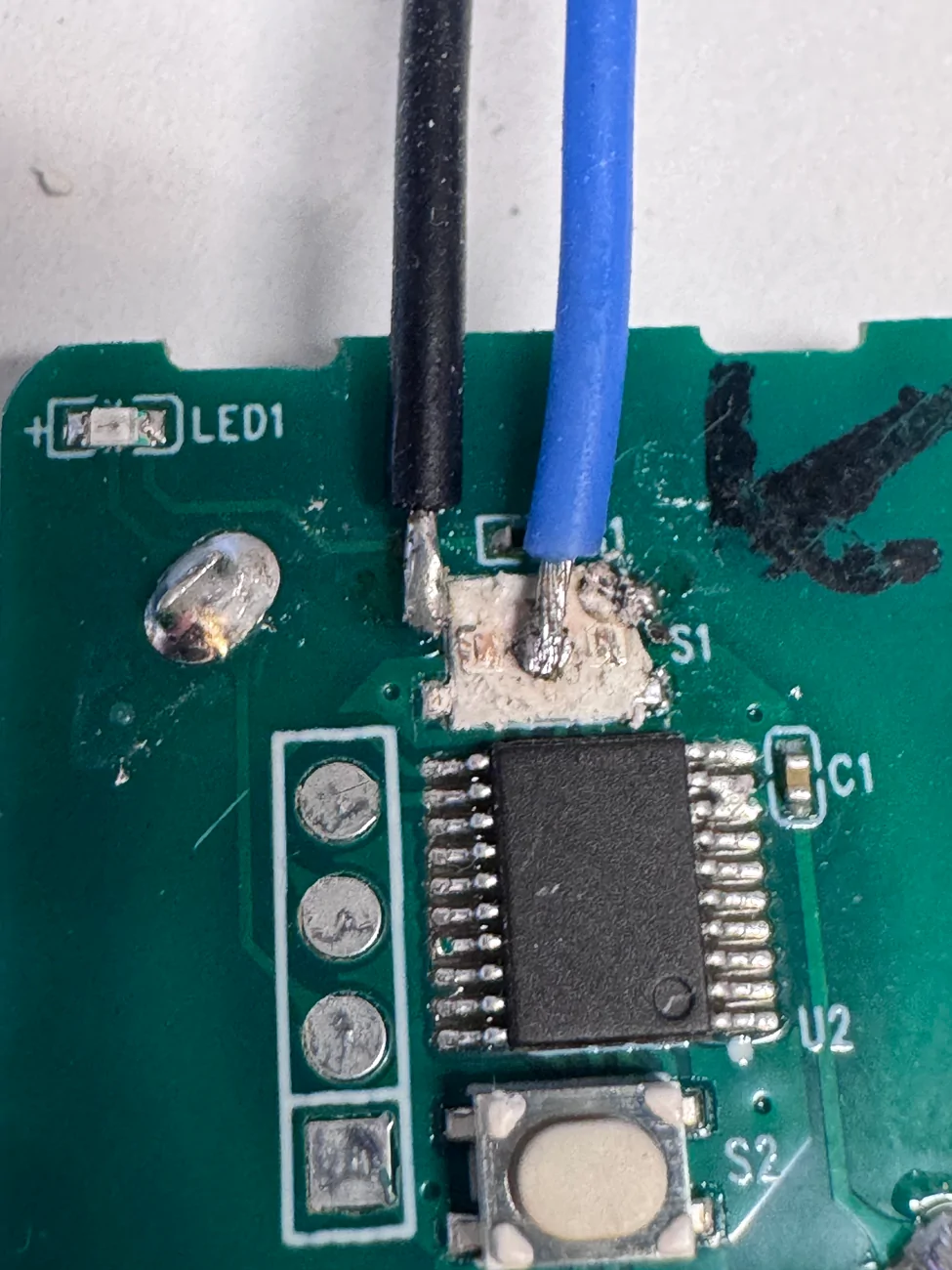

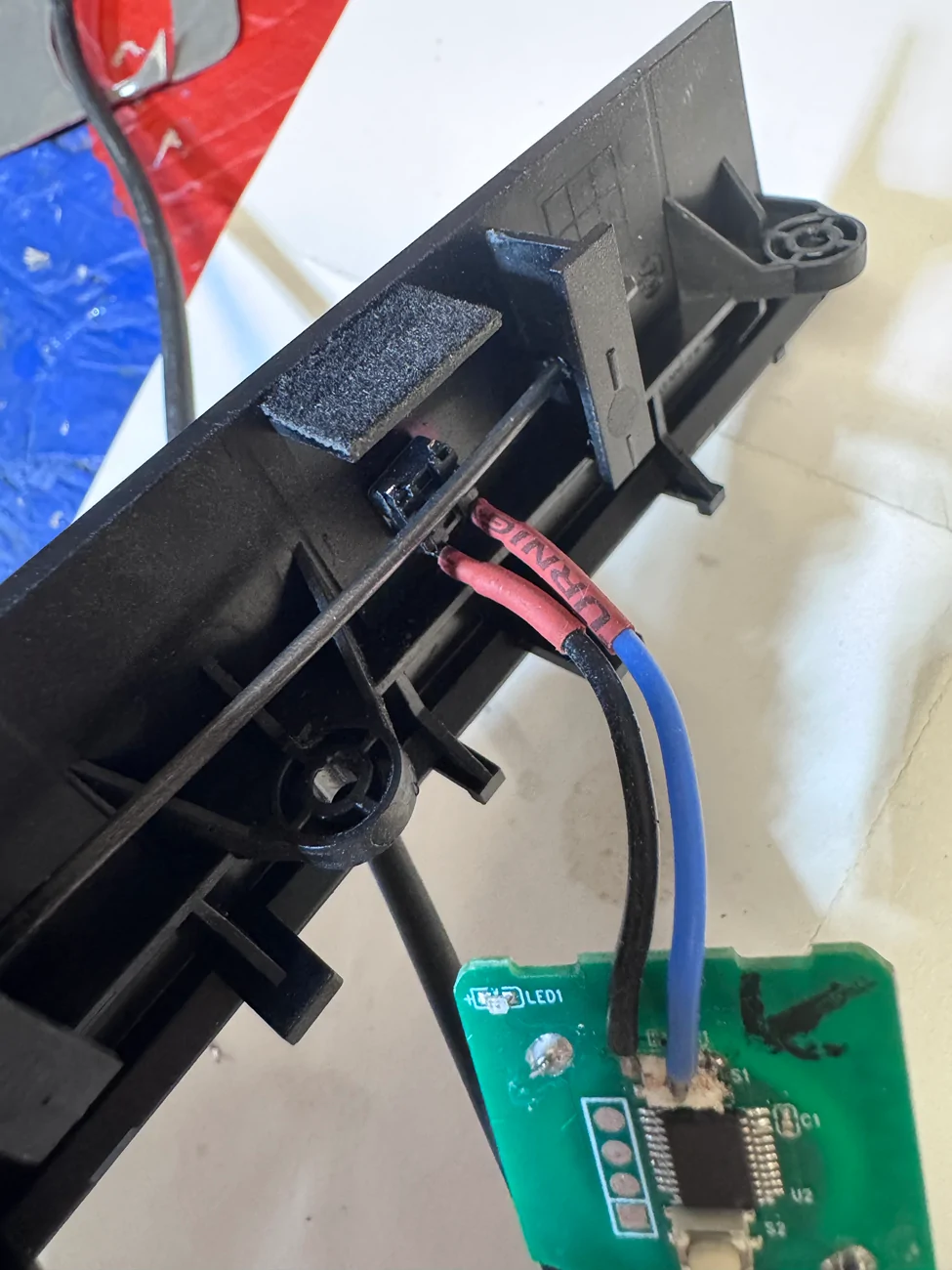

After destroying the OG push button, I have attached a couple of wires. It may not look pretty but it works and nothing is shorting and it is solid.

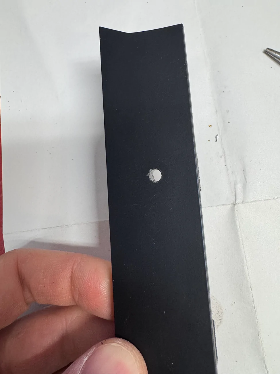

Obviously you need a hole. It's not that easy to make a super clean hole, but that’s my best. I think the hard part here is fixating the push button. I used a metal rod to press it against the plastic. It was heated and just pushed through the plastic. It's solid and does not move.

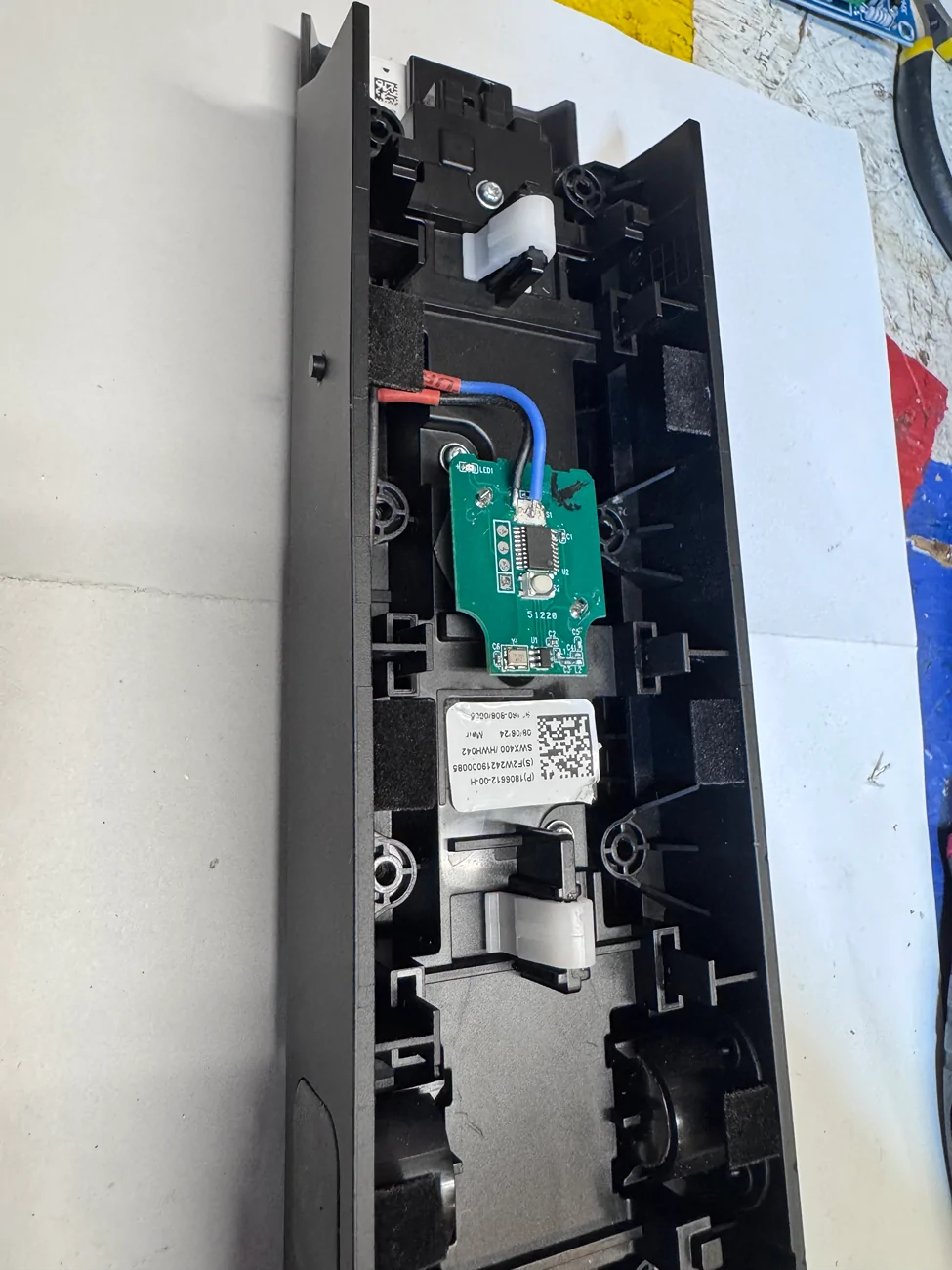

Double sided tape to glue the chip and put the rest back together. The position is also important, that’s the only spot it will clear.

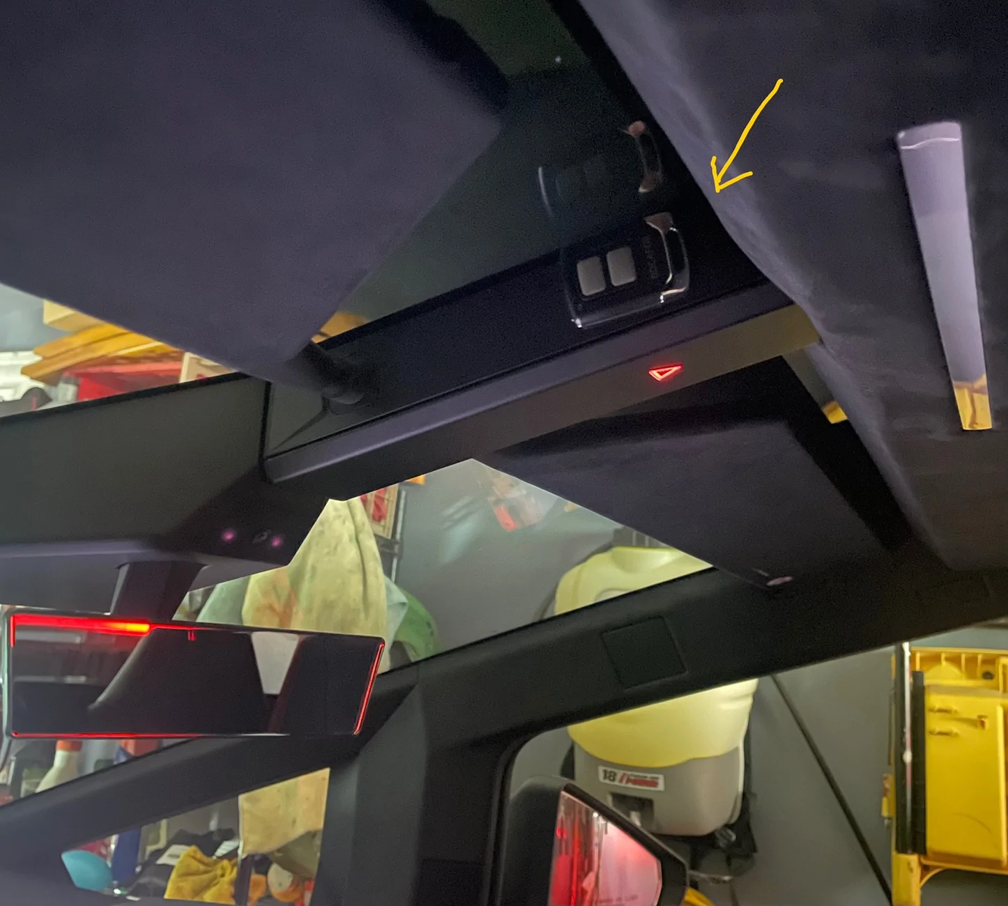

This is what it looks like in the car. I did have to remove a couple of tabs that hold the console but it is still sturdy. You can barely see it, fully functional.

I wonder if that set of square pad and three round pads is for allowing the buttons to be located remotely?

Kudos for having the will and the means to make this happen. It’s way more effort than I’m willing to put into something that Tesla should’ve given us from the factory on $120,000 car.
My bitterness aside, one question where it’s positioned it seems like it would be pretty easy to activate the hazards as you reach around to open the garage. It seems like anytime I go near the center stack I somehow activate the hazards. What’s your experience been on that front?

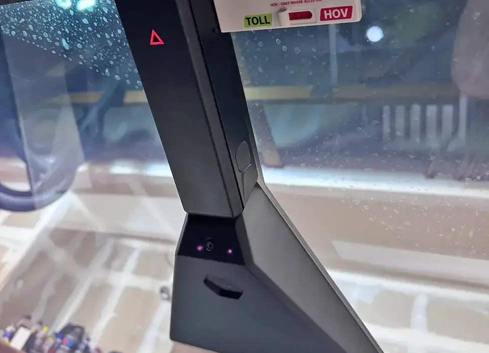

Cool mod! I’ve been using the same remote in my truck for about 1.5 years. I keep it in a tray behind the front screen.
I had the idea to mount the electronics in the small recess where the rear view mirror is attached but it is too big to fit. I didn’t think about soldering in a remote switch. Maybe I’ll tackle this in the future. Nice work!

I agree this should’ve been a thing from the factory!
And yeah the hazard button is pretty sensitive but I haven’t had an issue with it.
