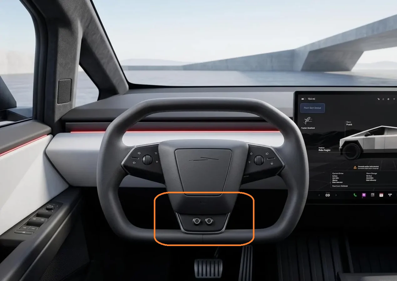

Very cool work. Here is a packaged version of something discrete (https://www.etsy.com/listing/4493607463/tesla-cybertruck-integrated-garage-door)
Tesla Cybertruck A Discrete Permanent Garage Door Remote install DIY 1777317450824-k

Looking at it I think that sticks out a ways past the back of the steering wheel, would be afraid it would snag getting in and out or on knees.
I'll let you know, I bought it today.. Can't have too many sollutions I say :)
Cool, I have a big square garage door opening 2 sided taped up high near manual shifter, it isn't bad but if that solution is as good as it looks in the pics it MIGHT be good enough to waste $50 on for a little extra vanity :)
