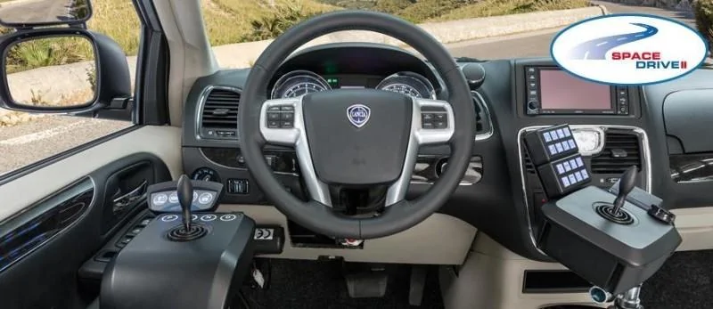

For many years there has been 3rd party options for controls including joysticks & foot steering.
Paravan SpaceDrive on Chevrolet Silverado
Paravan SpaceDrive installation done by In Motion Mobility on a modified Chevrolet Silverado.

Space Drive is a system that is unrivalled in the world - a real breakthrough. It allows persons with low residual strength, a large girth, minimum movement and even those without limbs to safely drive a car. With Space Drive you activate the brake, accelerator and steering wheel (and of course all the other functions) using driving aids controlled by microprocessors. These transmit the signals in nanoseconds to two servo motors for the brake and accelerator and two others for the steering ("Drive by Wire"). We configure the single modules individually. We readjust the software and hardware on-site if your clinical picture changes.

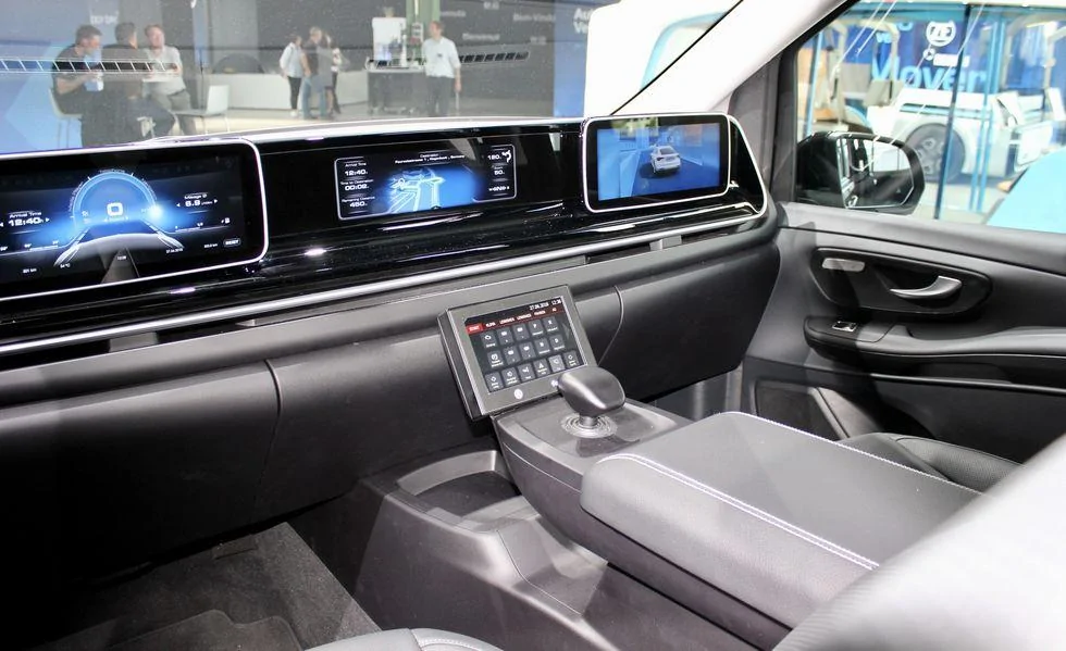

ZF and Faurecia Debut Joystick-Controlled Cockpit
This Car Cockpit of the Future Features Joystick Control and No Pedals Intended for automated cars, it allows manual control to remain an option.
Published: Jul 6, 2018
By Matthew Askari
https://www.caranddriver.com/news/a...ture-features-joystick-control-and-no-pedals/
ZF has the largest portfolio of by-wire technologies in the industry.
X-by-Wire: When the Electronics Take Sole Control
Electronics control the brakes, steering and other systems in the car – with no mechanical connection to the driver
https://www.zf.com/mobile/en/technologies/vehicle_motion_control/stories/x-by-wire.html
Soon, electronic control pulses plus actuators will be the only things moving steering systems and brakes, i.e., by wire. While the steering wheel and brake pedal will still exist, they will function like a joystick, i.e., control units the driver simply uses to trigger the electronic pulses.

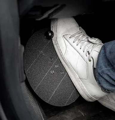

Foot-operated Steering Wheel This adaptation lets you use your feet to steer the car. In short, the steering wheel function moves down to a turntable at the same level as the pedals. Terminology: A foot-operated steering wheel is also known as a foot steerer.

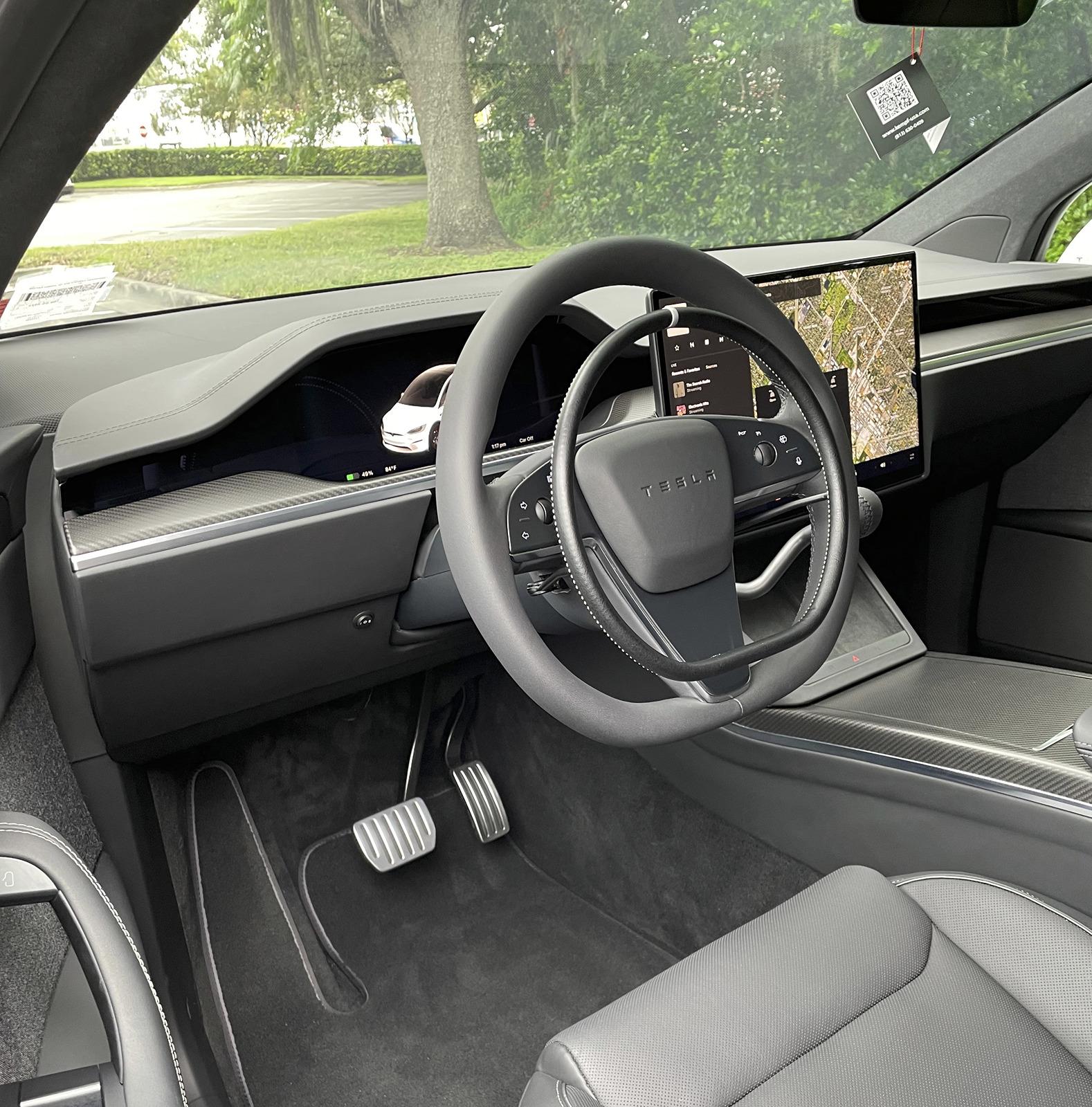

The company I work for(Kempf) makes amazing hand controls for vehicles(Tesla included). It allows you to drive with both hands on the steering wheel and still offers the same amazing features that Tesla is know for!
Tesla Cybertruck A tesla for the handicapped with hand brake and accelerator Tesla-X-no-yoke-1
