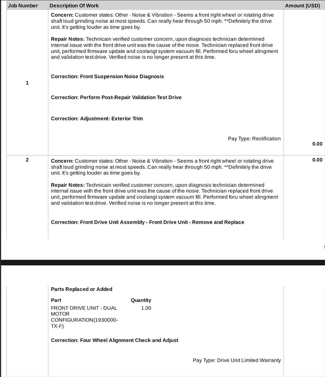

Can you share service notes from the front drive unit replacement? I’m having this issue and they won’t replace mine. Looking for example so they can see notes and fix mine.
You bet. Let me see if this attaches.

Thank you for this and I also received your message regarding link linking up in Austin!
If they can fix it, I owe you lunch. :)
