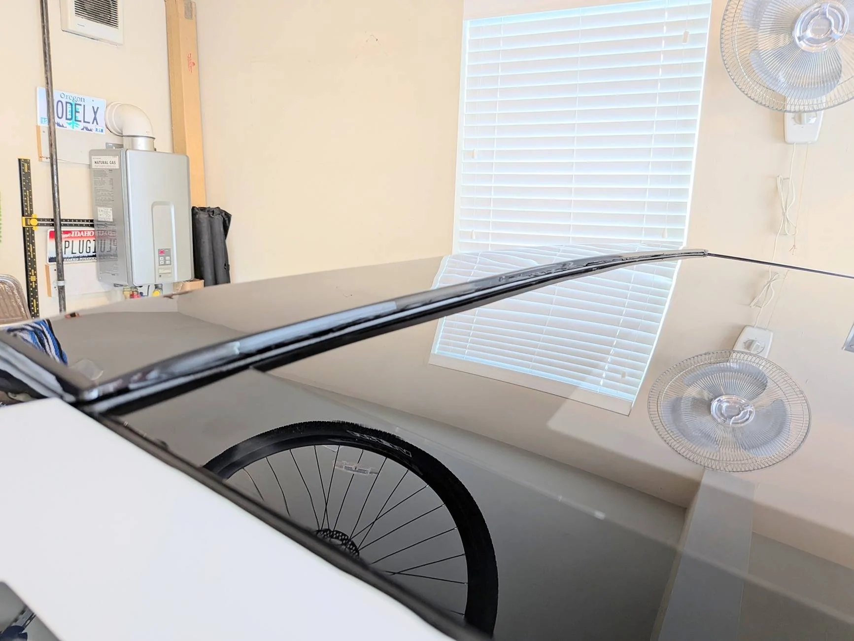

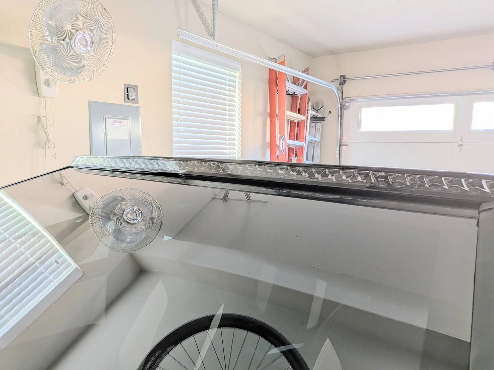

I got my light bar installed today but I'm not happy with the caulking job done by the service center. The bead on the front isn't even even and on the back, there is a huge gap. I'd like to fill it with some black RTV but I want it to look good. If I just buy a tube and squirt it in and smooth it with my finger, I'm afraid it won't turn out. I'd be willing to buy a caulking tool if folks can recommend one and I can do a couple practice runs to get the hang of it before I go to town on my truck.
