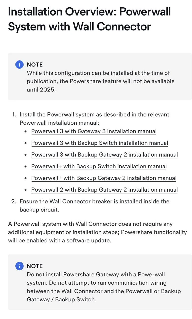

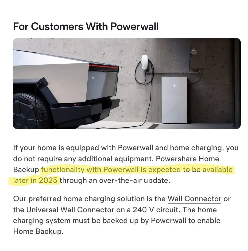

Yeah so this is what I am trying to figure out. There doesn't seem to be any official statement on adding a powerwall onto a Gateway 3V... I think the installer said they just let the Powerwall 3 operate in standalone mode but that doesn't make sense to me.
Tesla officially disallows using V3 with Powerwall and it is in writing.
kchau
Aug 22, 2024
36
PNW
CT, X
IIRC, Tesla's old guidance was that going from Powershare only to + Powerwall would require additional effort to commission. That seems to have changed to gotta swap Gateways.
Do we know when this changed? Was it April of this year?
