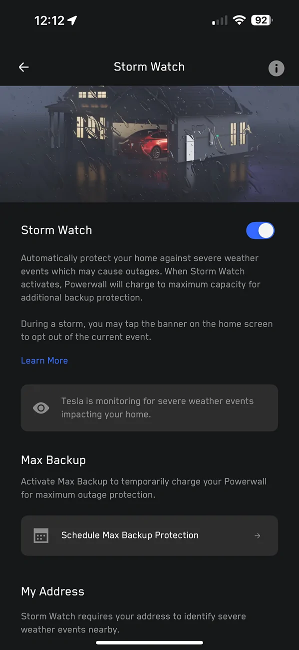

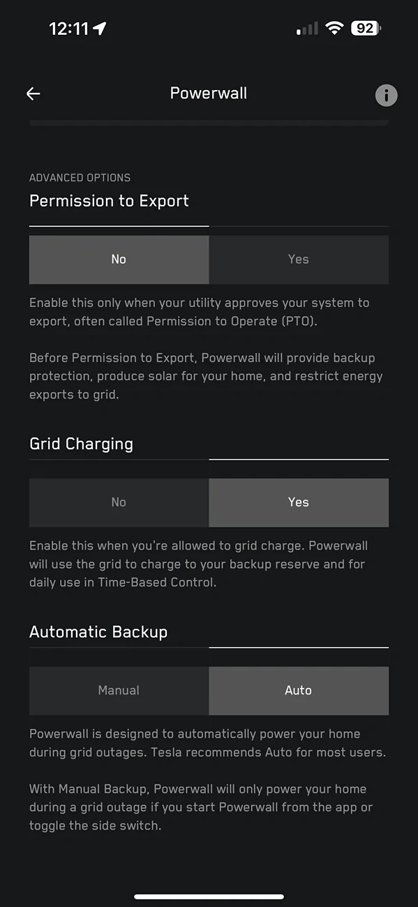

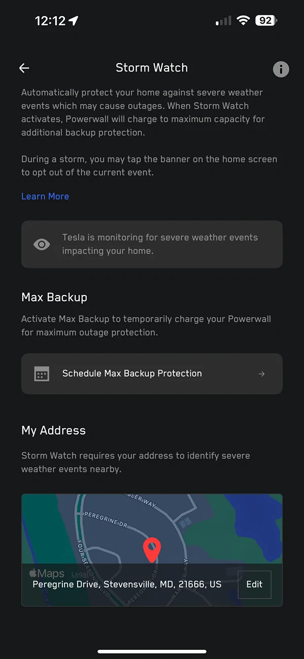

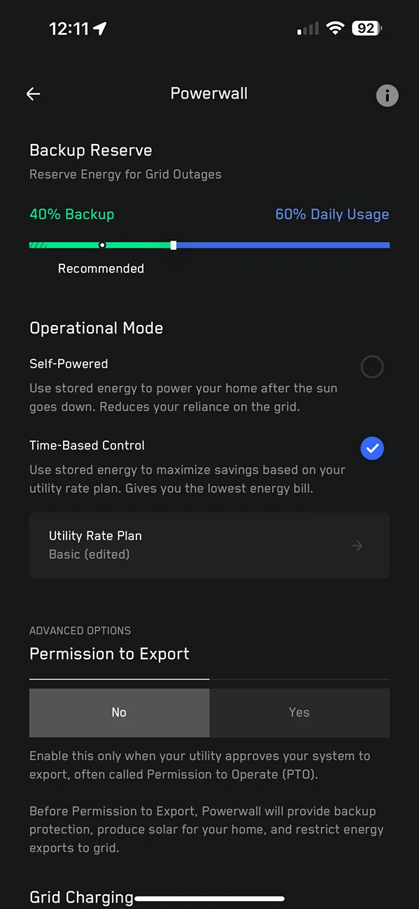

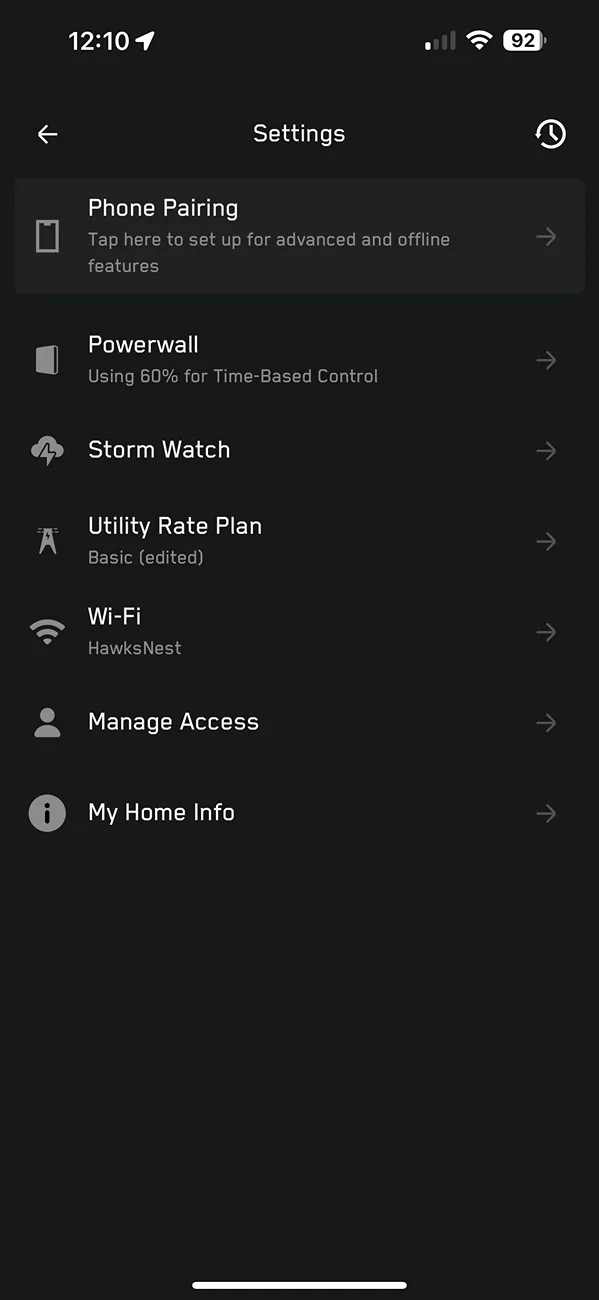

My system is operating but I don’t yet have permission to export power. That should come this week. Meanwhile here are a few screens that just came up.
Tesla Cybertruck Adding Solar and Powerwall to Powershare Gateway 3V IMG_5375
Tesla Cybertruck Adding Solar and Powerwall to Powershare Gateway 3V IMG_5377
Tesla Cybertruck Adding Solar and Powerwall to Powershare Gateway 3V IMG_5378
Tesla Cybertruck Adding Solar and Powerwall to Powershare Gateway 3V IMG_5379

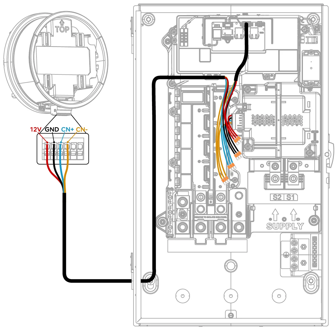

So you're telling me you can't disconnect and unpower the gateway 3v TACO, and replace the CN+/CN-/+12v/Gnd connections to the isolation switch with the powerwall 3?

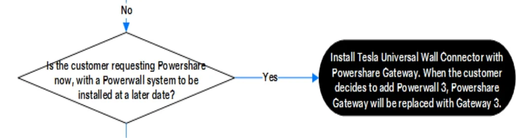

I think the issue might be that the neutral forming transformer is only in circuit while in backup mode. That may involve a different model isolation switch which isn't cross compatible. As seen in the Powershare plus Backup Switch installation, the Gateway switch is still used:
Tesla Cybertruck Adding Solar and Powerwall to Powershare Gateway 3V GUID-27DE78C1-6916-4F7A-B9EB-993489864437-online-en-US
Installation flowchart:
Tesla Cybertruck Adding Solar and Powerwall to Powershare Gateway 3V SmartSelect_20250804_064918_Firefox
https://energylibrary.tesla.com/doc...UID-04DE7F20-2290-4489-A9A1-53F639BB85CB.html

Yes there is, I posted it with the link.
Powerwall cannot use 3V (Powershare Gateway), only Gateway 3.

Right, so what is this with the installer just letting the Powerwall operate in standalone mode, without any communication wires?
May 27, 2024
4,592
5,573
That's not a thing AFAIK. Powerwall needs to connect to a Gateway or Backup Switch. Powerwall without solar is sometimes called standalone?
You might be able to stack grid -> Powershare GW-> Powerwall GW -> house, but why...
