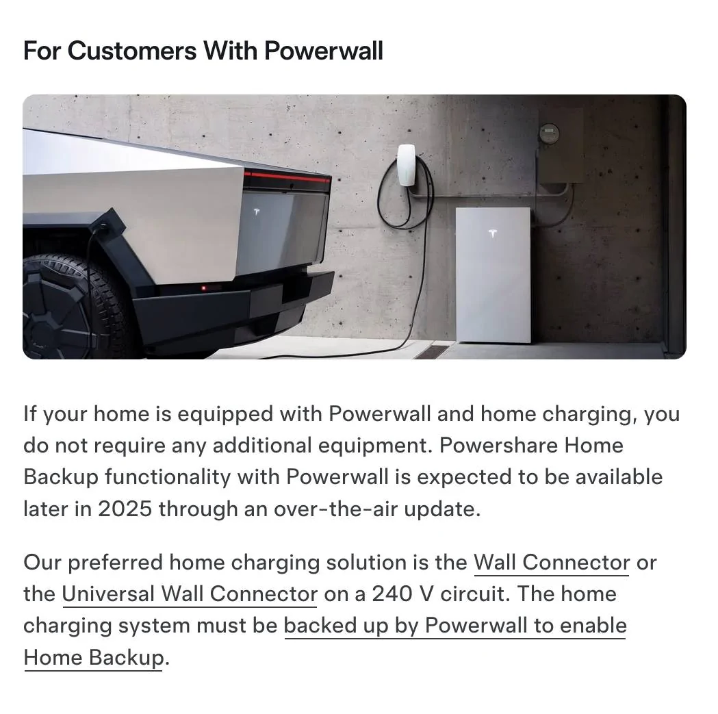

Any wall connector on downstream (backed up) side of Powerwall Gateway will work. Once Tesla releases the software.
There is no communication wiring from the UWC in that setup, nor is a UWC required.
https://www.tesla.com/support/powershare
Tesla Cybertruck Adding Solar and Powerwall to Powershare Gateway 3V SmartSelect_20250531_065043_Firefox
