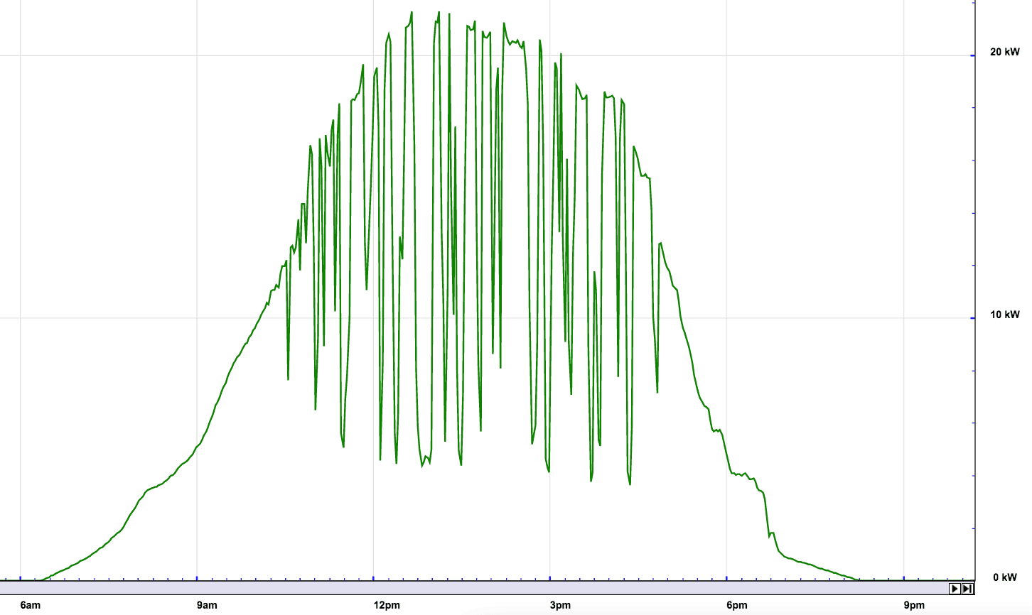

Mostly, no. I have never seen a backup generator at a SC station but I believe some do have them.
You have to have batteries in a solar system to "even" the load.
That depends on how big the batteries are and that depends on how many sunless days the system designers planned to cover and that in turn depends on the anticipated load at the station. If a stall services 12 cars per day and the average charge is 50 kWh then the batteries would have to be 600 kWh to cover a day and the solar 150 kW or so
In case of a prolonged power outage such as Puerto RIco a couple of years back I think BEV drivers are, in general, going to be SOL unless they have a PV system which, unlike most sold to homeowners, does not rely on the utility for its clock.
The problem with a lot of PV inverters now is that they shut off during a power outage so as to not back feed the grid and cause harm.
... SOL unless they have a PV system which, unlike most sold to homeowners, does not rely on the utility for its clock.
The problem isn't the inverters. It's the system they are installed in. Most houses put panels on the roof with microinverters or put them in strings connected to a larger inverter either of which receives its clock from the utility. Utility goes down, clock is lost, inverter shuts down just as it is supposed to. No solar. If the consumer wants solar during a power outage he must install a more complex system an example of which would be a Powerwall. The Powerwall senses loss of the utility, disconnects the premises from the utility and then supplies the clock the inverters need. The loads are then supplied by the PV and, when the sun goes down, the battery in the PW.
In the original context of this thread these anti-islanding features make it very difficult to put together what I consider to be the ultimate system: one that combines solar, generator and battery that is one in which when the utility goes down solar takes over as long as the sun is up after which the battery takes over until it is run down at which point the generator comes online. Powerwalls can be configured to run with solar and utility or with solar and generator but not, AFAIK, with both.
