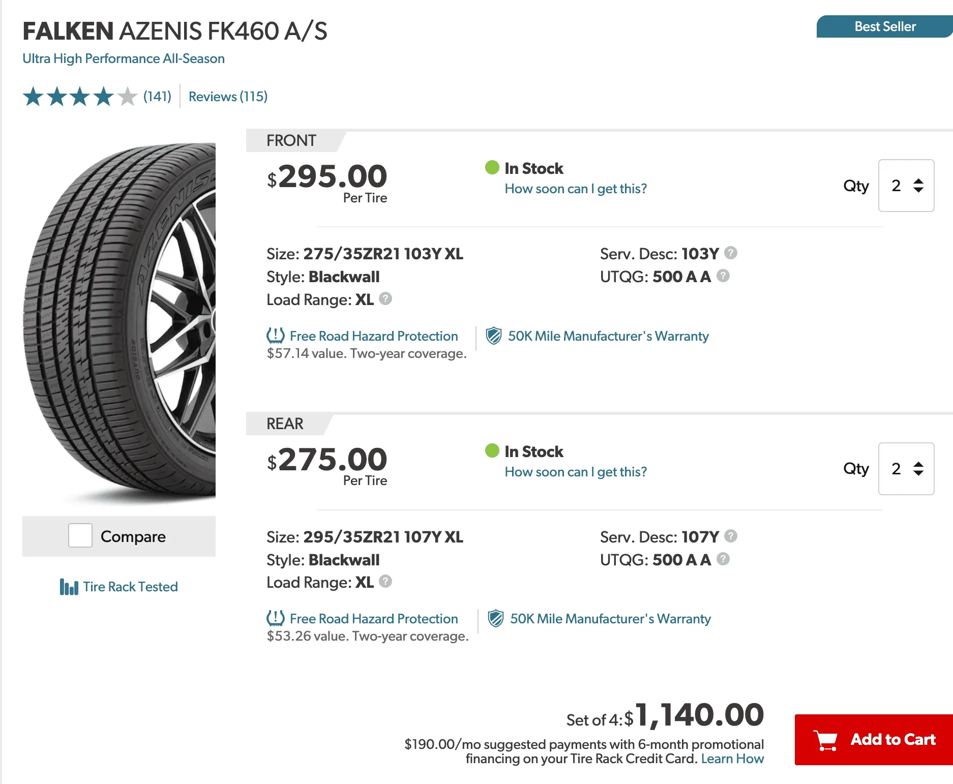

So I've decided to go wider for the better ride and rim protection, just All Seasons vs Summer is the open question.
Here are the Falken's, still figuring out the exact Pirelli's.
