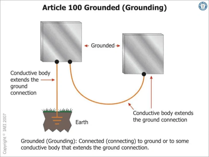

With this plug in place you have fooled the vehicle into thinking it is grounded. It isn't, of course,
By tying (bonding) neutral to the generators ground, you are grounding it.
To ground doesn’t have to mean connecting to dirt.
What you should do to be safe is properly ground it. To do this you would moisten a patch of ground, drive a ground rod into it an then tie that to the generator's frame via the lug provided for that purpose.
There is no reason to connect a portable generator to a rod driven into the dirt. Check with your generator documentation for verification.
Clearly you don't understand anything about electricity. As such I would ask you to refrain from posting about it. The reason I making this request in this instance is because misinforming people about grounding has safety implications.
No need. I know what grounding means, what it is for and how it works. You have made it plain you don't. If concern for others safety isn't enough to make you mute yourself on this subject perhaps the fact that you are advertizing yourself a fool is.
I feel like we’ve been over this.
If we have been you didn't learn from last time.
Here's my offer. Edit your post to remove it and I'll remove this one. Or perhaps an Administrator could just remove both. I am reporting your post as potentially dangerous.

For complete safety, the car should be grounded (earthed) to the point that code requires that charging circuits must detect that ground (connection to the earth). If you operate the car from a generator that is not grounded then you do not have that protection though as discussed it is a simple matter to fool the car into charging.
Any generator should be earthed. A generator that is not earthed will not pass inspection. But we all know that most campers do not earth their generators, Most probably do not realize that they are exposing themselves to risk or if they do think it small enough that they need not worry. If using a generator in the field to charge your BEV (or for anything else) you should ground/earth it. Whether you choose to do so or not is your decision.

Please explain exactly what is unsafe about using a portable generator without connecting it to the dirt.
It isn't earthed.
....OSHA if I remember correctly. Those agencies specifically stated you do not have to use a ground rod into the earth.
Nobody said you have to properly ground your system. If you are willing to accept the risk of charging an unearthed vehicle we have discussed above how to do it. We note that the various levels of government will not allow you to accept that risk at home or at a DC fast charger and look forward to seeing the OSHA documentation that says it's OK in the field.
Your understanding of electrical safety is clearly lacking. I don't believe you even understand what "grounding" really means means. There are lots of people on here whose knowledge is similarly inadequate. They may think you know what you are talking about. While I'm not going to lie awake worrying about it someone who accepts your ignorance could get hurt.

It isn't earthed
I was hoping you had a clue about electricity, specifically grounding. Obviously you don’t. If you did your answer might have had some meaning. Saying it’s unsafe because it’s unearthed would be like if you said it must be blue to be safe and I asked why and you replied because it isn’t blue.

People who understand electricity appreciate that a safe installation requires that any exposed conductive part of an electrical apparatus be earthed. There is an organization called the National Fire Protection Association and they publish a code called the National Electrical Code which goes into this at great length. Electrical practice in most of the world adheres to NEC or similar standards. Thus to people who use electricity the statement "It isn't safe because it isn't earthed" requires no explanation.
May I suggest https://en.wikipedia.org/wiki/Ground_(electricity)? Your misunderstanding of No. 23 is covered in the fifth paragraph but that's not the only reason I am pointing you to this article. I don't expect you will be able to understand much of it but perhaps you will grasp some.
