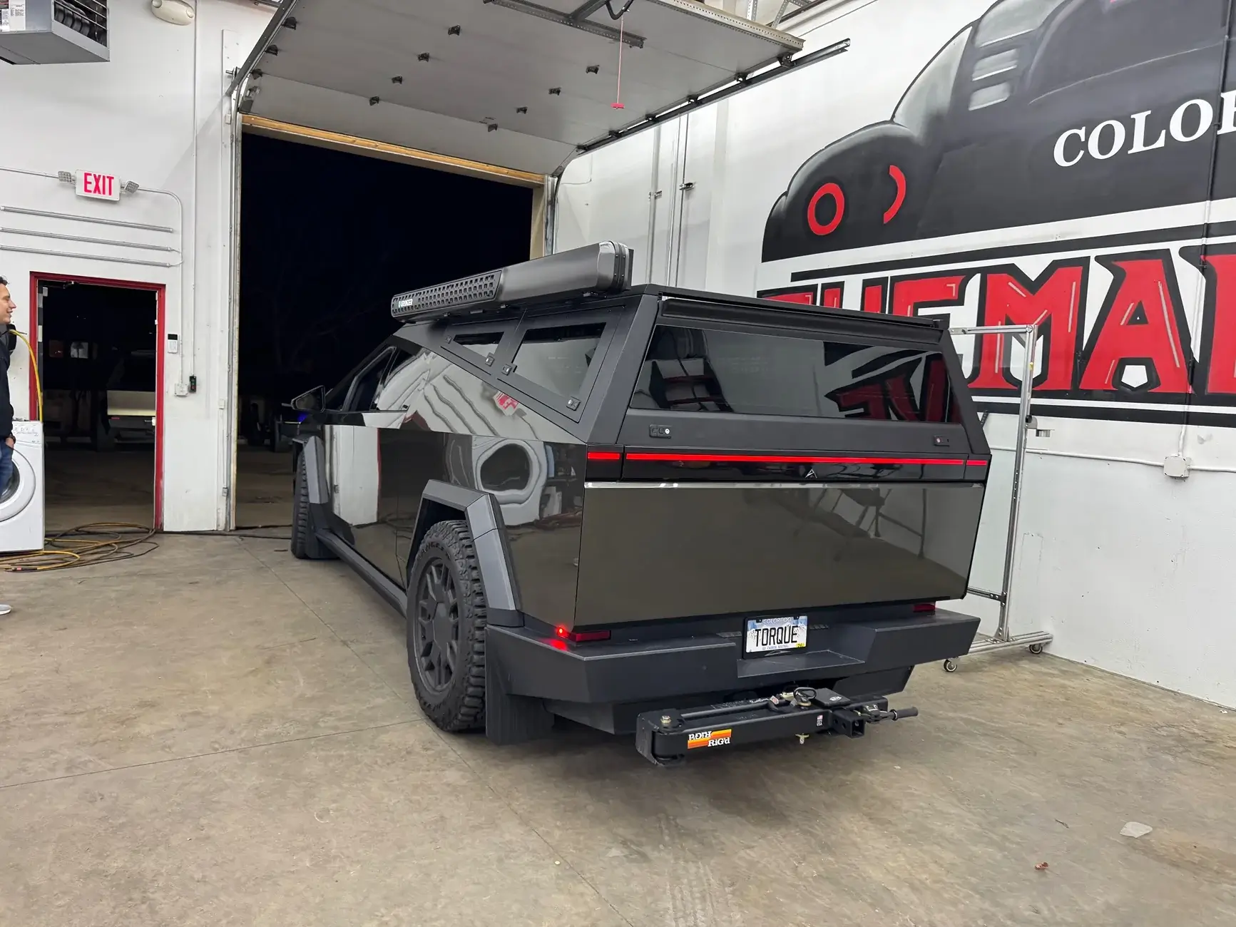

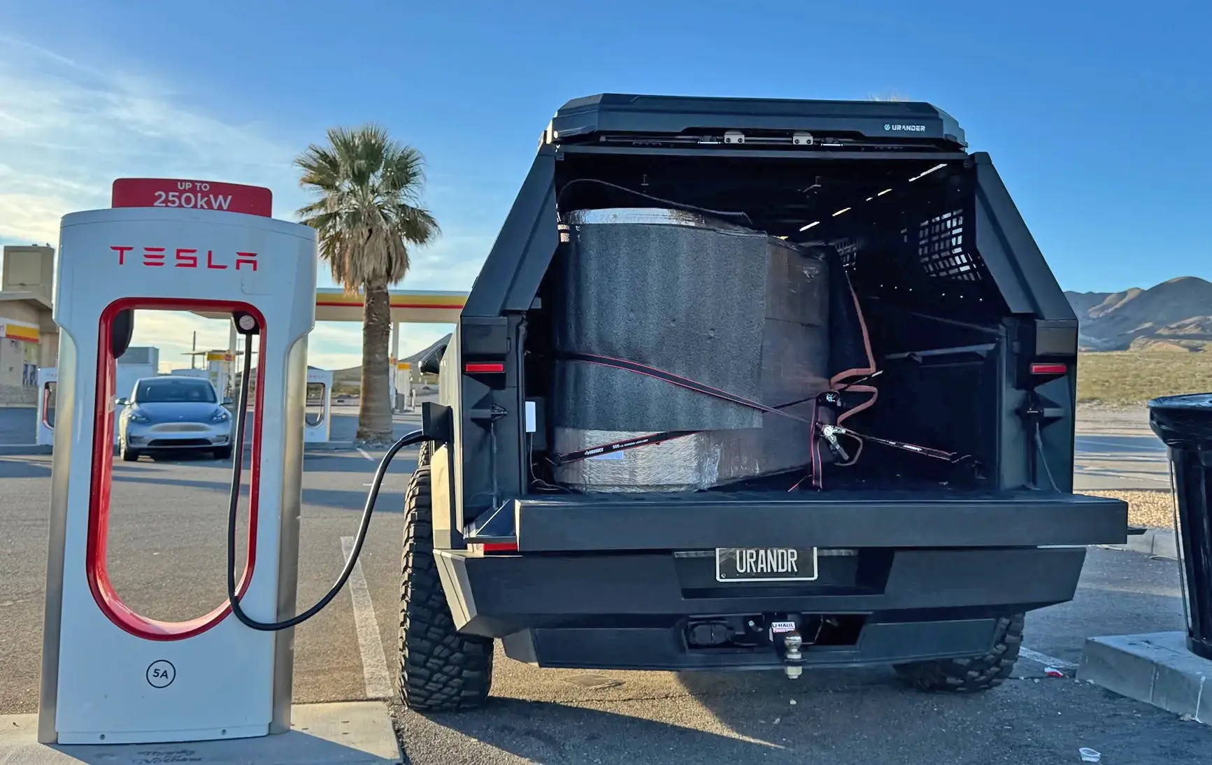

Adding some data to keep the thread going.
Our bed cap adds only 3 inches to the peak of the Cybertruck, with 8 crossbars hidden behind the wind deflector under that added height, keeping it sleek and efficient. Spacecamper adds 5 inches to the peak, and their crossbars sit at least 1 extra inch above the L-track without a wind deflector. Technically, our bed cap should be more efficient than the Spacecamper version.

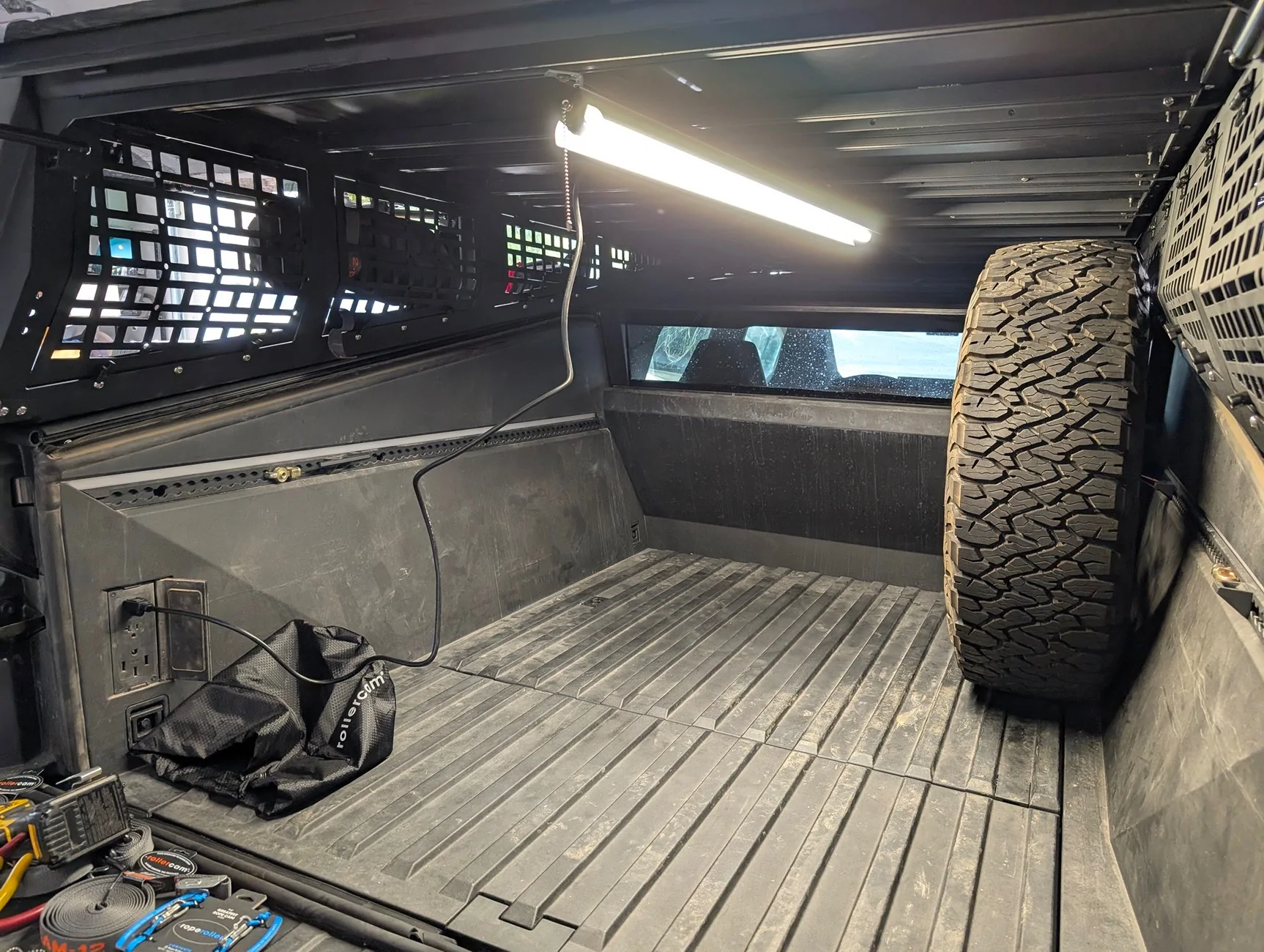

I have a roof camera and digital rearview. I’m just trusting autonomy more and more and it doesn’t make sense to me to take away one of its eyes. Have you heard of anyone attaching a spare to the OEM crossbars somehow? I was kind of thinking strap it to a molle panel or something.
is there a better approach than that?
Tesla Cybertruck Any bed cap vs. no cap range/efficiency data? IMG_2260

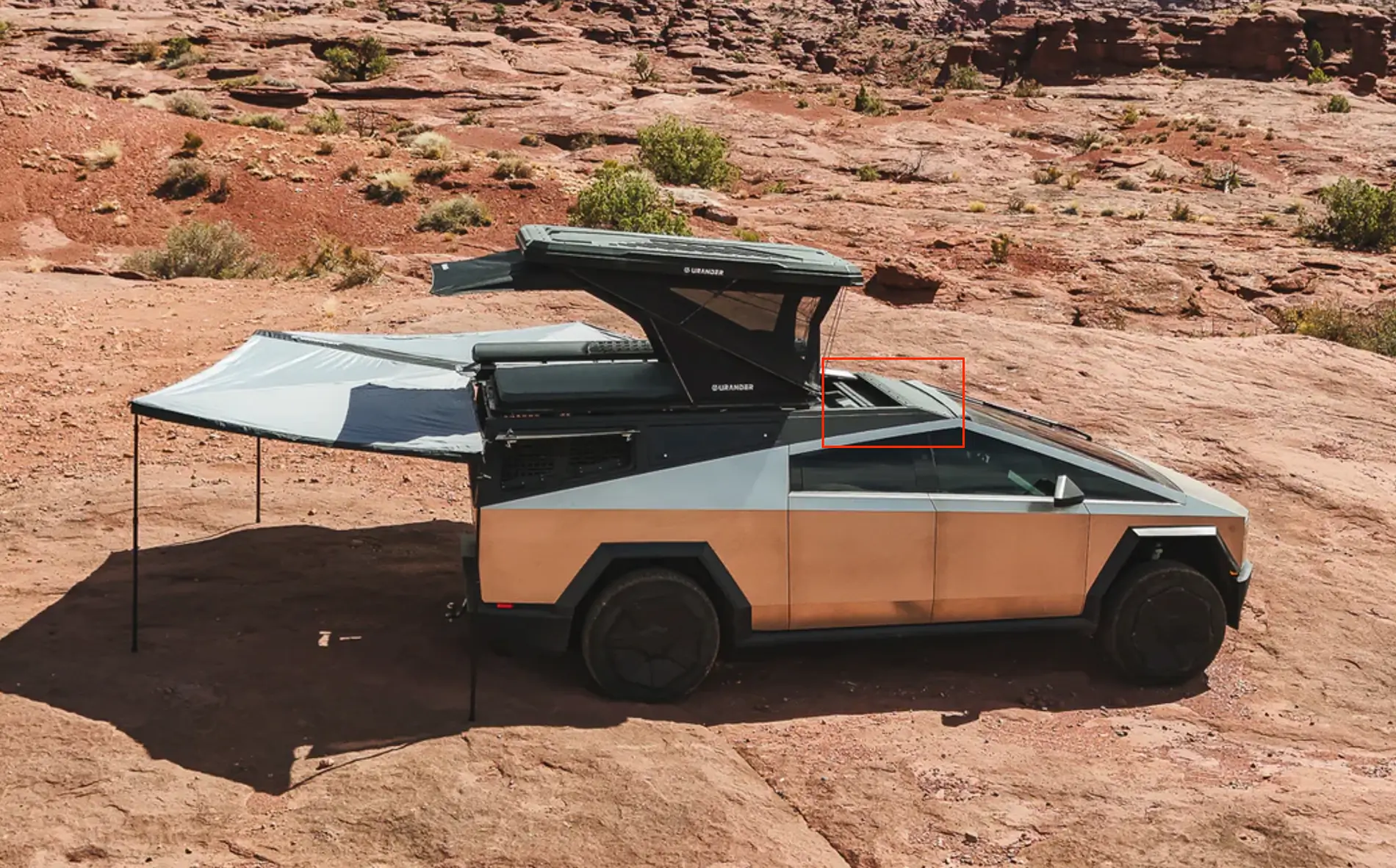

Our personal preference is to mount it vertically, which saves a lot more floor space compared to a horizontal setup.
One of our Gen 1 rack owners moved his camera to the top of the rack, though that can take a bit of extra work.

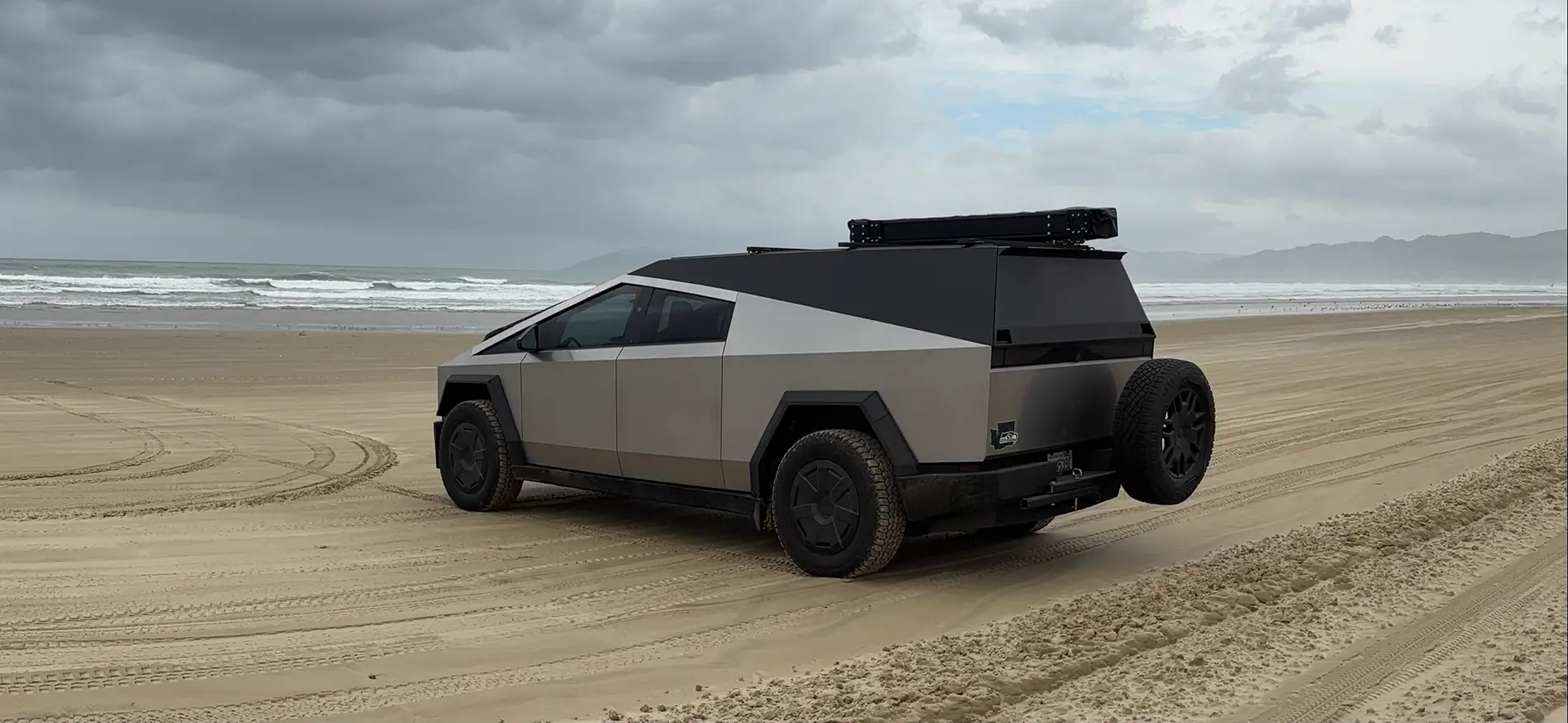

I would 100% still buy one of those if someone was wiling to make it for me. Just don’t have that skillset unfortunately.
Very very nice. How’s your FSD experience? Any issues?
It’s hard to say. 14.2.2.3 and 14.2.2.4 have been weird on CT, some annoying new behaviors. It knows it bings and bongs when in reverse, it can see the tire and doesn’t know what it is. I thought some of the lane change hesitancy could be from the tire, but I’m still experiencing it since removing the tire on 14.2.2.4.

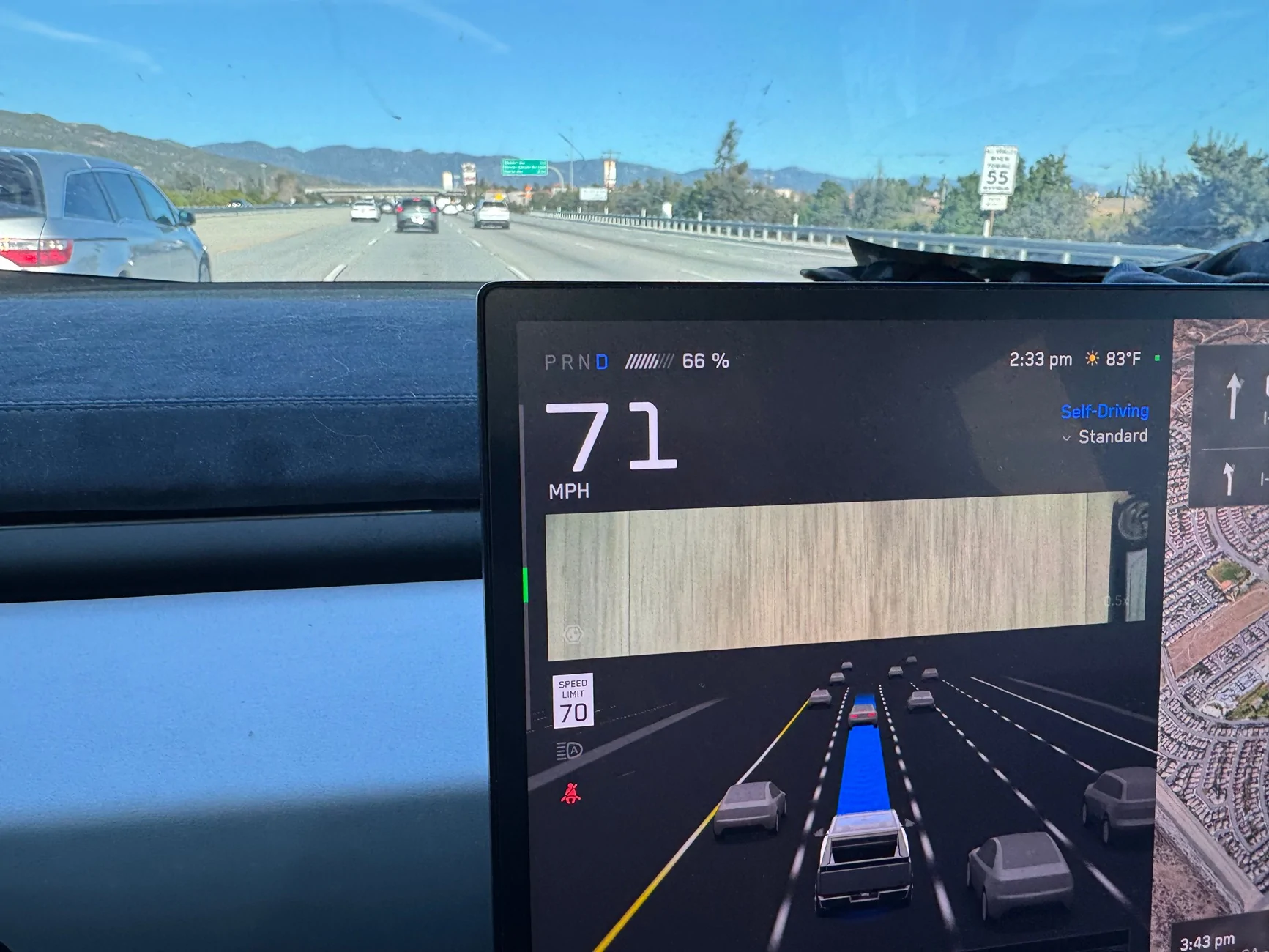

Would you mind sharing some total average Wh/mi numbers too? 😊 Here’s what we got on our test at 70 mph: 51.2 miles in 45 minutes, averaging 68.26 mph since it took a minute or two to get up to speed on the freeway.
We saw 455 Wh/mi with:
  • Starlink Mini
  • 20-inch CyberWheels
  • Starlink and fridge on
  • Terrestrial Armor Package (without rear wheel fairing)
  • 7-inch tall tent on the rack
  • 8.2-ft 270 Awning
  • CyberBeast light bar
On flat California desert roads, it came out to 455 Wh/mi.
Just a heads-up, this is our second CyberTruck, the CyberBeast, which is a bit less efficient than the AWD version.

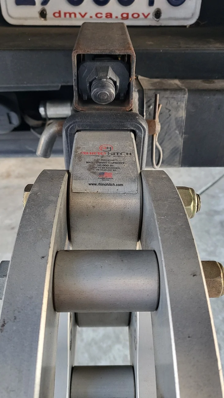

Can also go lower with stock cable, but that might not work with the Rigid hitch?

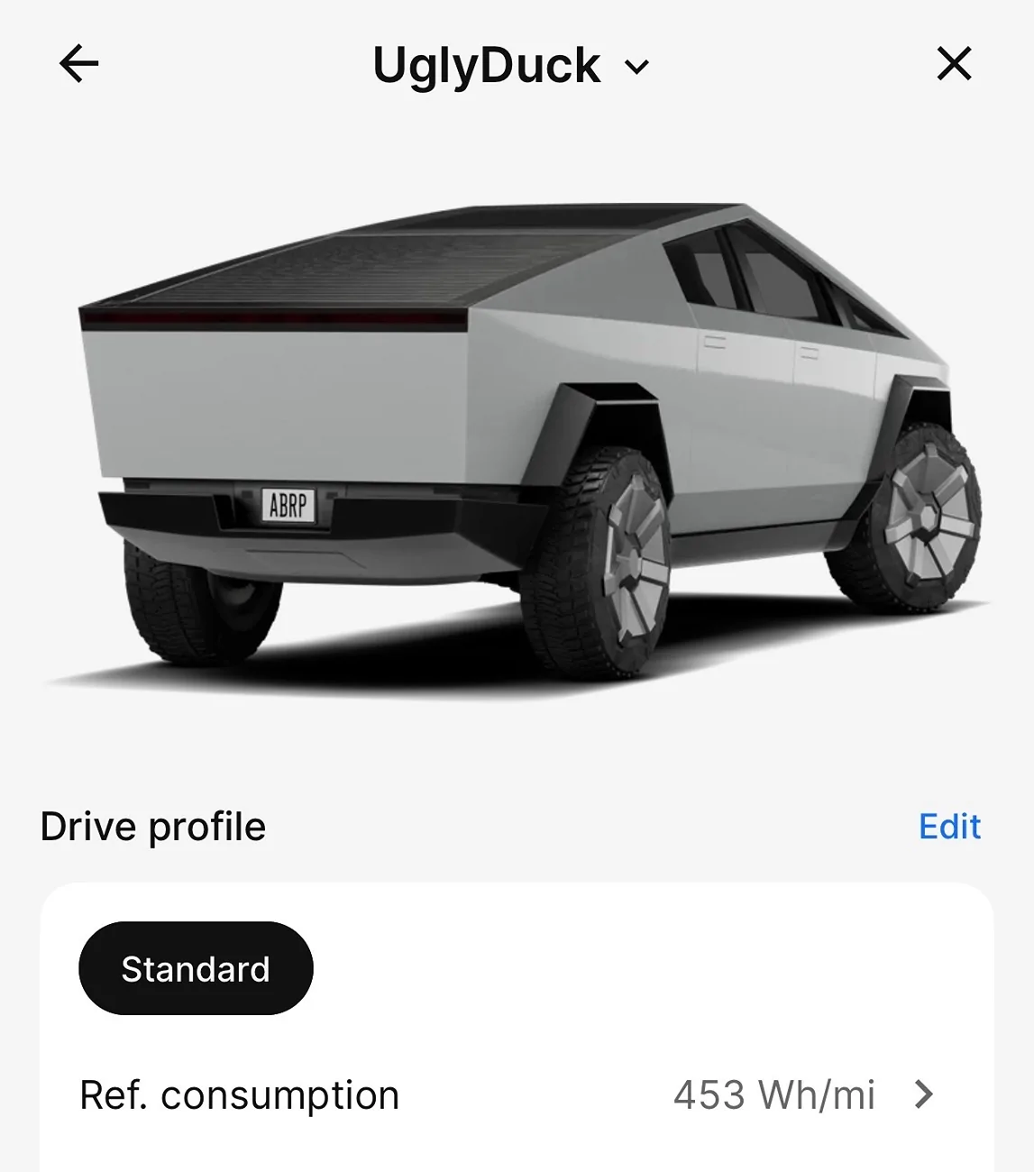

I haven’t done any A vs B comparisons, but an interesting way to measure your efficiency maybe to use the ABRP app. It’ll calibrate for your vehicle’s efficiency at 65mph to make more accurate trip planning.
This is what I’m showing after a couple thousand highway miles with my cap, cold temps, Michelin defender tires:

Man. ABRP rear bumper looks way better than the real thing.
