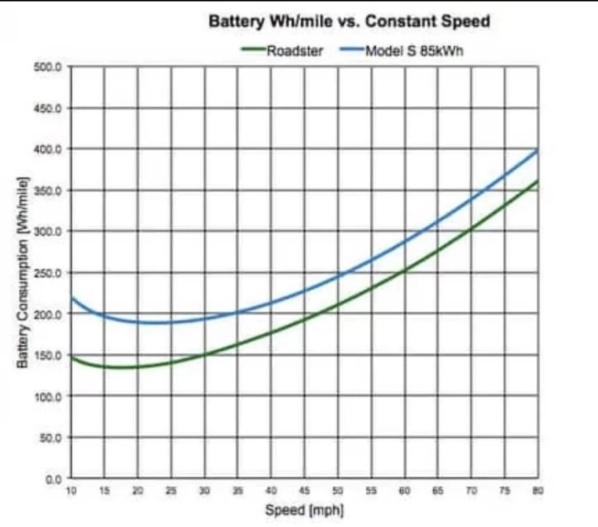

Thanks, good info there but you are calculating that based on cd right? Was hoping Tesla put out a chart like this one for the CT so you can see the efficiency throughout the speed range
Thx. 2 things:
1: at highway speeds those blue and green lines are virtually straight tho.
Compare to the two straight purple lines I drew.
Tesla Cybertruck Chart of efficiency vs speed? KY4PjIi
2: The criteria is in that table. See purple boxes below. HTH
It includes Rolling Resistance using the criteria below.
Tesla Cybertruck Chart of efficiency vs speed? OIJ9CcB
