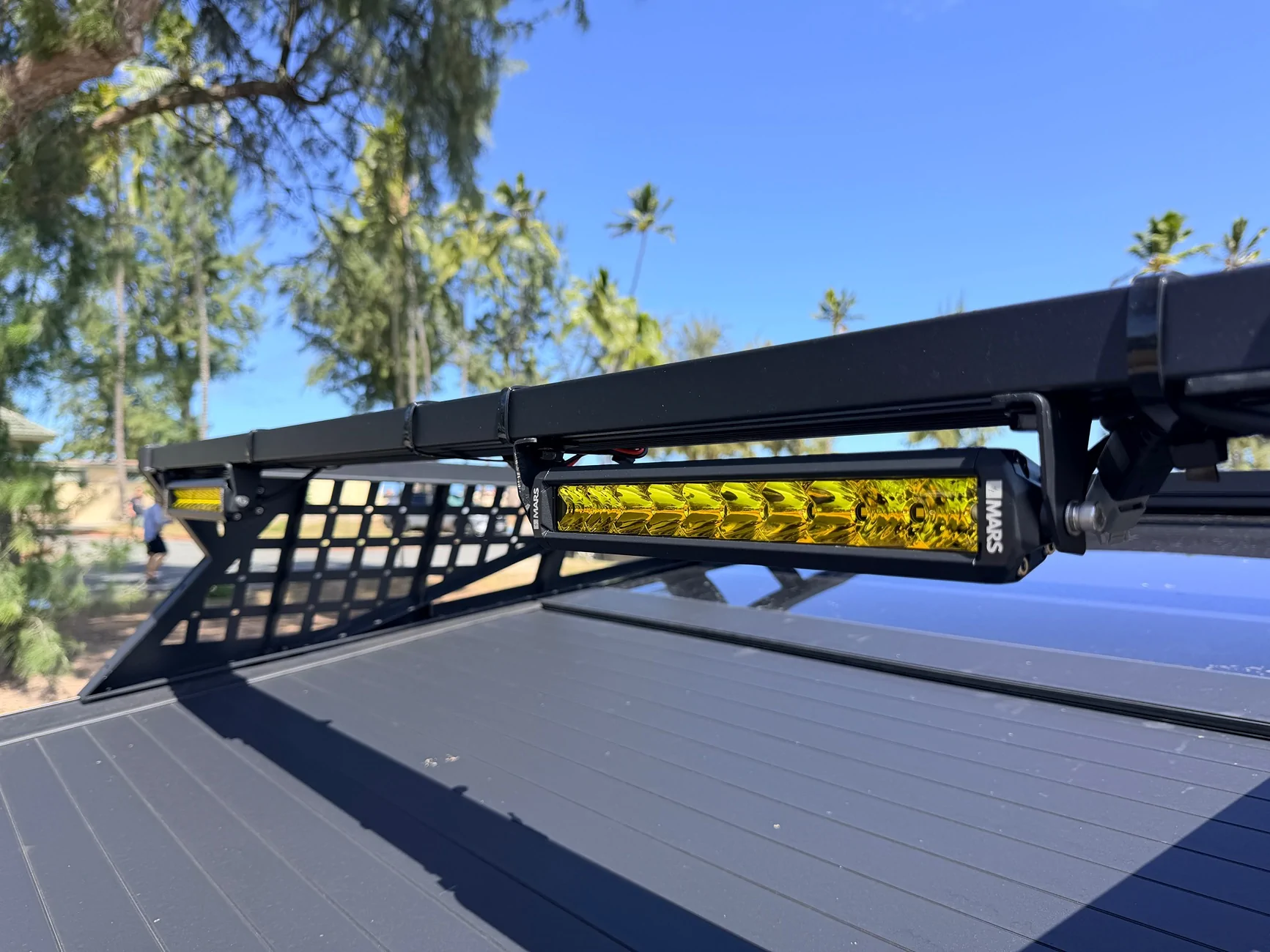

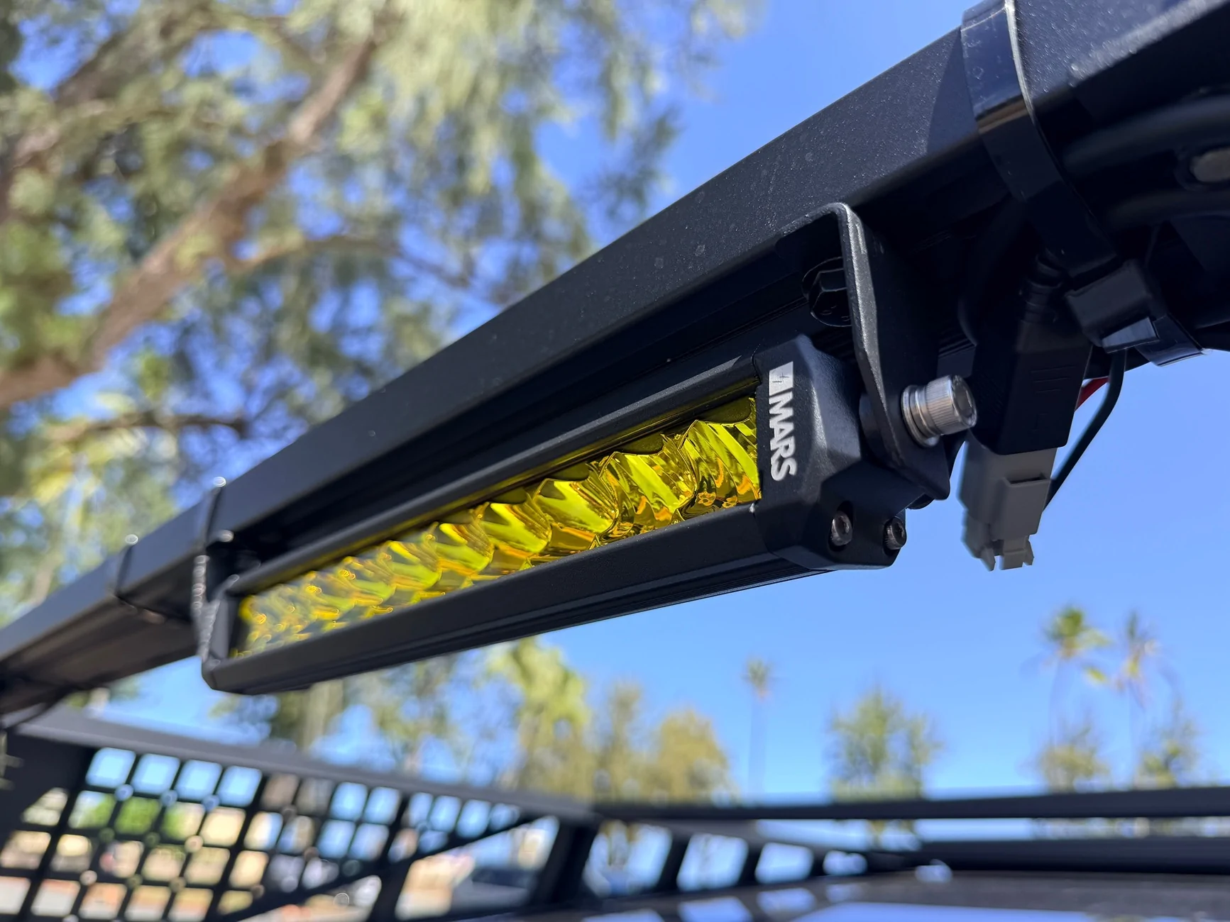

Howzit! I had some extra hardware so I ended up sliding one of those flat nuts inside the crossbar channel.
I had to drill out the bracket they provided to fit the bolt since the screw was too small. Kind of surprising they don’t include that hardware in the kit. The instructions are just paper, really generic, and unlike the front light bar there’s no QR code.
Did you install the Mars front light bar? The thing I don’t like about that bracket is how it sticks up above the crossbar height, which means anything longer than the front rack ends up sitting on top of the light. I’ll post some photos later. I plan on carrying OC1 and stand-up boards, so I’ll probably end up modifying the bracket.

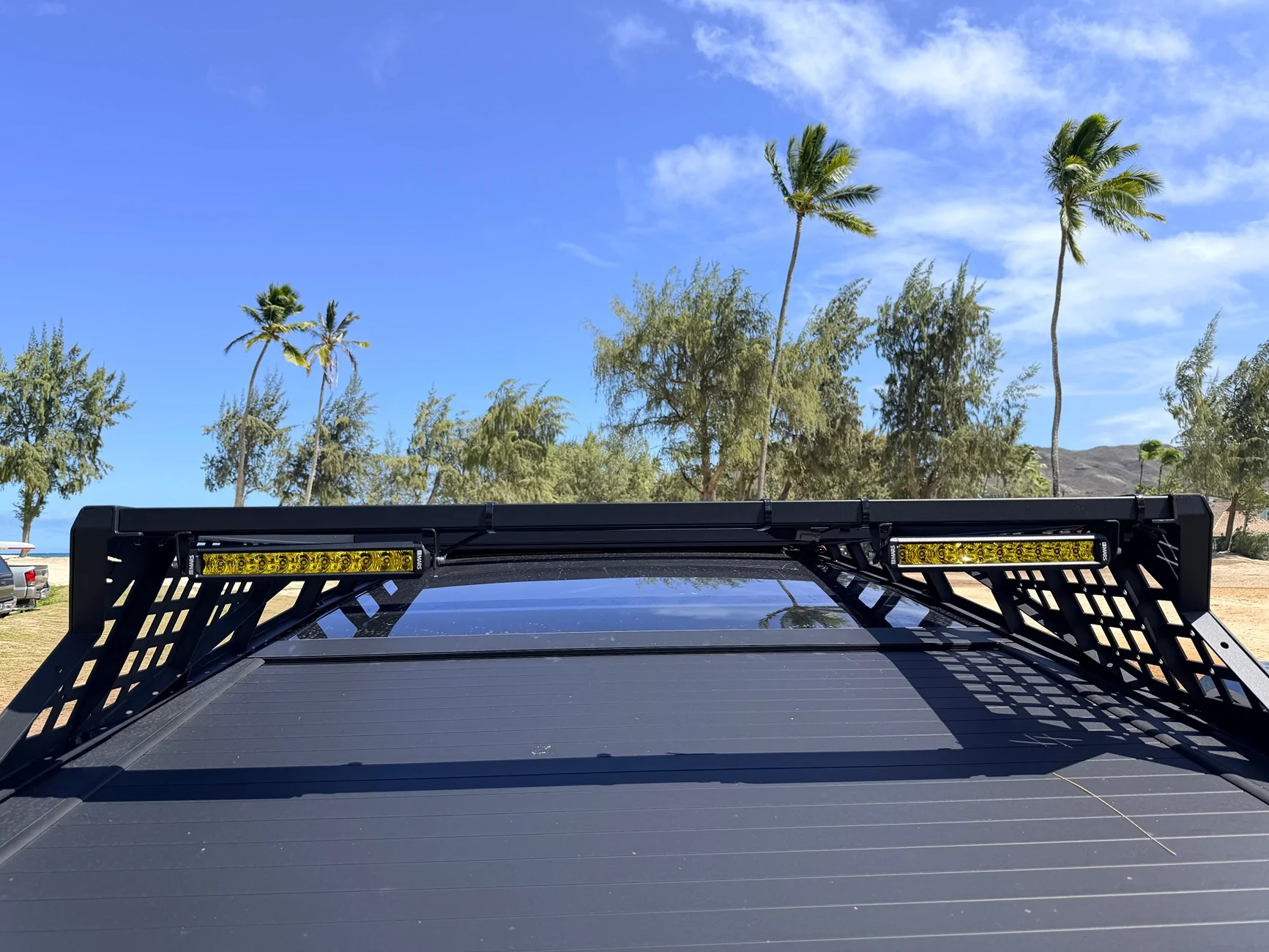

Here are some photo of the rear lights installed I have not wired the front or rear light bars yet
I purchased the Mars full rack system and installed it last week, and I’m pretty happy with the functionality and look. I also bought the front and rear light bars. The front light mounts to the rack using sliding nuts inside the tracks, while the rear lights seem to use the universal bracket system. I searched the site but couldn’t find any details on how to mount the rear lights. Has anyone installed theirs? If so, a photo would be great.
Here are some photos of the rear lights that I mounted. I have not wired either the front light bar or the rear lights yet

They look super nice. So is Howzit a popular Hawaiian greeting too?
