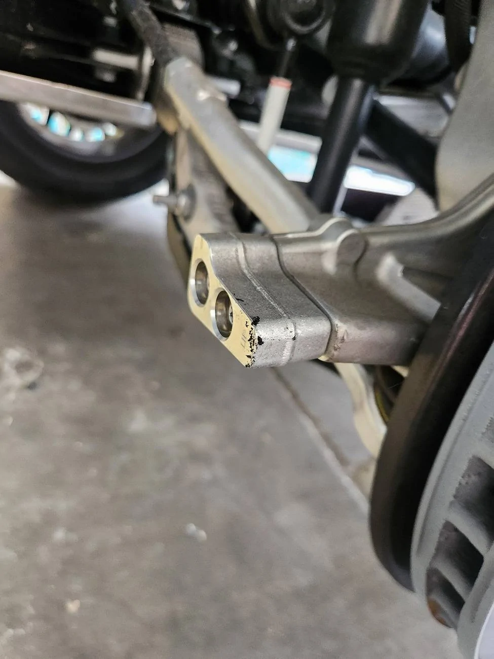

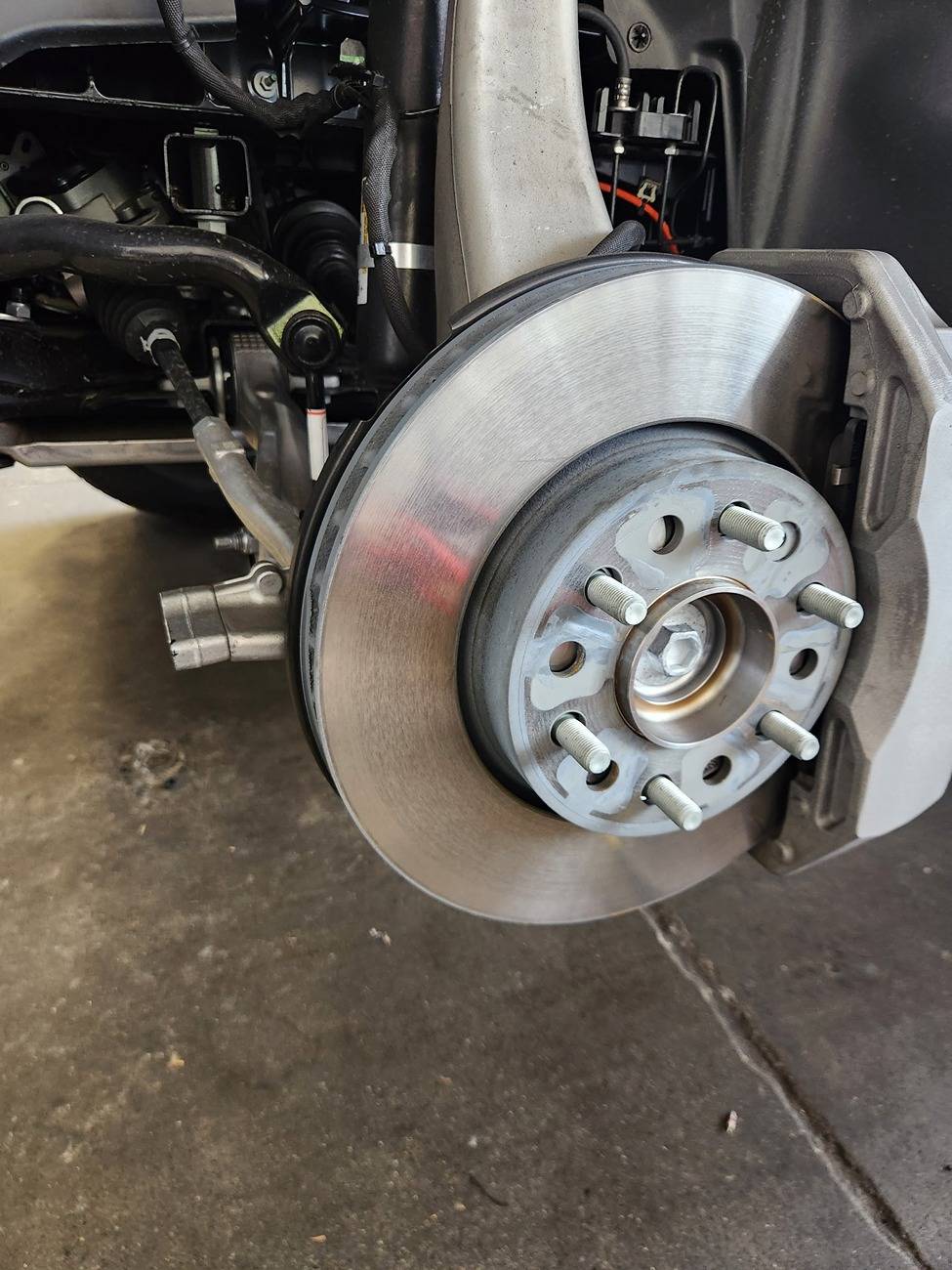

Need some help, can I remove these, as it's making so I can't mount my wheels. What exactly is this?
You do have to remove the block to fit 18” wheels. There’s some debate about what exactly they do, but it’s got something to do with brake harmonics. I took mine off already to see what happened, feel no difference at all.
That's exactly what it is.
