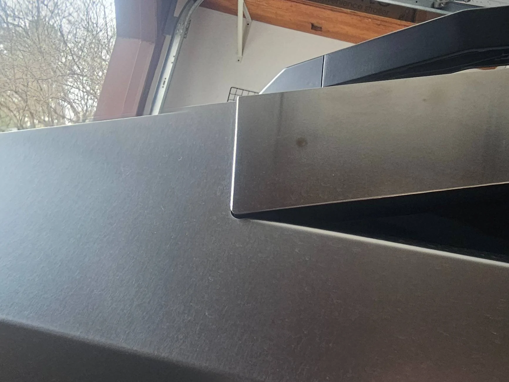

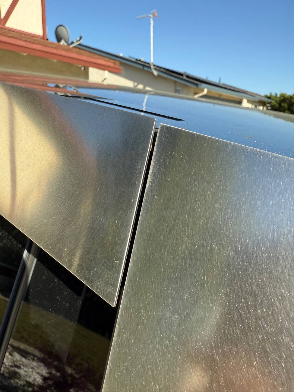

Got my cantrail replaced on a June 2025 build CT. I detected a small opening mid way up the windshield on the driver side one week after having it wrapped. Stop by the service in Rocklin NorthCal and they confirmed my CT didn't have the fix for the cantrail during production. I dropped off the CT on Sat 9/6 and it took them just 2 hours to replace both. Here are some pictures post fix. First 2 pix are on the passenger side.

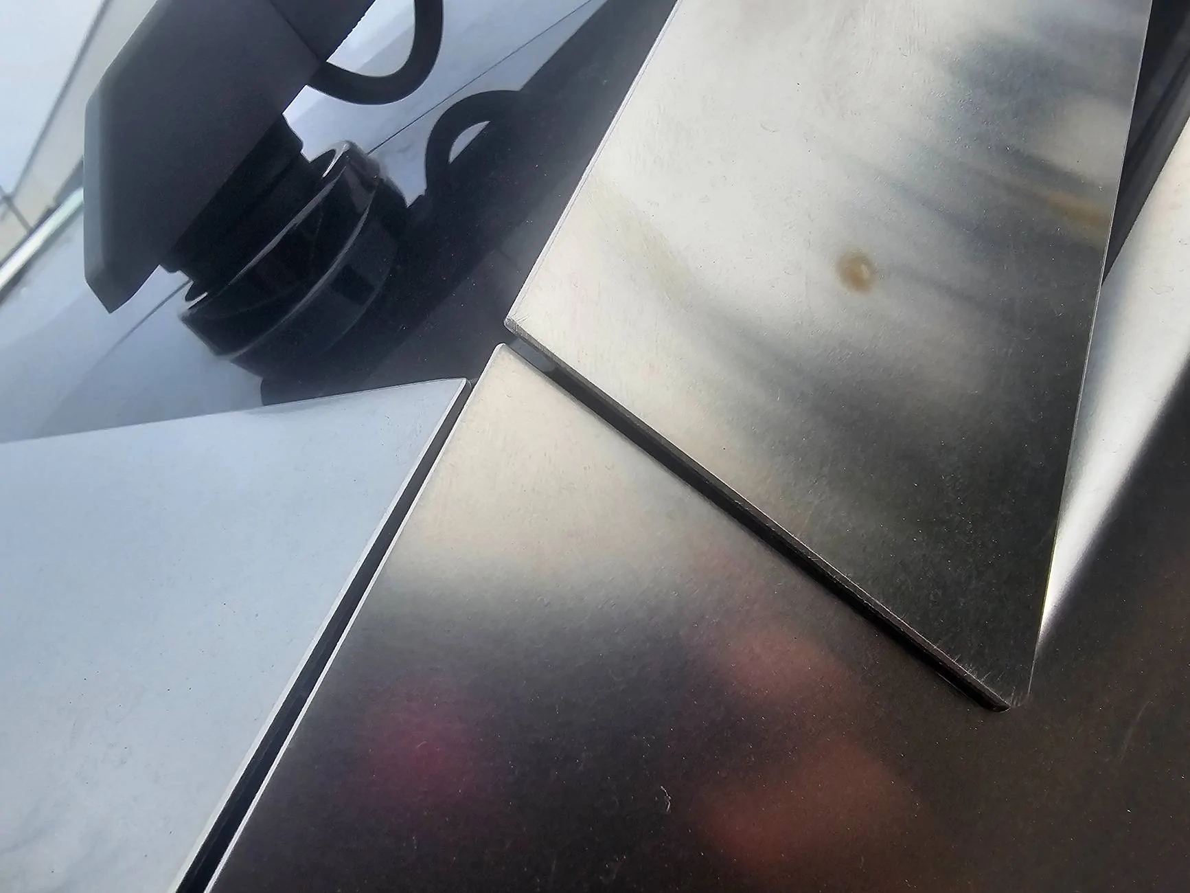

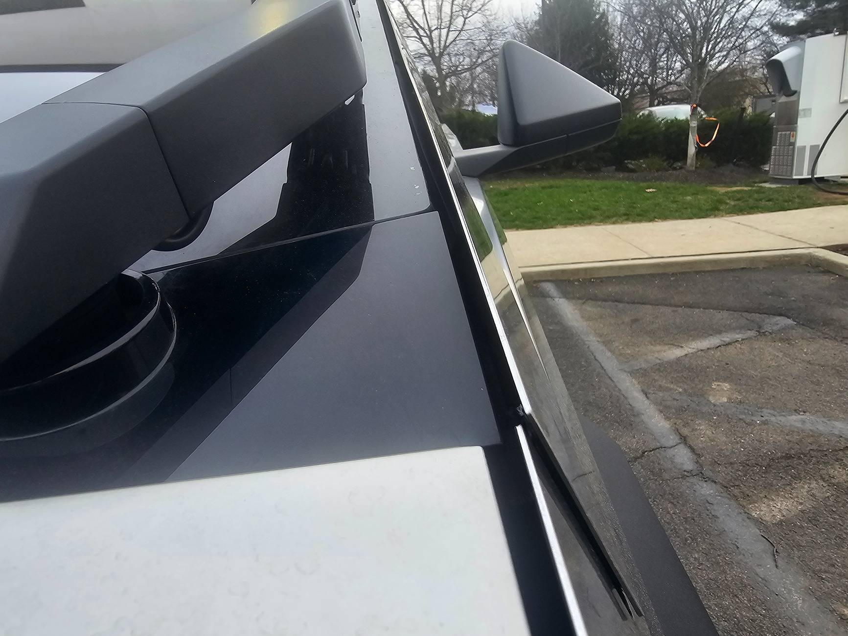

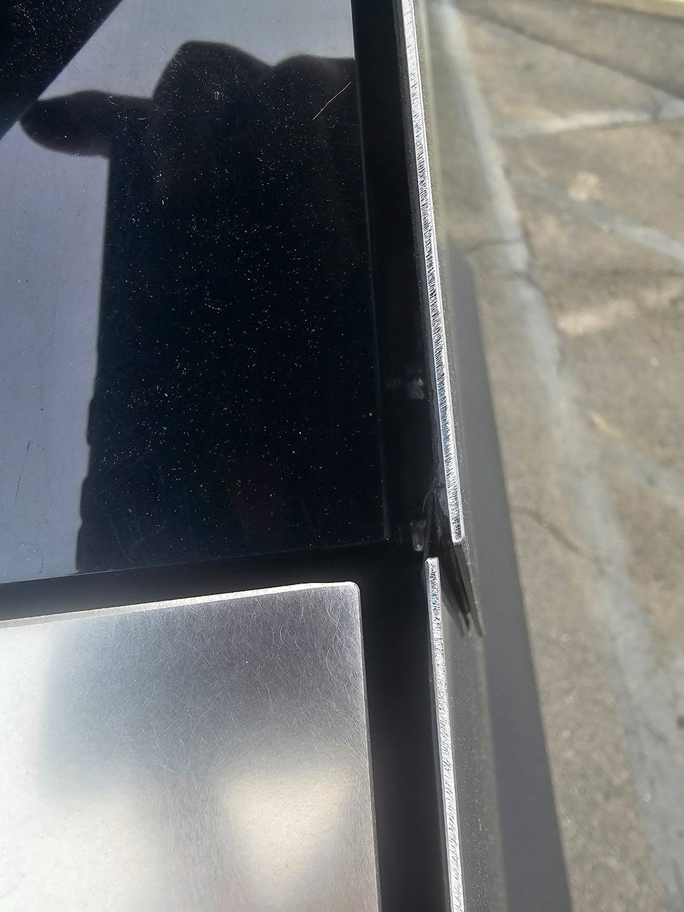

I did what I could for mine, but tech out tomorrow and with both of us I think I can close the gap.
Tesla Cybertruck Anyone have pictures of their post repair Cantrails? 1757437095898-7y
Tesla Cybertruck Anyone have pictures of their post repair Cantrails? 1757437119397-t1
My adjustment - need more hands or a tail.
Tesla Cybertruck Anyone have pictures of their post repair Cantrails? 1757437144594-0a
Comments on adjustment.
(front) - 8mm bolt - open frunk to help you see it. I just used a wrench and a bit of patience.
Weather stripping pealed from corner glass to b-pillar.
Removed or loosened all TORX under weather stripping.
At corner glass I believe its 3 plastic guides / clips.
I used some gloves and massaged the cantrail forward but getting 1-2mm out of all that takes some muscle. And my opinion 2 people.
If I had one more person I could have got it flush and they could have tightened the 8mm.
Then re-add or tighten all the TORX. Put the weather stripping back.
For the ones that are bent out. My gut instinct on this is they bent that a little when removing your old cantrail and it needs to be bent back. Seems to go thru a metal plate. I've had some success pushing mine in but ugh. Just not a great fit/finish or attention to detail. Glad I'm not the only one with these issues but at the same time I wish the SC would take 2 more minutes or ask for help to make this right before slapping it on the ass.

Update, mobile tech was out, said my cantrails were defective. He stated he heard where some were cut short/long. I shouldn't have to go to this degree to get it to fit. Appointment will be made to get it back in.
The spot / distortion or dimple I see on both driver and passenger is where they weld it now per the recall so nothing to be done there.
Hope this helps anyone else having issues.
