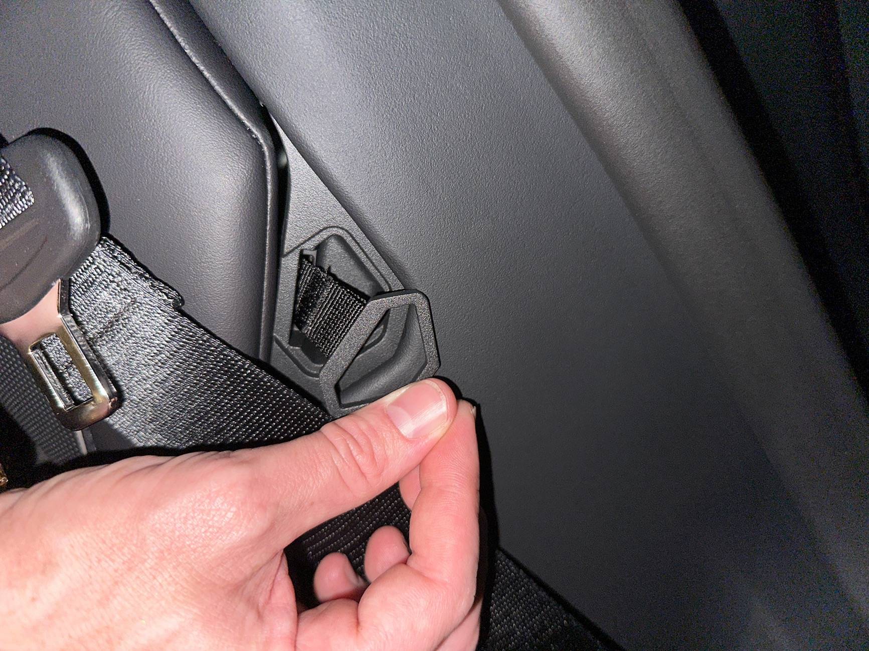

Over the last week, I’ve noticed that my rear seats (behind drivers side) keep spontaneously folding up and won’t stay down. Has anyone else had this issue? Hoping it’s an easy fix. Will attempt thorough troubleshooting tonight and report back.
Note: I haven’t installed rear under-seat storage bins or anything aftermarket that would cause this.

fr tho, likely just needs the clasp adjusted unless it’s faulty altogether and just warranty that.

Turns out this strap was pulled out slightly and twisted so that it couldn’t recoil back inside the spool. I just untwisted and set it back in place. Seems to have fixed it.
