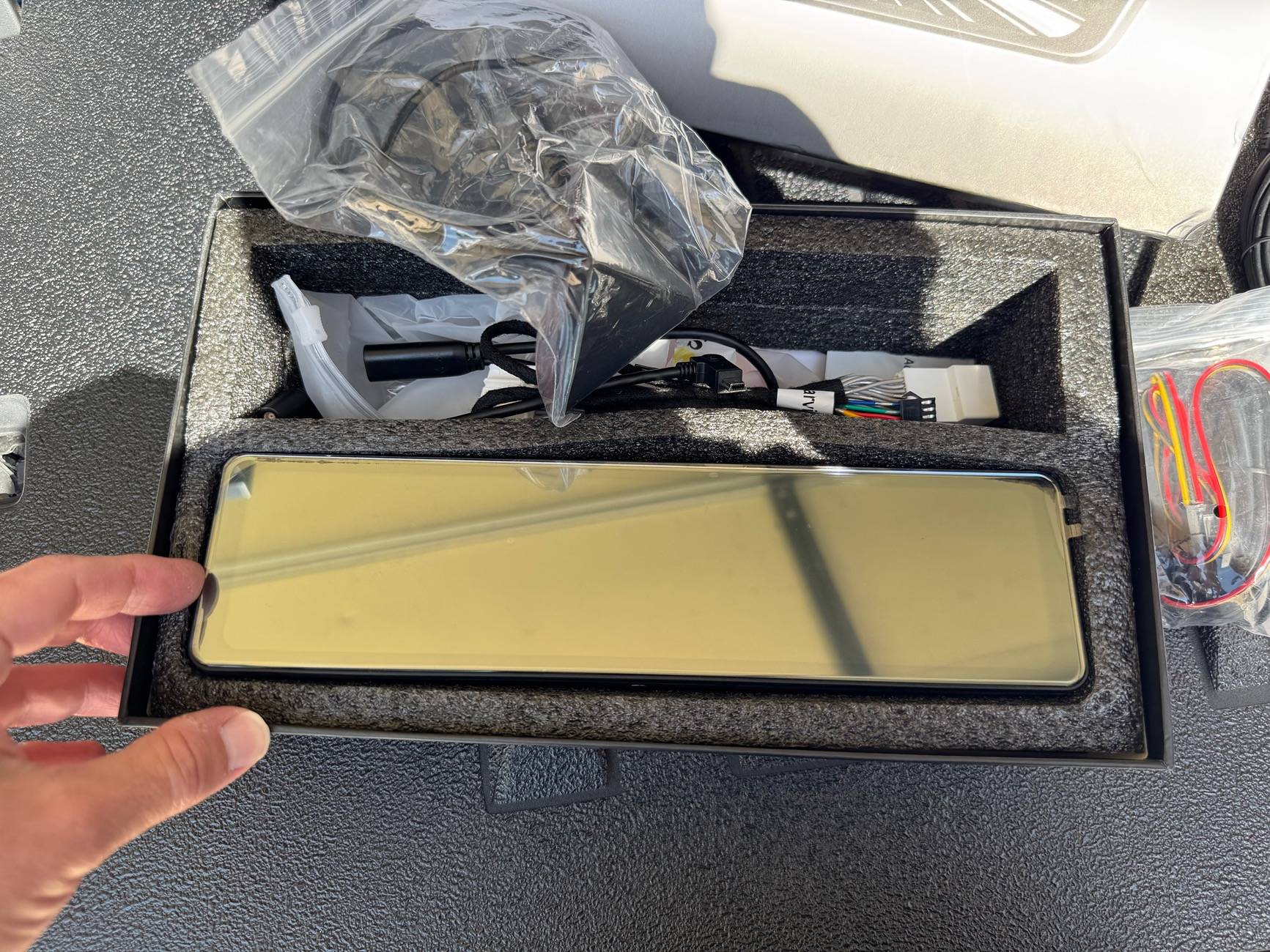

Hansshow sent me the new 2.0 Mirror and I received it today. Not sure how I feel about installing another one of these to test. If I do, I’ll probably not do a permanent install and just test it for a couple of weeks first. Anyway, this thing is HUGE! About 1ft long. I think it might look too gigantic in the Cybertruck
to be honest.
How did you get the 2.0 mirror? I don’t see that one on the website. I’m also curious how the installation goes and if it works well.

Update on this......
I pulled back the passenger side carpet to install the wiring harness and test out this new mirror today prior to doing a full install. First thing that I noticed is the lower passenger side front speaker on the A Pillar did not function, this is the same behavior I experienced with the Tes Studio/CT Mods mirror. I decided mainly for this reason not to do the full install, but I will probably find someone else locally who wants it and do the install on their Cybertruck for a video. Anyone in the Upstate area of South Carolina who wants it can reach out to me about it. Here is some other thoughts that I have on it:
Pros:
-Great design looks like the oem rear view mirror but bigger
-it is very big (about a foot wide)
-very lightweight mirror despite its size
-camera housing that mounts on top of tonneau is very stylish and has no visible seams
Cons:
-still causes minor power issues plugged into CT wiring (see above)
-no sensor or auto brightness control that I can tell (can change easily on screen)
-no way to remove the time from being displayed on mirror
-scrolling up and down of video feed is slow and choppy
-camera cannot be mounted on license plate area easily

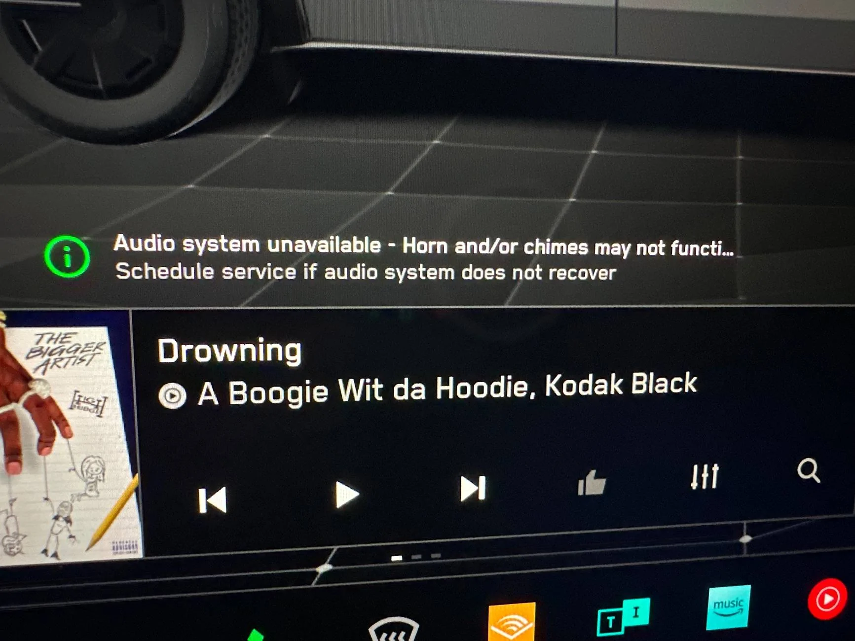

Similiar issue here. I had same error on screen and my phone bluetooth microphone stopped working. I can hear people, but they can't hear me. Unplugged the harness from oem computer and everything is back to normal, but obvisouly no rearvew camera currently. Very annoying.
I have the TesStudio one that @ShockAuto posted and it’s great except for the “Audio system” error that many people are experiencing. The right speaker on the passenger side is not working due to the wiring harness.
I spoke with the TesStudio team and they are expecting to fix this via a software update at some point. But it’s still pretty annoying.
Replacing the 12V+ power source for the media player will fix it—I've already tested it.

Find the ACC 12V+, very close to the speaker wires.

thanks for the in depth review. I am assuming you are getting the audio issue warning on your screen also?
Thanks. No warning. Everything works it's just that one of the tweeters on the passenger side is not working correctly I believe as I was driving for the first time with it today (about 250 miles). I've noticed that the highs on the right side were not as present as they are on the left.

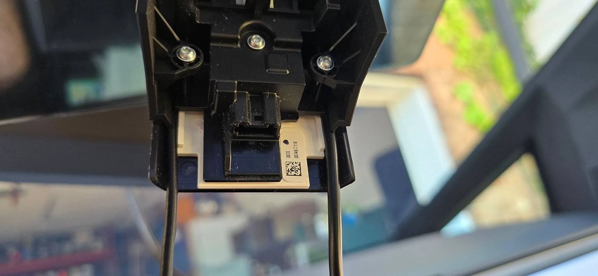

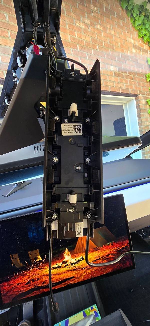

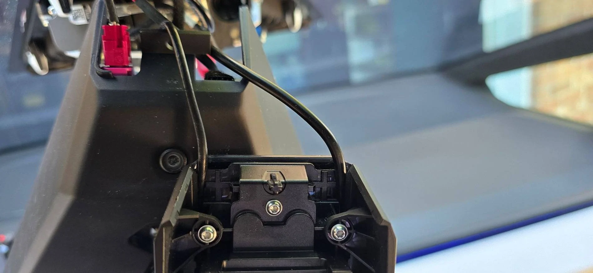

Loosen the eight T8 torx screws and lift the sides of the pinnacle shifter block. It will give enough room to stuff the coax and the power cable into them. Use the driver side for the skinnier one of the two, get your length as short as you can then mount again.
The triangular gps cover is a pain to get back in place. I've hot glued the excess wire around the metal shield. Wires must not cross that metal shield as it will interfere with GPS reception.
My cover did not entirely seat against the windshield but That might be due to not having notched the front of it sufficiently to pass the front camera cable out.

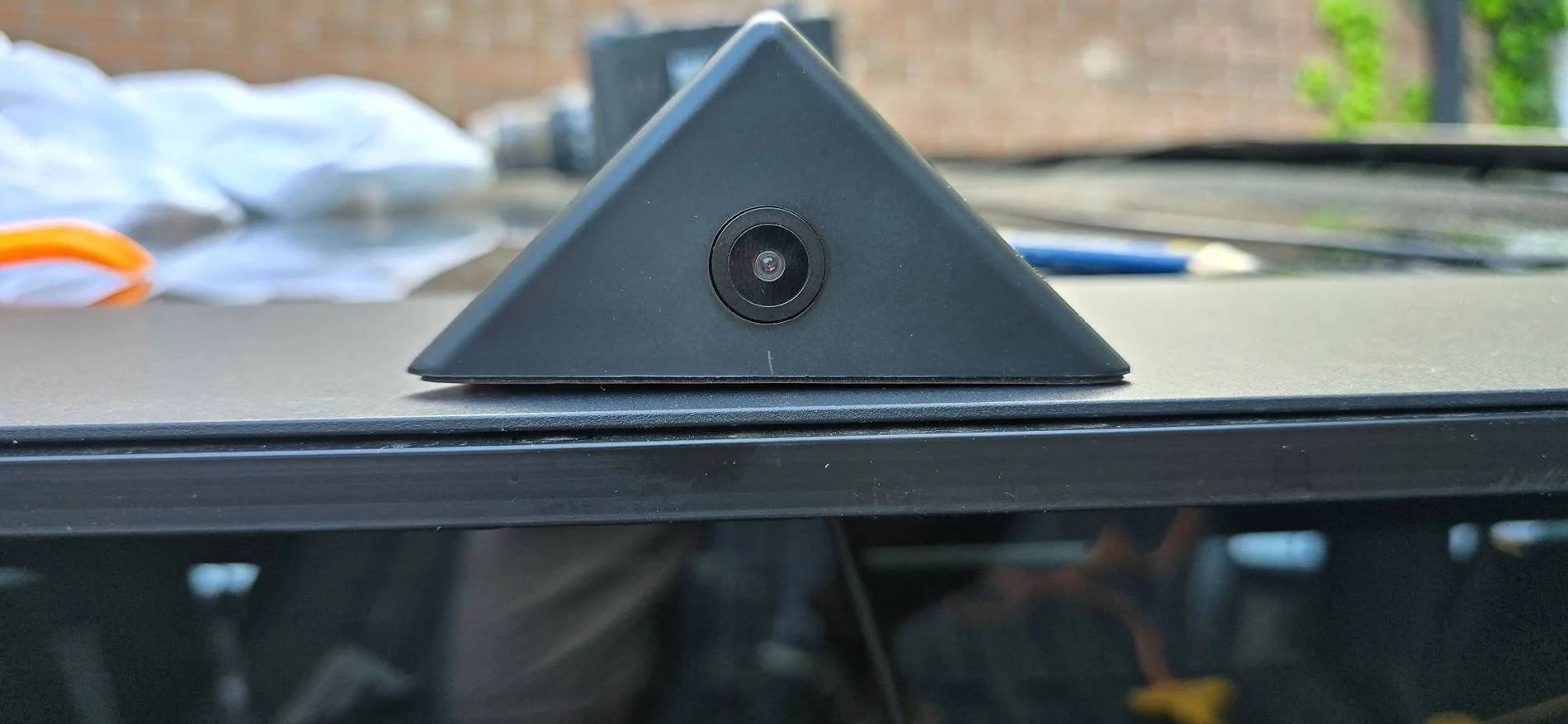

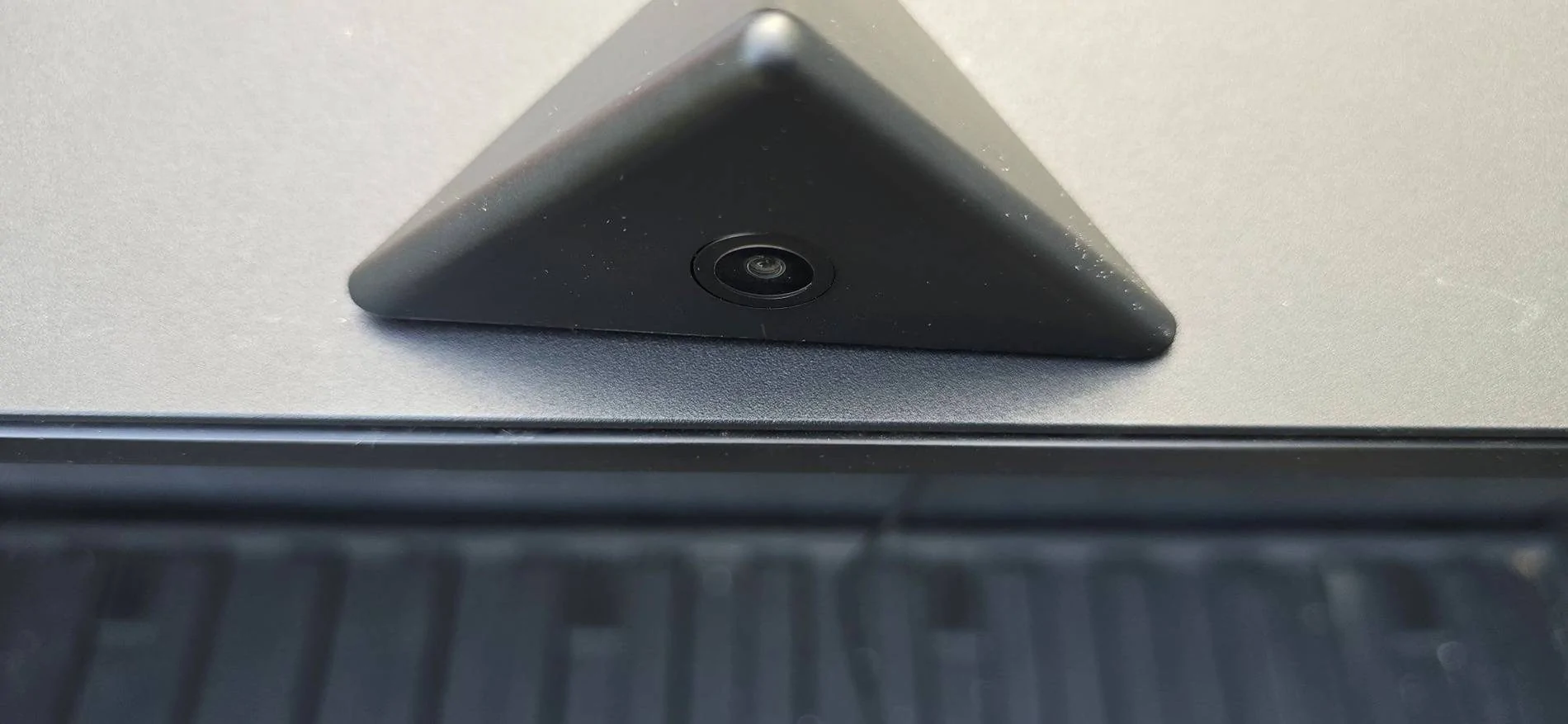

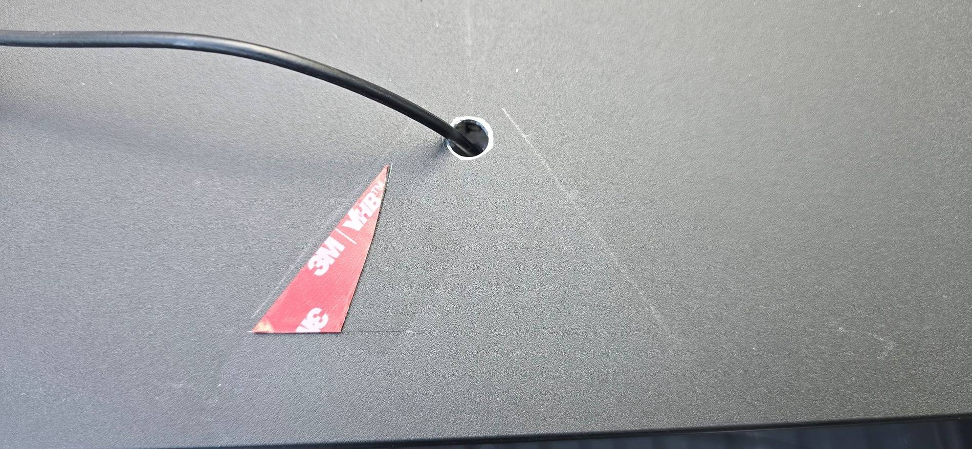

Mounting the camera:
I've drilled the hole through the aluminum. The tonneau will still work as it does not touch the cable as it comes up from below. You'll need to kink the cable tight against the underside. I've used hot glue to secure it. Need to see if that holds up in hot weather. There is room enough though to get the cable not to touch the tonneau.
With the extra mounting tape (3M High Bond Tape) the angel is just a bit too high. I'll take it back off and make the triangle shape less. That should get it just right. Right now I see about a 3/4" different in the screen image from left to right looking at the truck bed corners.
I've used some hot clue to seal the cable hole and the opening at the rear of the camera cover to keep water from getting under the camera. That may need to be done with a UV rated automotive sealant but I didn't have any at hand.
I've used the rubber grommet of the light bar cable to make the transition from the inside to the outside. There's a good YouTube video out there showing how to take the passenger side entry button panel off. It's just a bit tricky to the get it installed again as the hook near the top that engages with the chassis is hard to engage.

The arm holding the mirror is way too weak.
I still have the version one mirror and will see if its metal arm works.
