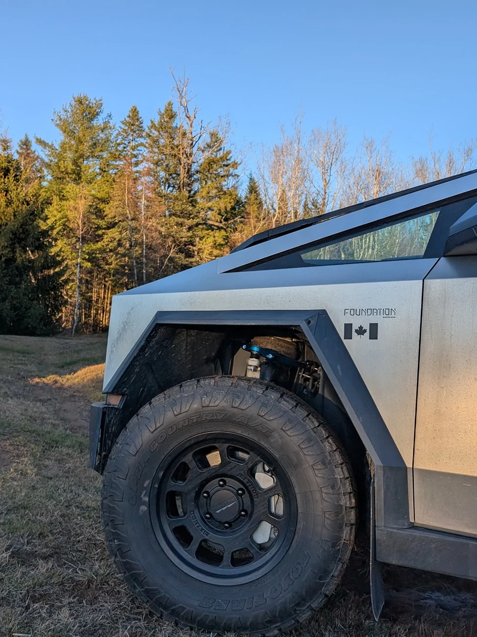

In a Monroe video, engineers talked about the suspension design in the Cybertruck that load on the upper control arm is minimal, thus the thin stamped steel used instead of the thick aluminum used in Rivian. However, not sure if going even slimmer upper control arm will cause issues.
