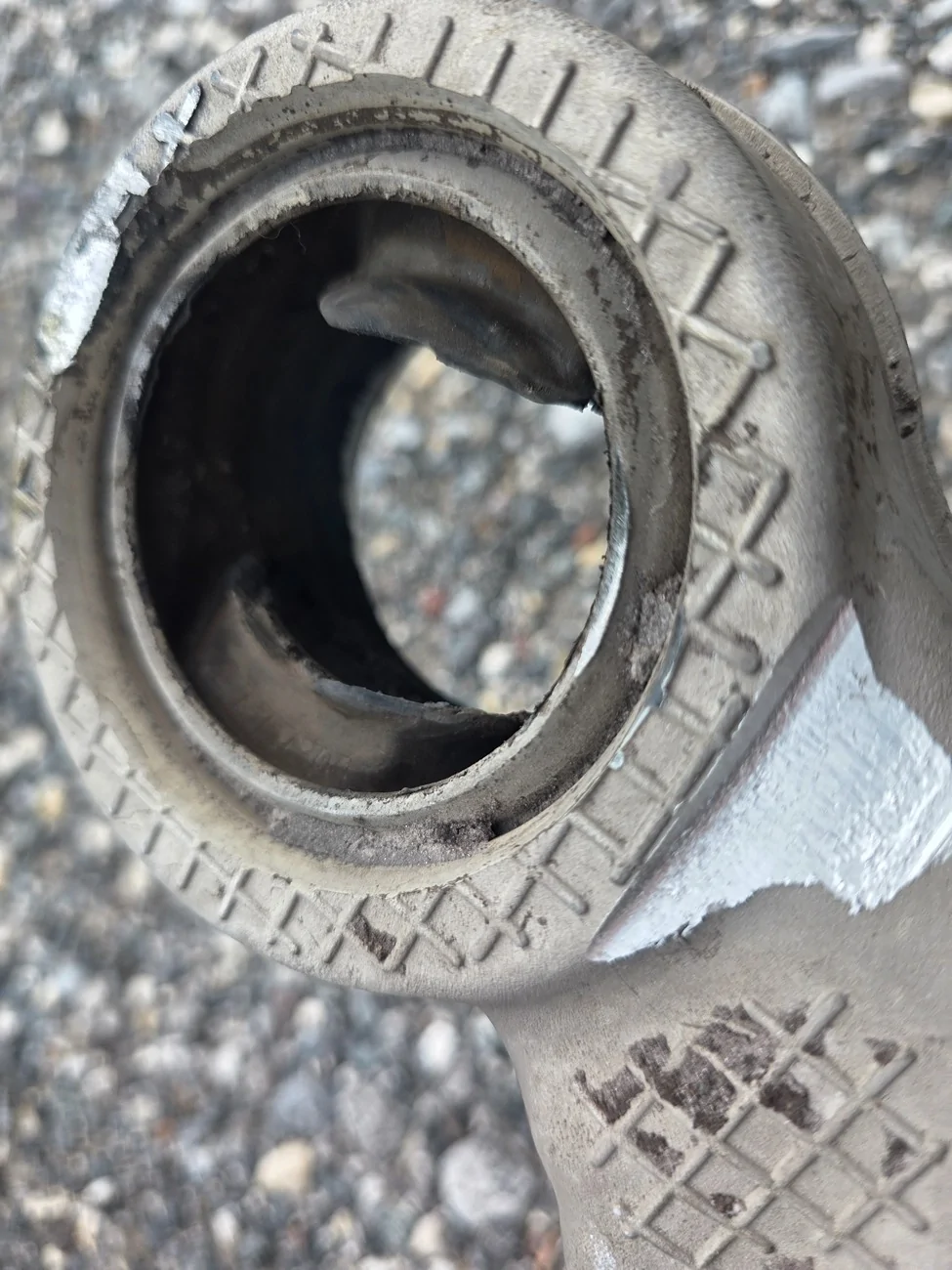

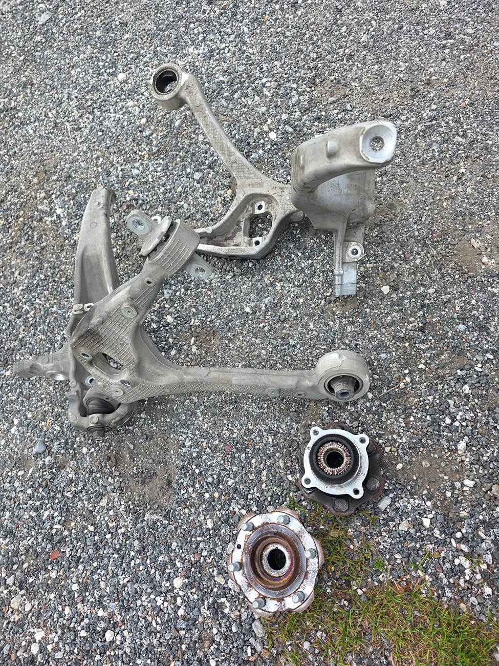

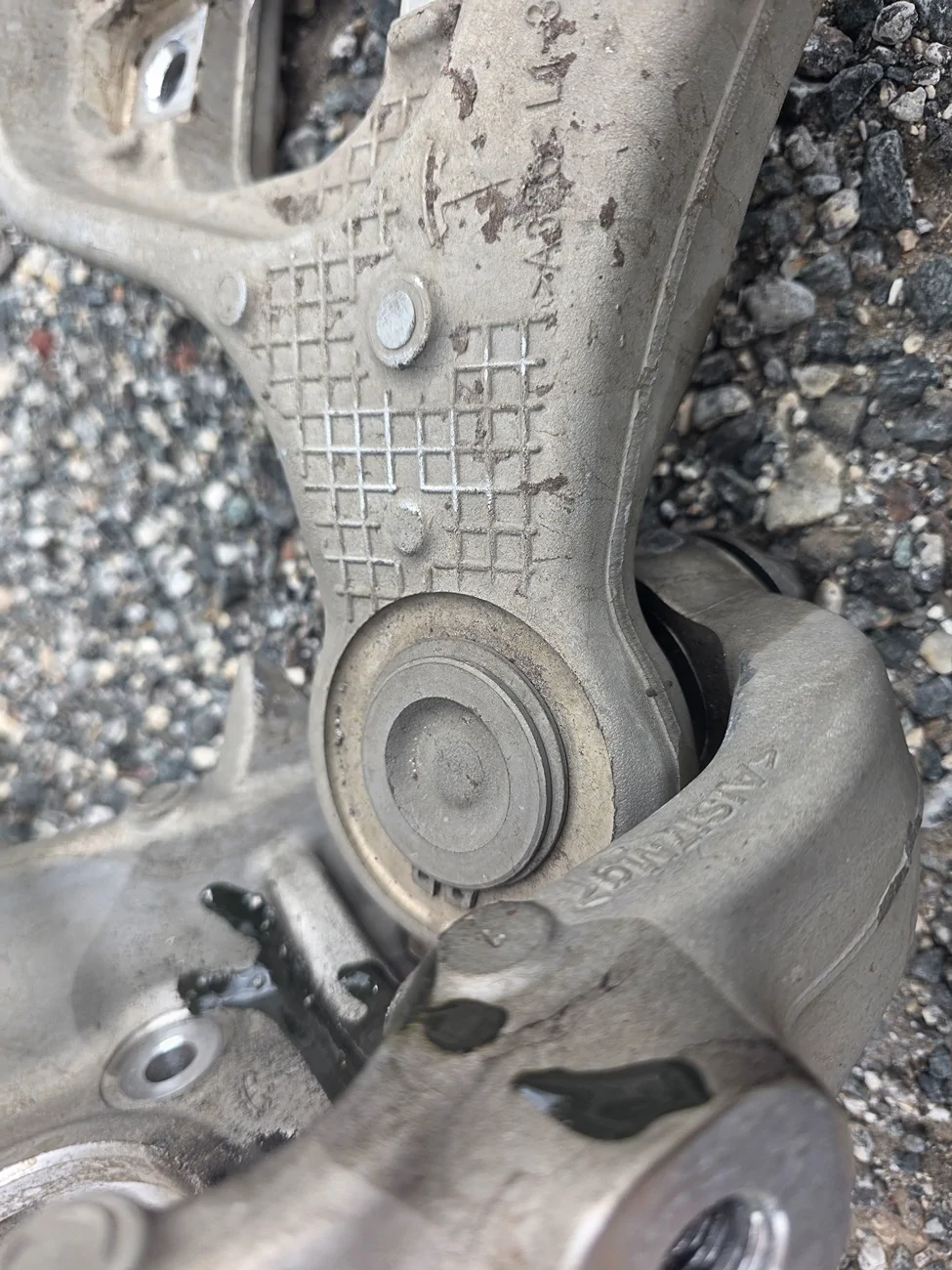

Here is what i got. It looks like the kne bushing was probably loose and sloppy, but everything else felt fine. The splines, etc look great. My truck has never had a hit or anybdrama on the front end.
I've taken it off road, it nothing approaching crazy or really rough.
I'm guessing the bushings are not replaceable. I would have expected.a lot more life from it... .

Yeah, control arm is shot, but I don't see anything wrong with the knuckles...
LCA procedure :
https://service.tesla.com/docs/Cybe...UID-435FE15C-197E-4FA9-804D-A74A81C2C81E.html

My' 24 Foundation Edition Beast has 67k miles. I started hearing a clunking noise when going over bumps, etc. Tesla just replaced both lower control arms and both knuckles and driven hubs.
I was surprised I had to do that already. Seems weird. It was about $3700 (after the 7k pcs)... Tesla service said it was normal wear.
