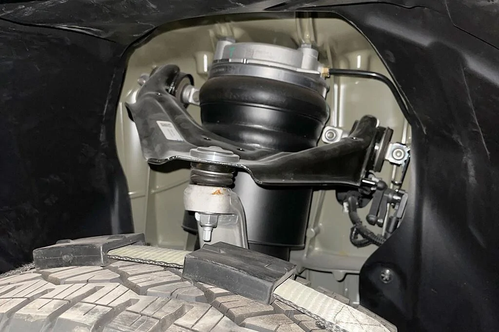

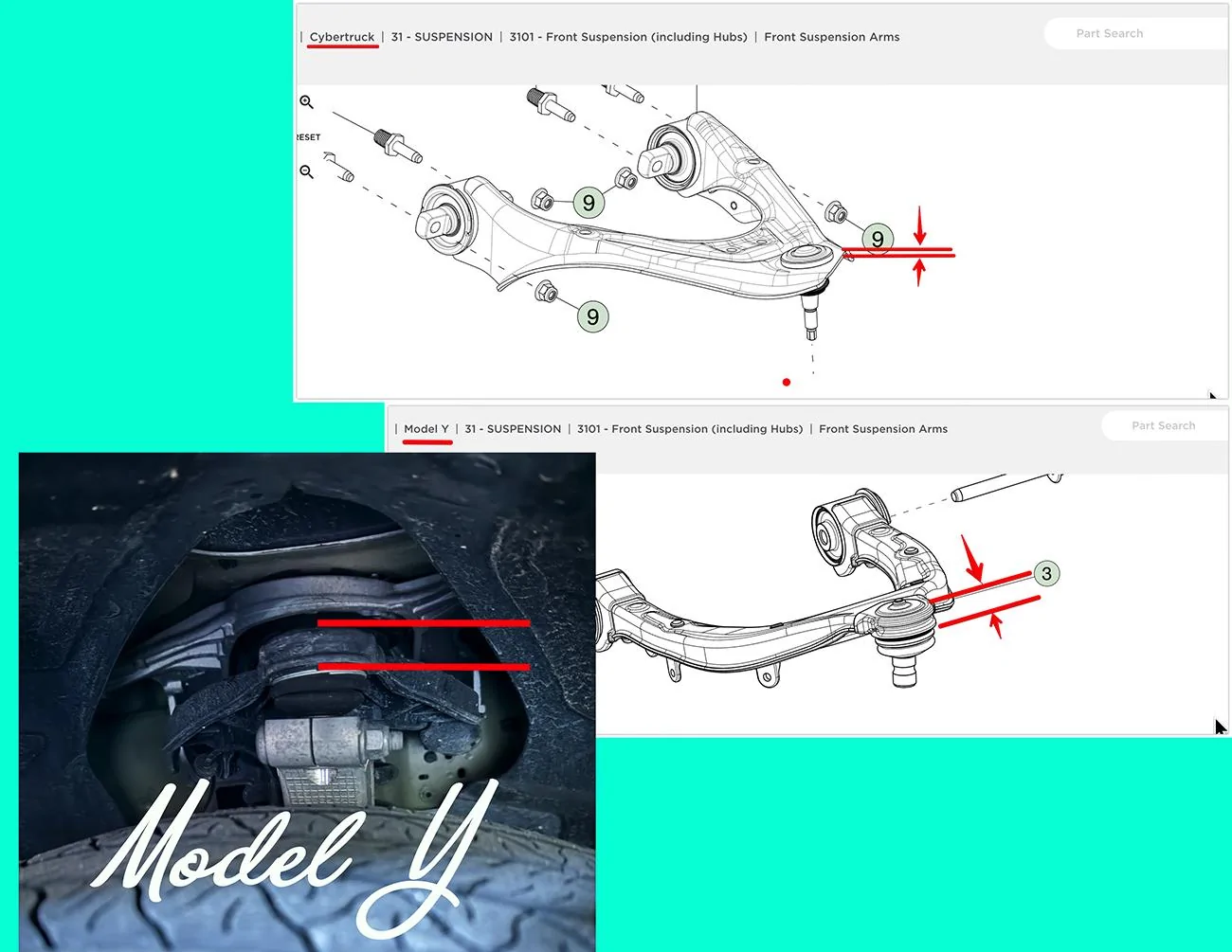

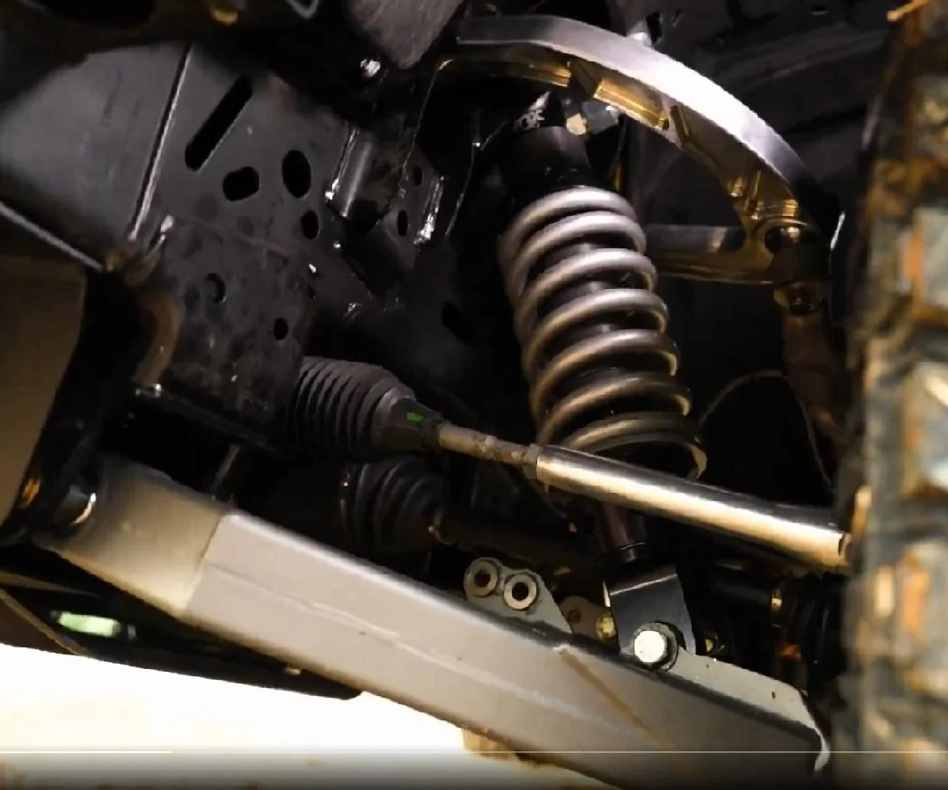

Think engineering missed this one.
here's a comparison of Model Y vs Cybertruck's . Cybertruck will need a beefier upper control arm in my opinion. Parts Catalog shows the same thin stamped upper arm.
Want a heavy duty on my vehicle. How bout you? (Recall for first few thousand +)
Tesla Cybertruck Cybertruck engineers bend upper control arm in testing Cybertruck vs Model Y upper arm sm

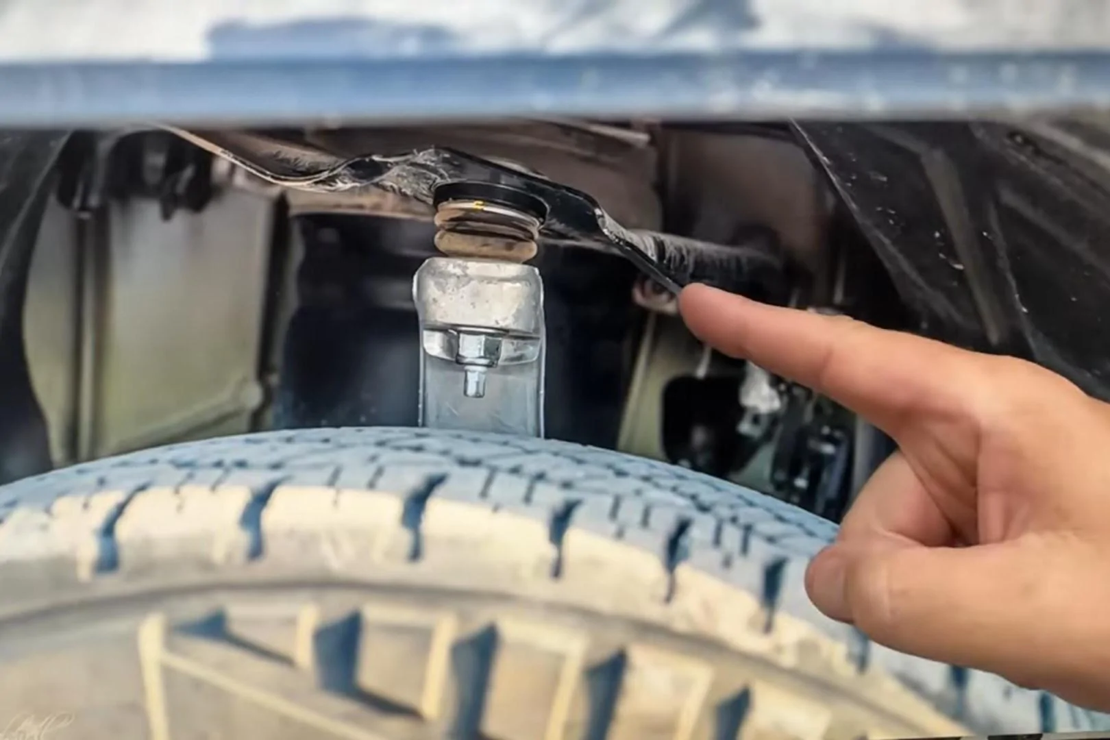

I do think this is an example of where a car company building its first truck has possibly underestimated the design requirements
folks can jump all over me and say “but Tesla engineers good!”
but I’ll remind
Tesla Cybertruck Cybertruck engineers bend upper control arm in testing AA55ACFE-EC6E-4C7D-A1CB-7F08C1849441

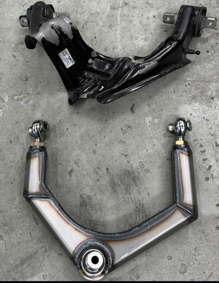

I'm sure unplugged performance will have a 100x overpriced set of beefier control arms available anytime now! :). Does look like they under designed at face value but I'll give benefit of the doubt and if I bend a pair I'll replace with something better!
