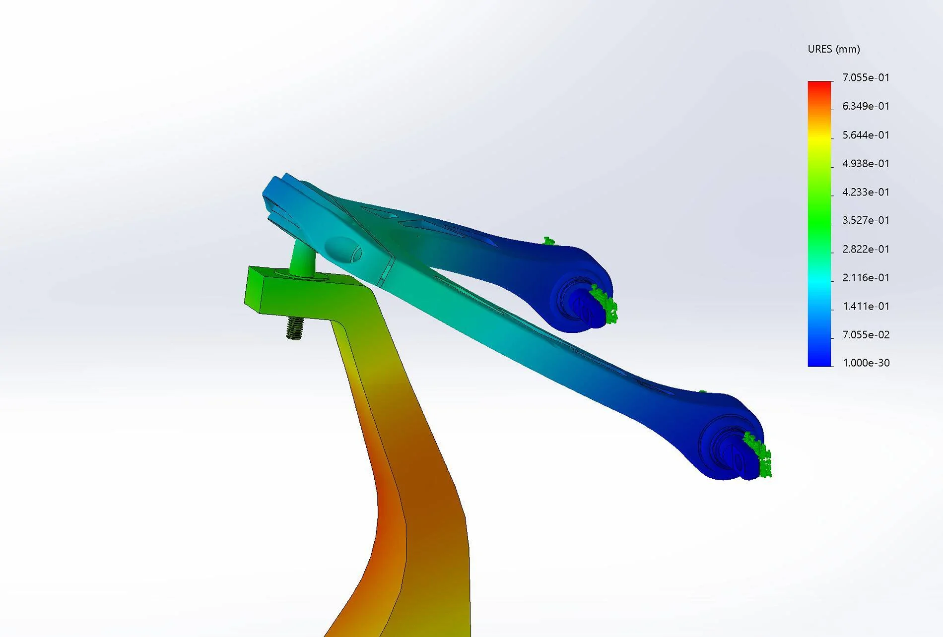

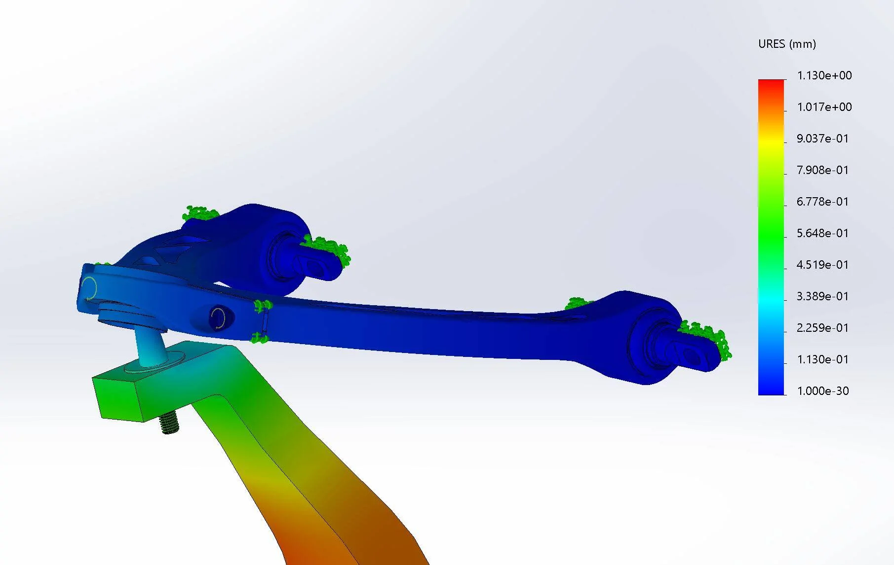

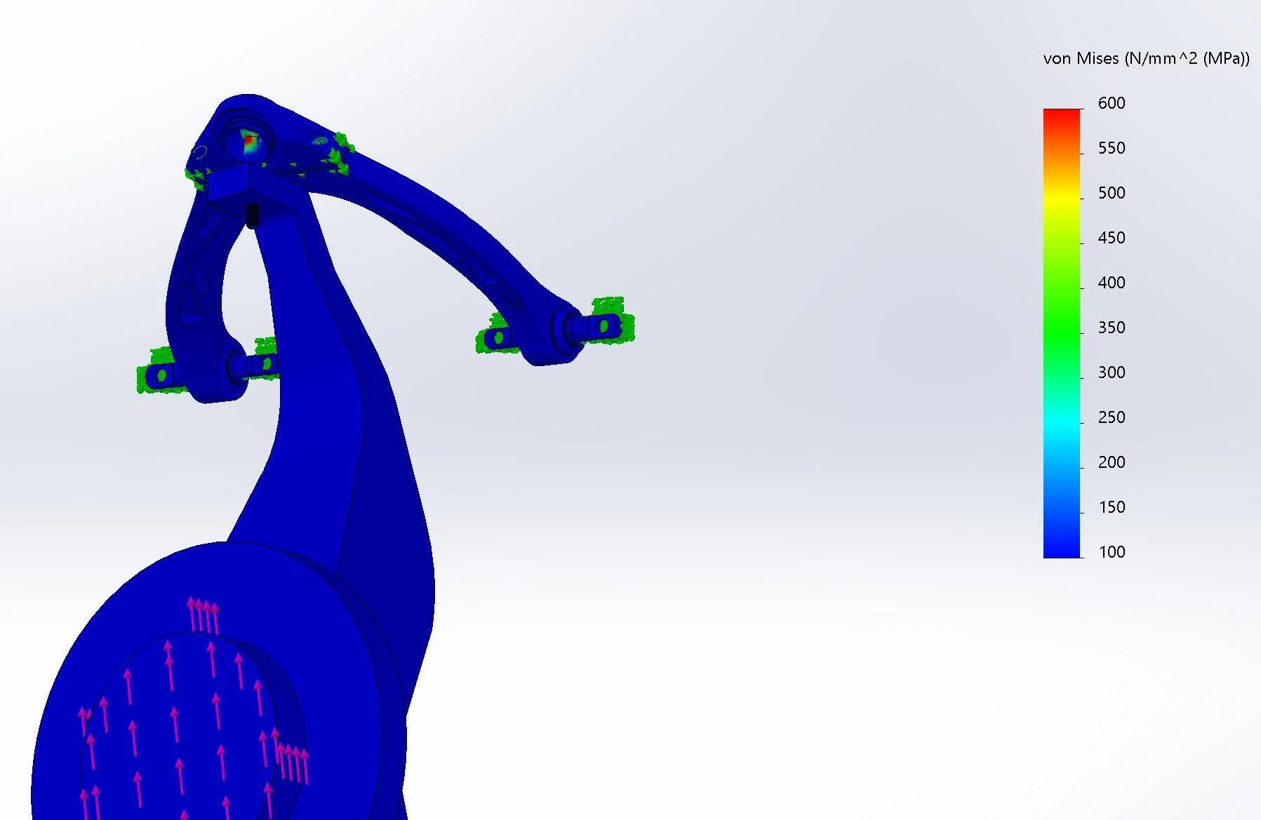

FEA shows that the Balljoint is the weak link, which is logical if you look at the cross section of it, and the way the forces are bending it. Just because it's hidden under a rubber boot doesn't mean it's not there!
Tesla Cybertruck **NEW** MPP "Flight Grade" Billet Front Upper Control Arms for Cybertrucks 1743530641028-mi
If these ball-joints can take these kinds of loads in direct bending, our bolts have nothing to worry about - as the main component of that load is in compression (literally giving the bolt a break from its normal job of being stretched!)

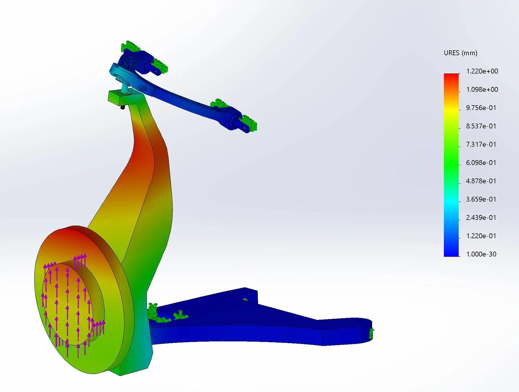

If you look closely, the knuckle itself is flexing more than the upper control arm. The upper control arm really doesn't face a lot of load compared to the knuckle in a compression event:

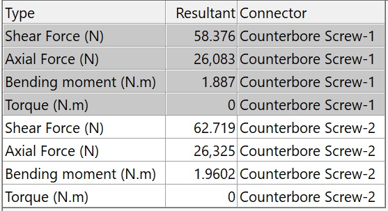

Finally, you can see the loads on the bolts are next to nothing in this worst case scenario:
The Axial Force value is compressing the bolts - not pulling on them!

Secondly, the arms use exposed spherical bearings. Great for race trucks that have regular maintenance. Not so great for daily driven silent electric vehicles. Once those joints start to wear out and creak and clunk, you'll be pulling your hair out and wanting to put back the OEM parts! Not a problem for an ICE truck with a loud exhaust.
Third - you'll see that those arms are simple "2D" shapes. They don't have any fancy contouring to them, which all of our parts can have due to the simple fact that we have a 5-axis CNC and put in the work to design and machine organic shapes that best serve the purpose. This is how we can offer complex parts at a lower price to a shop like Camburg.
In the case of our outer balljoint carrier, there are a lot of different shapes in that part that are necessary to properly align the balljoint to the path of travel.
Lastly - the Camburg arm has a specially designed outer spherical to allow for maximum articulation of the balljoint. This is especially important for trucks with short upper arms. One of the features of our arm is that we can offer different outer balljoint carriers - for example, if people start going really crazy and wearing out or bending tie rods, it's a simple upgrade to make a beefed up, no-compromises outer carrier with a motorsport joint rather than an OE tie rod. This would be a cheap upgrade and you could even swap back to the OEM ball joints (which would likely be quieter) if desired.
So while we're happy to look at other products and admit where we have shortcomings, in this particular case, I only see benefits to the features we've added to our arms compared to the standard "top of the line" offerings in the truck community.
We'd appreciate you giving our parts a try for off-road use. We're confident you'll have the same great experience you have with our track/road car parts. And if you ever have a problem, you can trust that we'll address the issue and fix it.
As the Cybertruck community "grows" and gets more aggressive off-roading, our parts catalogue will grow to meet the demand. We obviously are not going to be building full-out trophy truck parts where there is no market demand. That's just not good business.
I also highly doubt you're going to see any of the companies you mentioned building up any parts until the demand is established, and many trucks are out running around in the desert.
I'll finish by saying - a lot of thought went into the design of these arms. They were fully modelled along with the rest of the Cybertruck suspension, we checked every aspect of the design we could - including running way more travel than the OEM air suspension can run. It's been a massive undertaking making these - they are by no means just a quick copy/paste of our Model 3 or Model S arms.
