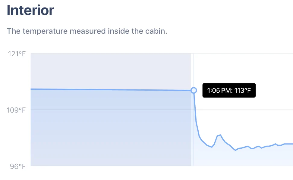

Have not had same experience here.
Currently it is 96F outside and my CT is 108F inside with overheat protection set to 100F as a reference.
I have seen temps of 136F inside my CT before overheat protection update/addition but no issue with blank/black screen.
10,236
33,889
Tesla Cybertruck Black Screen in Hot Cabin Screenshot 2024-05-09 at 3.58.23 PM
Today I used "vent" from the app, it dropped the temperature to about 10º above ambient within 10 minutes.
I've also observed temps far in excess of my COP limit, I'm guessing it doesn't obsess trying to keep it at exactly 100º, but lets it climb somewhat to minimize cycling.
When COP does activate, it seems to take only a minute or two to reach temperature. Heck, it only takes 5 minutes to pre-cool down to my 74º set point.
The chart is from the highly-recommended Tessie. https://tessie.com
