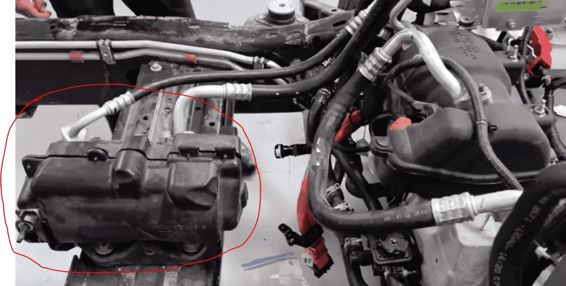

Can you elaborate on the extra cooling? Is this a factory option?
Lightning (at least on my pro), has a Max tow package as an option. That includes an additional compressor. Without it, one compressor is responsible for cooling everything (battery, cabin, may be motors?). The additional compressor helps the chiller take some load off the first one. I think in normal use, one would be enough and it would have less points of failure. However if you are towing uphill in a 90+ degree day, you may want to protect your battery. I was not sure if I would ever need the additional cooling but I wanted to to have it just in case. In addition, if I recall correctly, for my truck Ford initially said max towing is 5000 lb without the tow package and 7700 lb with it. I am not sure if they changed that later. I have never tried a Lightning without it but cabin cooling on a 90 degree day was more than enough with this setup for me.
Here is the second compressor.
