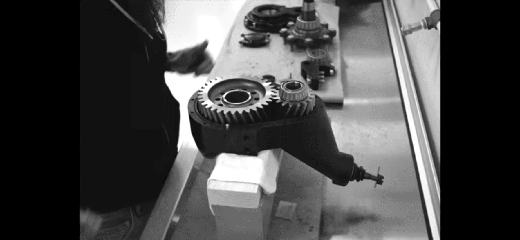

Deleted member 3316
Guest
whatever you just said…. This is what i heard
There are two possible configurations;
One that maintains the rotation of the axles to drive the wheels forwards (see above) the other requires the drive shafts to be geared in what would normally be reverse.(see Bollinger B1 portals below).
Tesla Cybertruck Can we talk Skid Plates? 9E5F1CB2-F0B3-437D-B1FD-0BF4CF690637
To run the Tesla motor in reverse (if using a two gear portal hub gear set) for extended periods the impeller that lubricates the motor and gearbox would need to be replaced to to adequately pump oil through the system.
Tesla Cybertruck Can we talk Skid Plates? D7A88AFC-6865-4E54-AACF-877995FD8EFB
