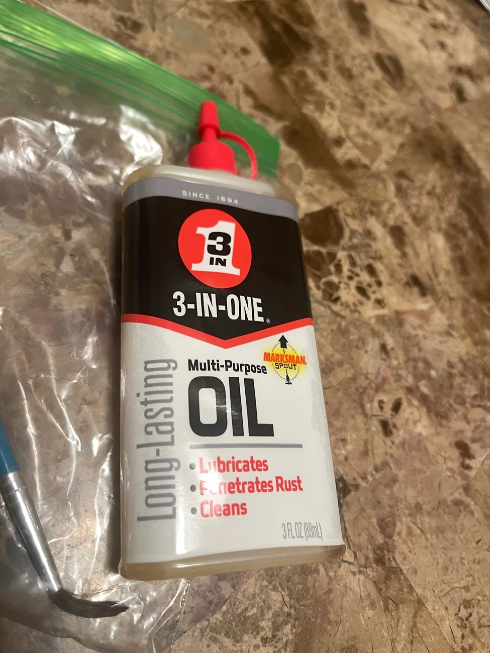

Ours we definitely over torqued and Machine Oil solved it immediately for us. Loose 1/2 to full turn and you should be good to go!

Your picture of the can of 3-in-1 Oil brings back memories of my childhood days tinkering with everything mechanical. Those were vastly simpler days then.
