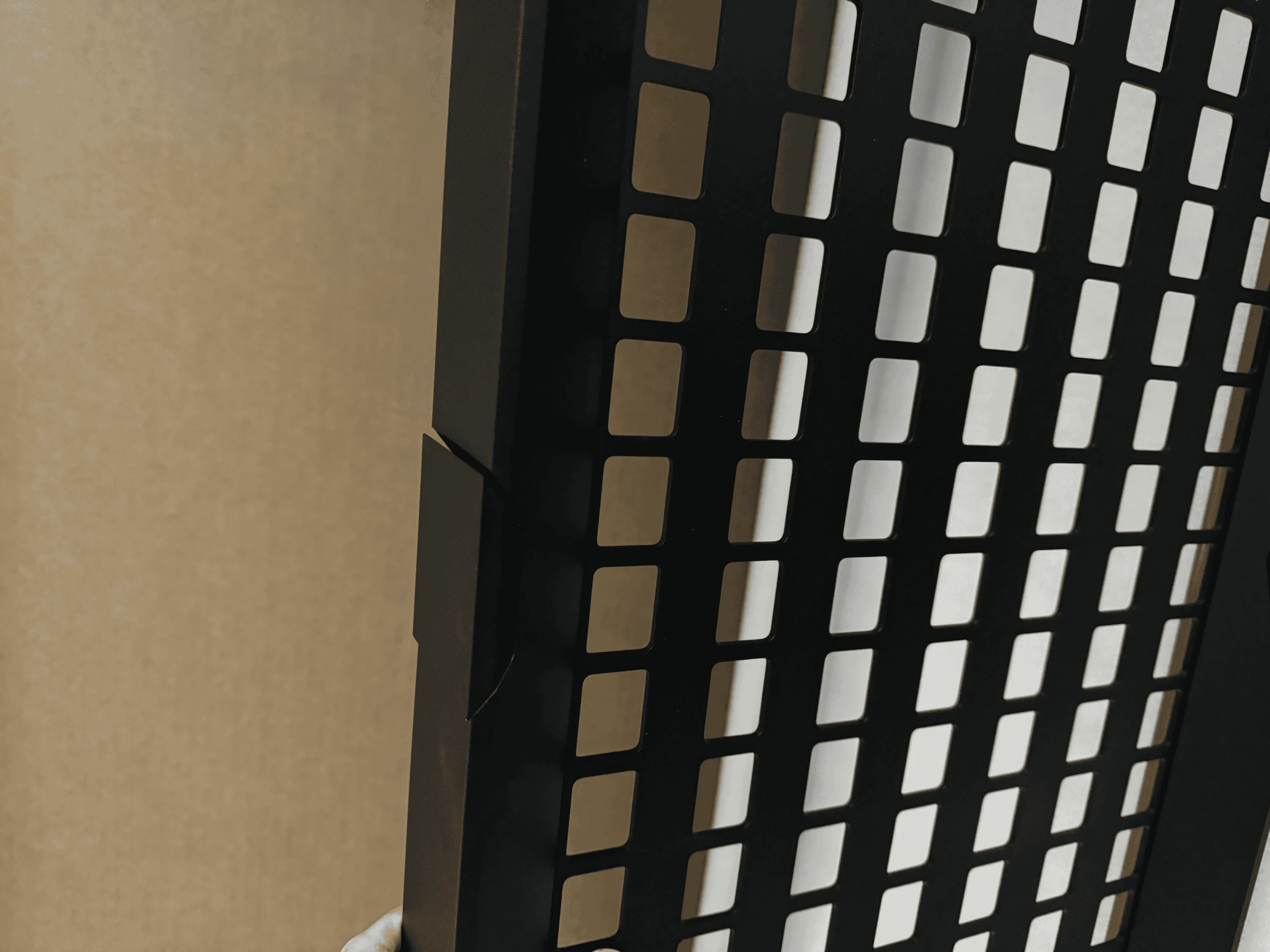

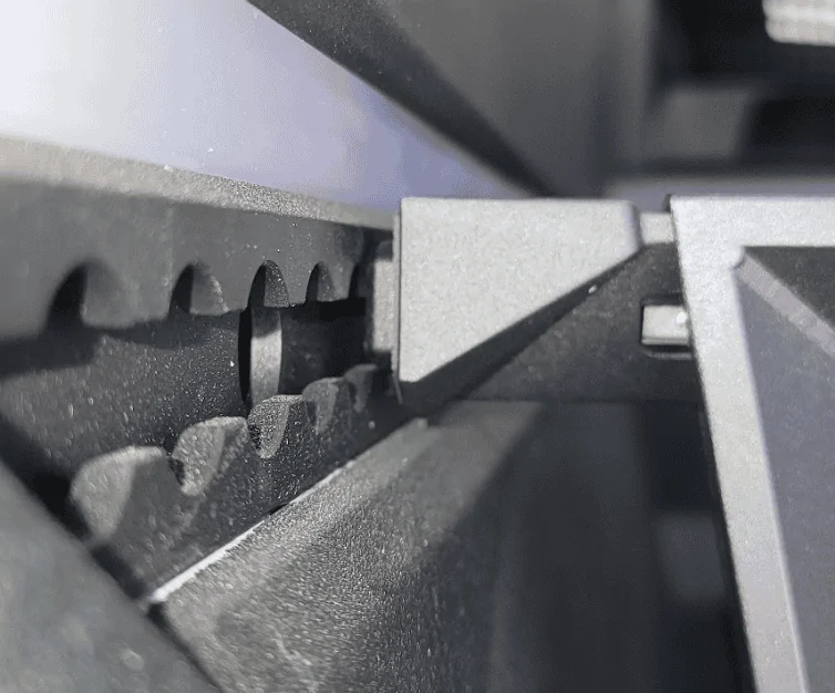

my issue is that my latch won't shut flat no matter how much pressure I put on it.
anyone else or am I not doing something correctly?

it should definitely go flat when you push it all the way down (assuming the connectors are aligned on both sides of it in the vault)

I know this response is months late but I have the same or similar issue. I had to literally kick down hard on the top to get both sides to seat. The bed height too high or the divider too tall. Didn't want to grind the bottom of the divider so I took to service. They sent a new one - same issue. I took a pipe wrench and carefully did a scary slight bend on the outer latch downward. This helped mine, but it doesn't seem like Tesla engineering allowed for normal fitment tolerance.

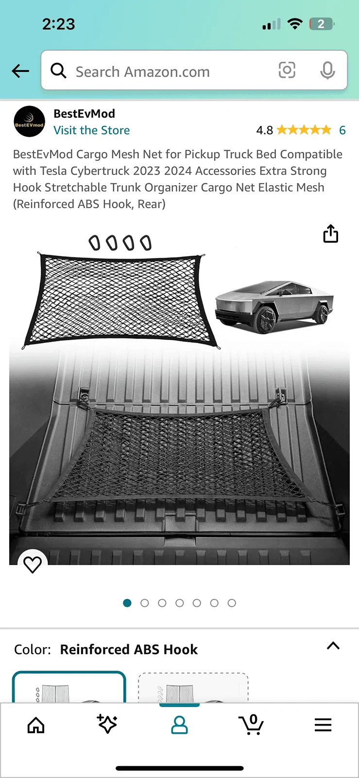

I bought this bed divider net today. I’m thinking it will fit perfect right behind the trunk easy to unhook for larger items, but provides a barrier for smaller loads, like groceries. Got this hold-down net too.
Please do a followup post with these items "in use" when you receive.

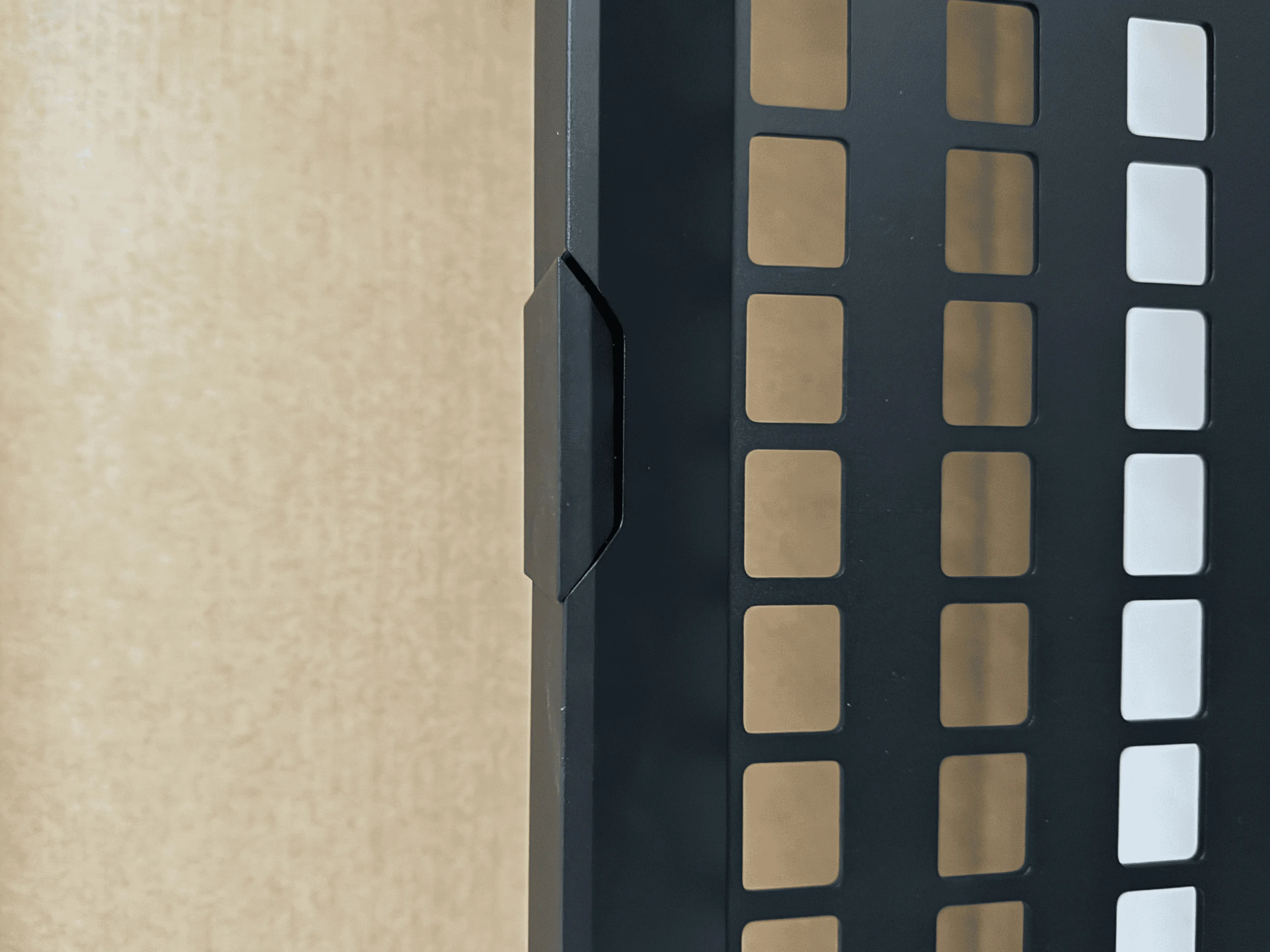

Any update? I just received my divider yesterday is this issue persists. In my case it is off almost 1/4" and no amount of sitting on it or kicking it will get it to engage the bed rails. Same from the tailgate to the cabin.

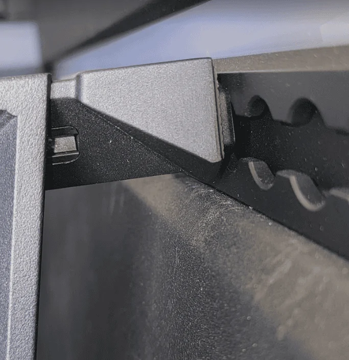

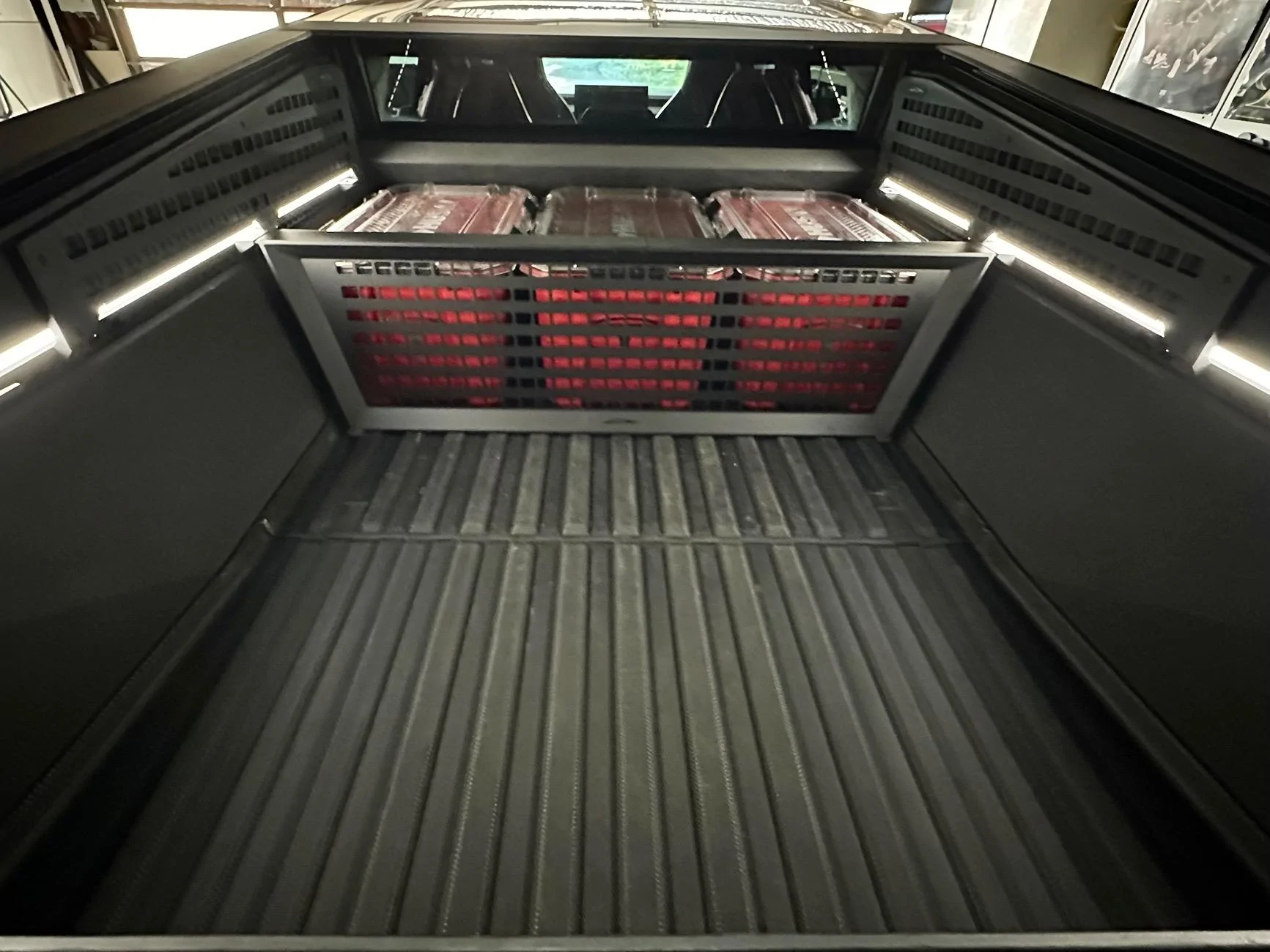

Completely irrelevant, but I just got my divider yesterday and alignment was not perfect, even with the bed liner out of the way. I just set mine in place where the bins were secure, pushed the handle down (not overly difficult, but pins are not locked into rail holes), and I’m good with it lol.

I have the same issue. It seems that the rear part of the bed plastic cover is not properly tightened down and is sitting a bit higher than the front portion. This elevation difference doesn’t allow for the vault divider to properly latch into place
