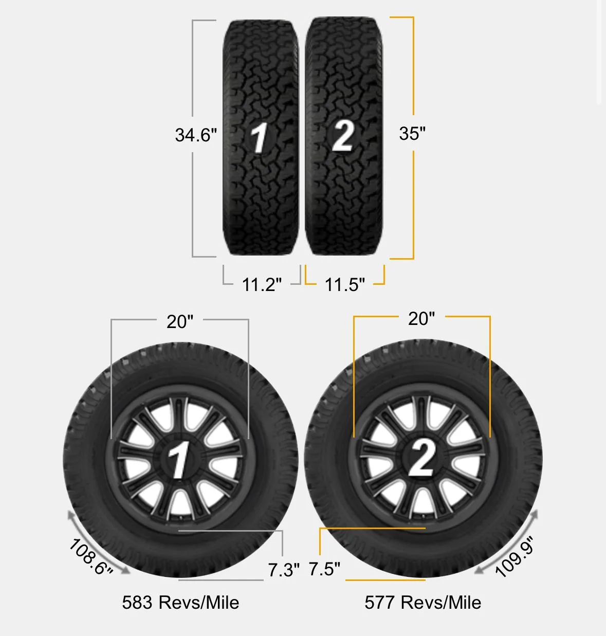

I’ve asked multiple reps at the dealership questions about the Cybertruck and they are so clueless it’s actually kind of hilarious. Anyone else see that? They can’t answer any questions about anything aftermarket whatsoever. But I’m curious if any tire people out there know if it’s possible to use any tire on the cybertruck? I have Toyo Open Country M/T’s on my Jeep right now, and I think it’s my favorite aggressive tire. I want to put some on my new Cybertruck whenever it comes (not worried about range, I drive minimal distance for work) Is this tire possible in a 35 on the cybertruck? I saw a YouTube video where they did Nitto Grapplers and he mentioned tire choices are limited. No clue why. What about a mini lift or spacers? I want to treat my CT like a truck, but can’t find any info on what you can do to this thing. Any guidance would be appreciated!
Load rating will be important. Stock tires are LT285/65/20. Due to the front upper bearing, you don’t have much flexibility if you’re using stock wheels. There’s only like a half inch of space between the bearing and the tire on the stock setup.
If you get a wheel with a lower offset and more backspacing, you can go bigger. One guy runs 35x12.5 and he rubs slightly. And, he runs it all the way slammed at entry height. The wheels he was running was a 20x9 0 offset; which is 58.5mm negative of stock.
I’ll be running 20x9.5 +20 offset with 35x11.5” tires (which is .2” wider than stock).
So which tires will you be getting that will fit the Cybertruck? Can you post exact specs and model or link to them? One thing I also want is for the tires to stick out a little bit more, without using spacers. Is the tire you’re going to get going to give that look?
Yep!
I ordered Volk Racing TE37 ULTRA LARGE PCD 20x9.5” +20 offset. The tires are Yokohama Geolandar M/T G003 in 35x11.5.
Keep in mind, stock is 20x9” +58.5 offset with 285/65/20 tires.
So, my setup is .3” wider with the tires.
Additionally, the new wheels are -38.5mm offset (58.5 minus 20), which means it will poke a little over 1.5” from the current setup.

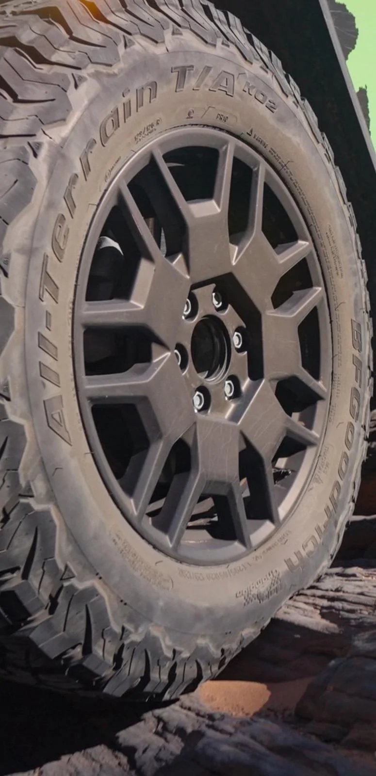

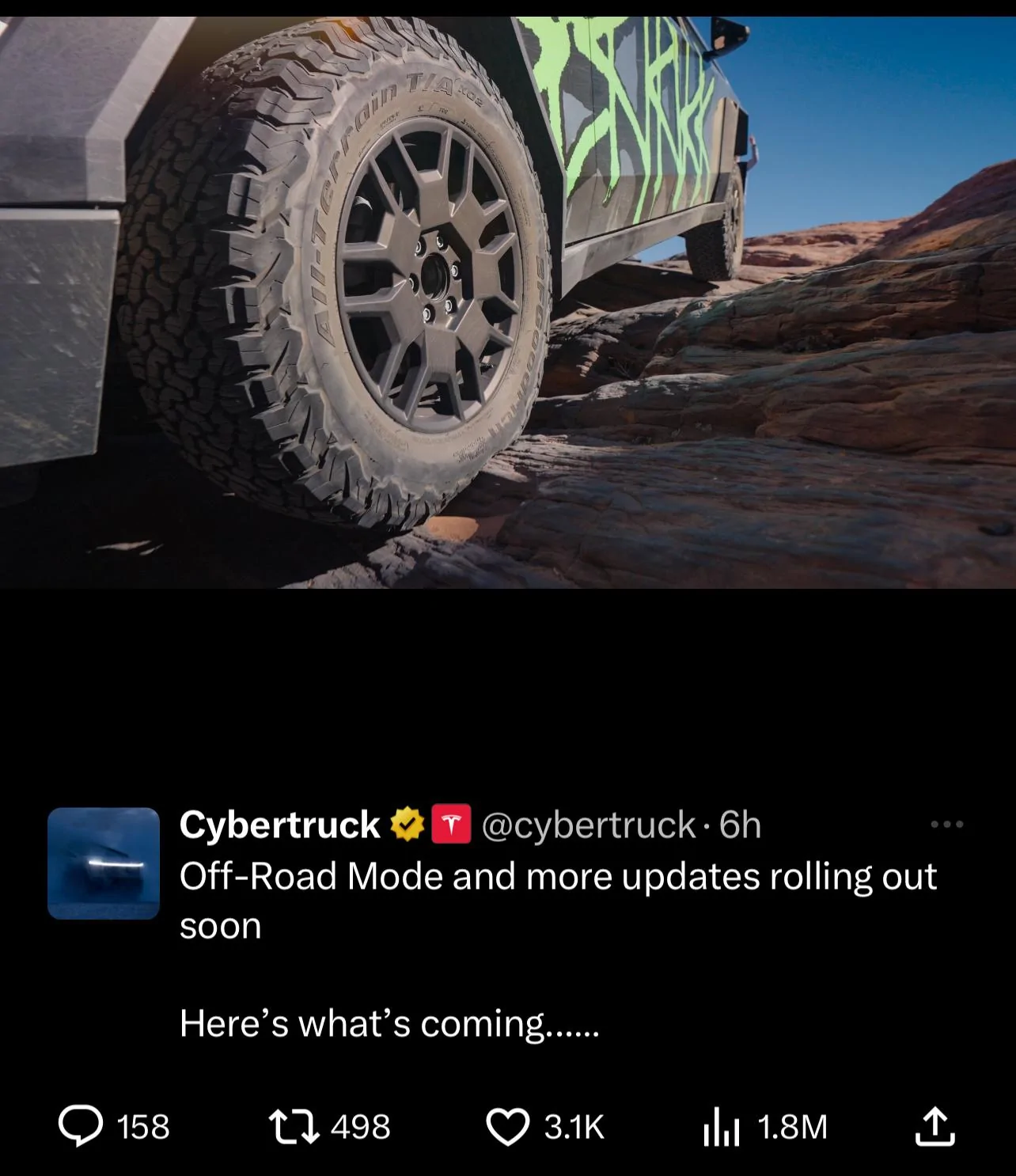

Anyone catch the official Tesla cybertruck twitter page about the new off-road features?
Zoom in and they’re showing the CT on KO2s vs the stock tires… maybe not an official endorsement but it’s coming from Tesla itself
Tesla Cybertruck Changing tires on Cybertruck. Anyone know?? IMG_3912
Tesla Cybertruck Changing tires on Cybertruck. Anyone know?? IMG_3913
