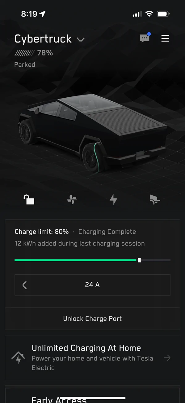

Tesla Cybertruck Charge limit 80, Wake Up to 78. Wtf? IMG_8949
I’ve turned off all preconditioning just to be clear. No cabin cooling or anything
I live in Texas. Yes hot
CT is garaged nightly
So can someone tell me why I wake up many days, not all but many, to a 78% charge?
almost positive this is never the case with my wife’s MY sitting right next to my CT. She’s 80 every single morning
All of our Teslas vary a percent above or below on home charging. I’ve never lost any sleep over it.

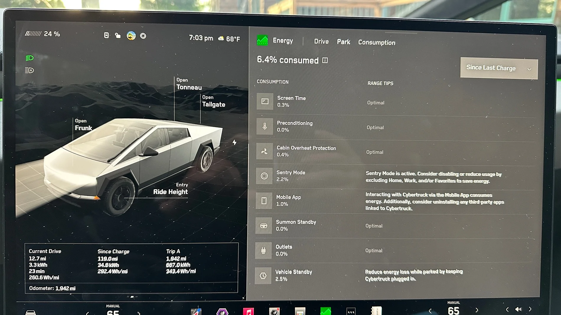

What does the Energy>Park screen show? Is the difference in the last line, Vehicle Standby? To me that's the vehicle fudge factor, but possibly due to BMS temperature adjustments. Your truck's battery is warm/hot when you enter the cooler garage. By morning the battery has cooled to ambient from when you charged it the night before. That may show up as a small loss in the Vehicle Standby line.
