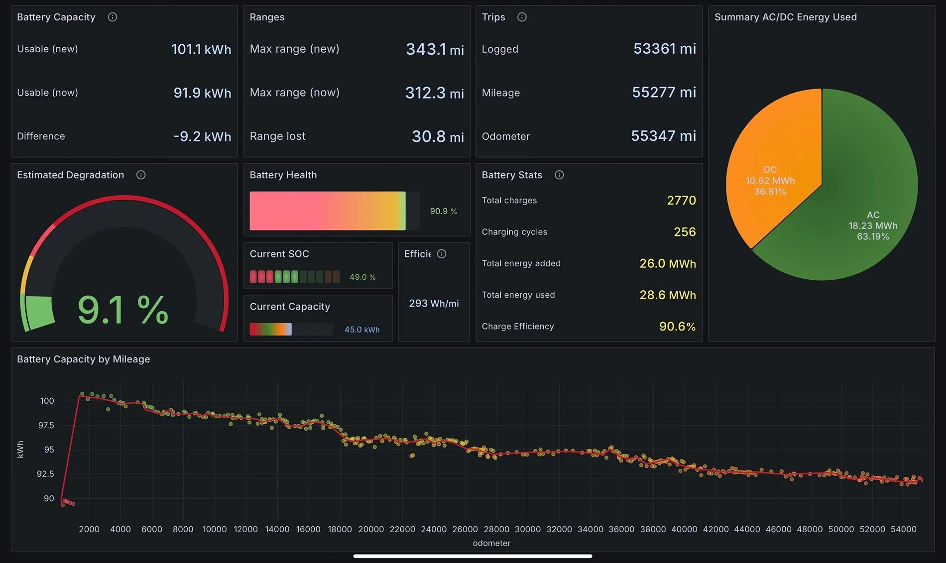

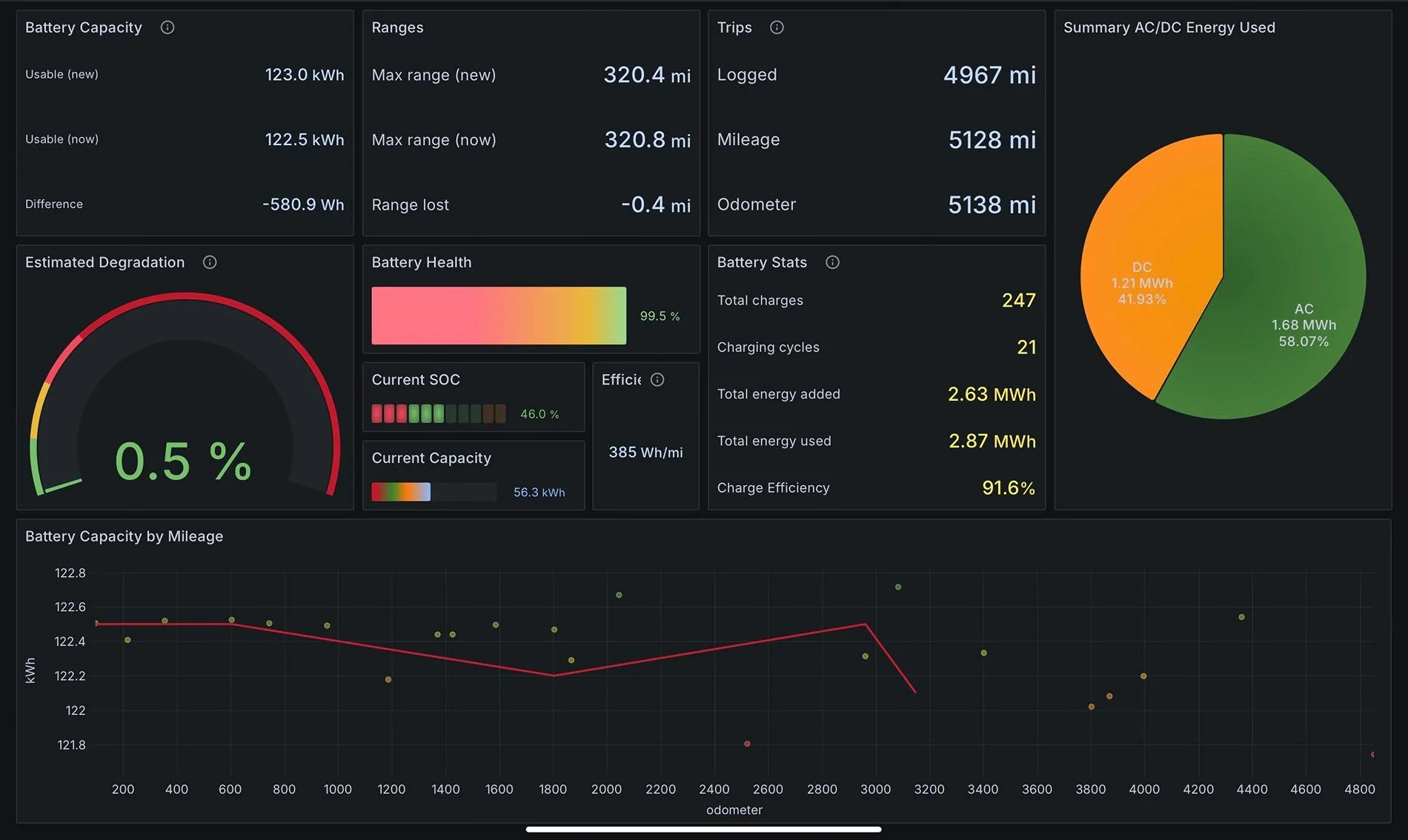

Some stats from TeslaMate, just for data points.
The ride with 55,347 miles in our 2020 X, the 5,138 miles in the Cybertruck. The dip in the graph on the X around 18,000 miles is when it the front motor grenaded and the X was in the shop for a month. It was at a low SoC when it got there, around 40%, and down to 20% when I picked it up. Stats are a double edged sword (for me), I love having them but when I see things like the drop in range after sitting at the shop for a month it kinda sucks :)
The X we have taken on a number of long road trips, thus the 10.62 MWh of DC charging over the 55,347 miles. Some of segments of those trips required charge session above 95% to make it. At first I was stressing about the battery health, my wife helped me relax about that :) Would be interested to see some stats from other rides with over 50k miles.
Tesla Cybertruck Ideal charge percent to keep the truck at for daily driving? IMG_0441
Tesla Cybertruck Ideal charge percent to keep the truck at for daily driving? IMG_0442

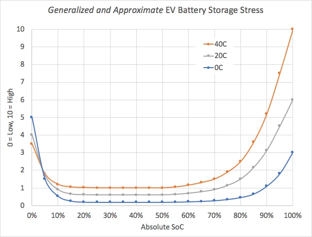

15% - 50% is consistent with this chart
Tesla Cybertruck Ideal charge percent to keep the truck at for daily driving? battery
And the source of this is?
And what is the penalty for being at a "3"?
What is the range reduction?
What it the battery life reduction?
Do you not think that Tesla does anything to maximize battery life?
