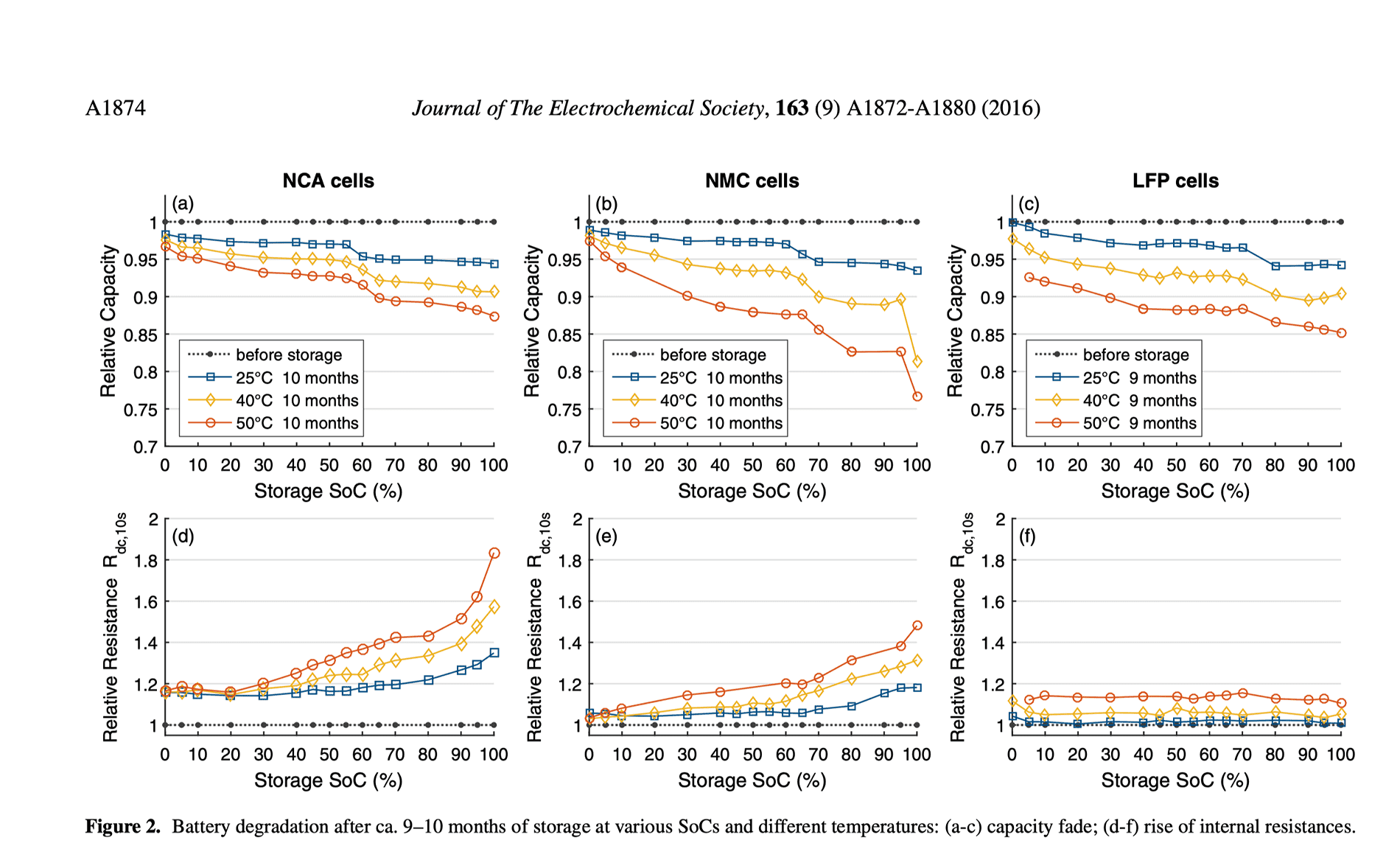

Why do you seem to feel that these are the first batteries that Tesla has ever made? We already have a lot of data.
Why, yes we do. There are numerous independent scientific studies of lithium batteries out there. I encourage anyone who is truly interested to do their own research and come to their own conclusions.
Interesting... so 60-70% seems to be an upper sweet spot for LFM? If thats the case, I am going to lower my daily driver to 65-70%
How is this relevant?
10 months of storage?! In a very high temperature?!
Even if we assume the above applies to Tesla batteries, the relative loss is so minor that it's not even worth worrying about. From 0.98 to 0.89 relative capacity loss? How much loss is that in real-world mileage? I bet the tires that you run would cause more of range loss than the battery capacity if you charge up to 50% vs. 80%.
It makes me even more certain to just charge it to 80% daily and not worry about it.

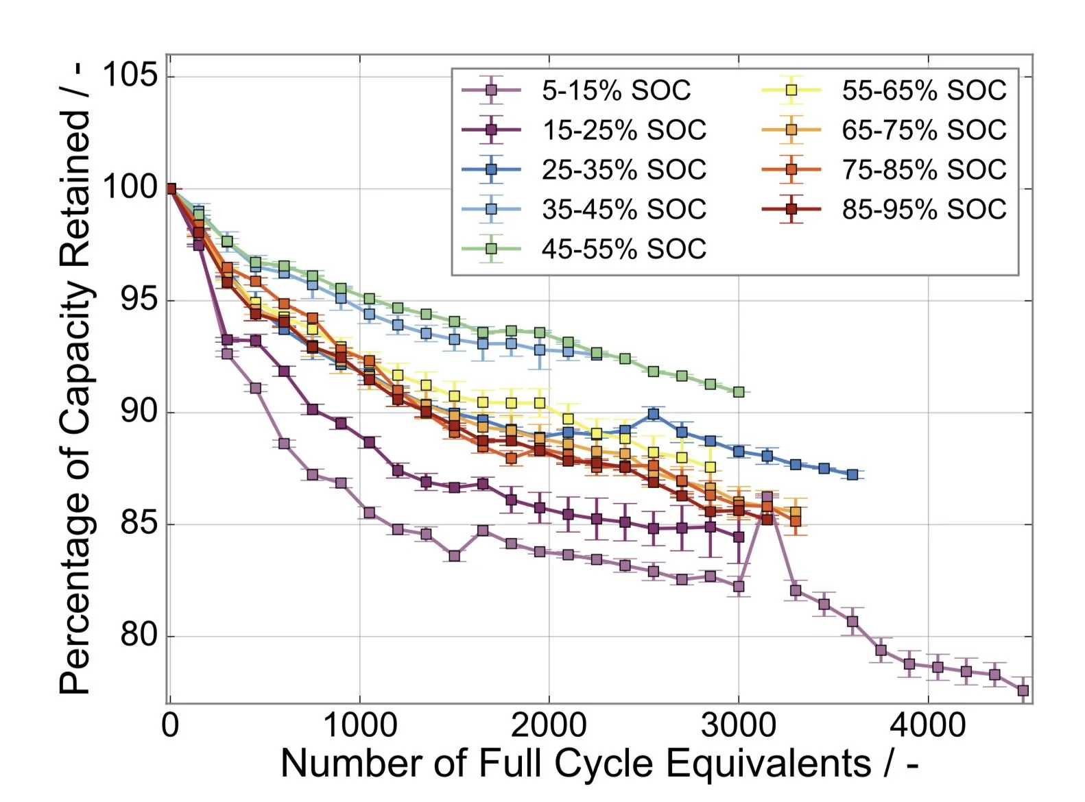

Tesla's battery data suggests keeping the pack at an average charge of 50%. So, if it takes 10% to drive to work, and another 10% to drive home, you should charge to 60%.
This is because SOC that degrades the battery the least over the long-term is 45-50%. Keep your average SOC in that ballpark, and your pack will calendar age similar to a battery in permanent storage at that same SOC.
Here's some better data from TMC: https://teslamotorsclub.com/tmc/posts/8194743/
So look at this closely. Remember, we are only looking at the blue line.
The difference between charging at 50% and 100% is only an additional 3% degradation.
That's less than the wheel covers represent.
But, from data collected on Tesla batteries, we know that the curves are different for Tesla batteries.
