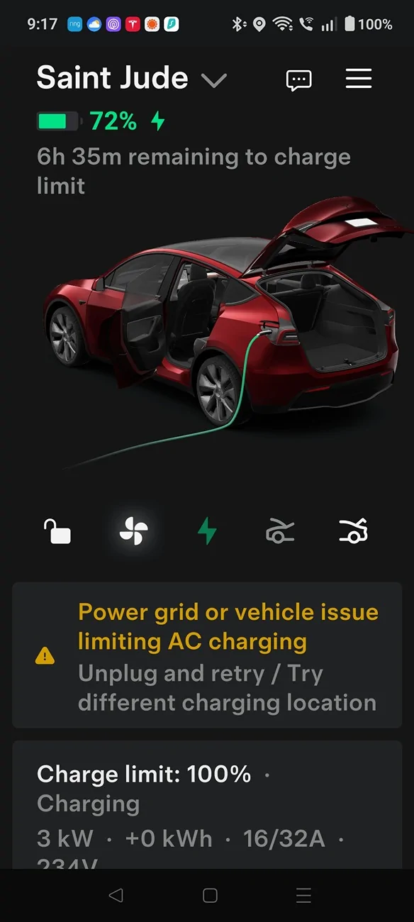

Need help troubleshooting a charging issue with my Cybertruck's 240V bed outlet. I hooked up my Tesla charging cable to share power with my Model Y, but the Model Y
Tesla Cybertruck 240v charging issues?? 1000284516
gave me the attached error alert. Has anyone run into this problem while vehicle-to-vehicle (V2V) charging? Let me know your thoughts."💡

If your truck is suffering from the PCS2 issue, your outlets will not function. Is that possibly the case?

Try reducing the Y's charge limit to 24A or lower. That's the max output if the Cybertruck PCS is partly failed.

Tesla’s Power Conversion System (PCS2) module, which contains three parallel, 16-amp charging stages (legs) to handle Level 2 home charging up to 48 amps. So it sounds like yours has partially failed (2 legs have failed). Limiting it to only 16amps. Is your home charging limited to 16amps as well?

Do you have the version3 mobile charger? I think it’s required for v2v
No, it doesn't
It contains two parallel 24 amp DCAC modules.
16 may be the Y reducing the charge rate 50% from the requested 32A.

sorry. You are right. AI struck again. Giving me bad information for the truck. My PCS2 went out recently on my CT. The Model 3 and Y apparently have the 3 leg system. The CT has moved to a more improved (or is it) 2 leg system.
The Cybertruck system is better (when it works) because each module can handle three phase lines plus neutral. So it's Europe/Australia / CCS-2 ready three phase ready (with a different ACJB).
The other vehicles have three two-line input modules so that they can be wired for three phase or single.

Yep. Mine failed with 14k miles on it. Have an appointment on June 23rd. Not sure how long the repair will take but it sounded like it was only a day or two repair. But they are giving me a loaner for the time it’s in. None of my outlets are working with my PCS2 issue.
