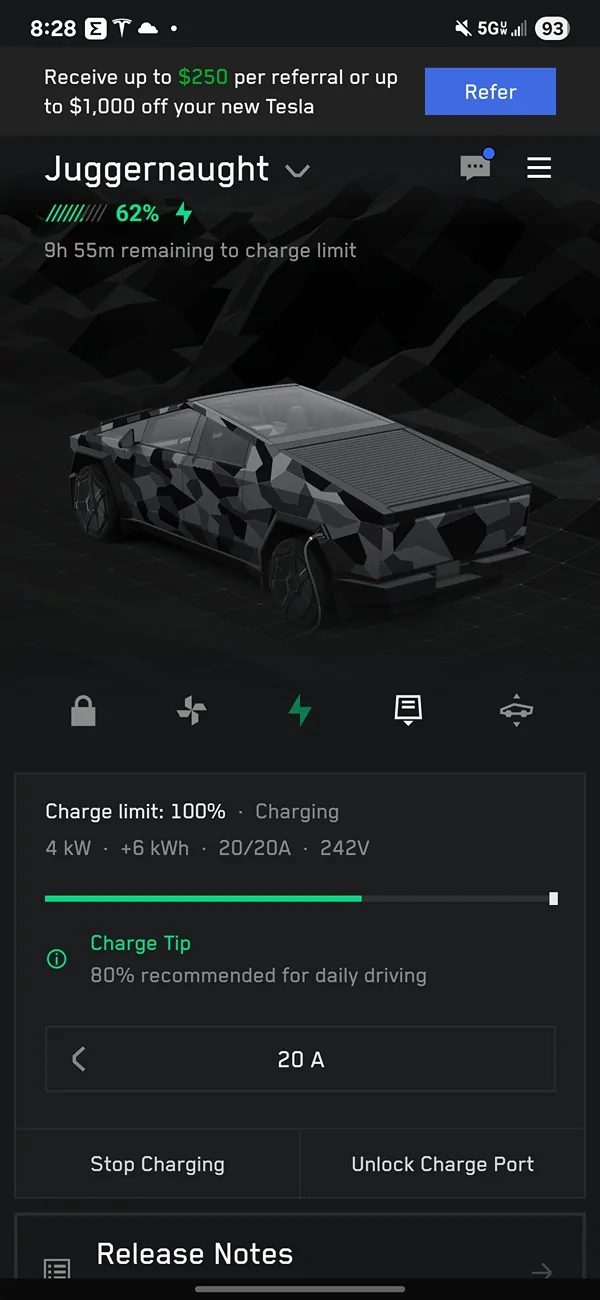

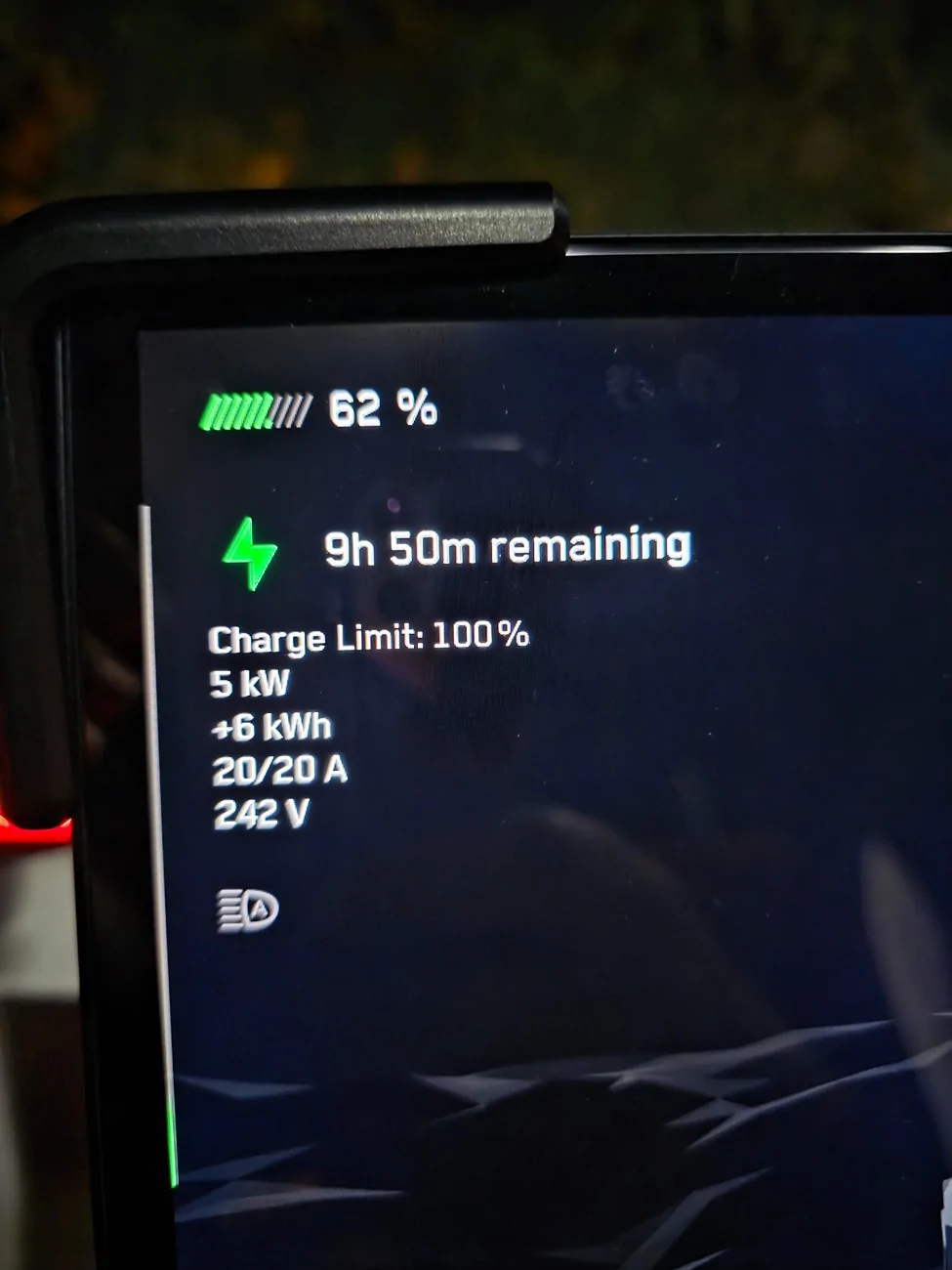

I've recently installed a Gen 3 charger at my house on a 60 amp breaker, but have yet to add it to my account so it's capped at 40 amps. When. I plug it in, it'll charge at 40 amps for a random amount of time, then, the charge limit is set to 20 amps.
If I stop charging and restart it, it will stay at 40 for a while and then drop.
I've opened service mode, and don't see anything at all there. Is there a log somewhere I could uod find to see what's going on?

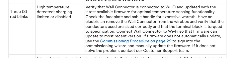

The top charger light blinks red after it happens.
Any ideas woukd be appreciated!
