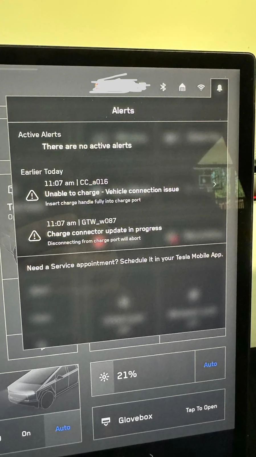

Charging Error cc_a016 - unable to charge

Thanks. I have been doing that. I was lucky enough to get it happening on video today.
Unfortunately my service center is 1h50m away.

I also saw this on my truck but it was after it was charged to 80%, like an hour later... I still have not attempted to charge to a 100%, but will do that during the next charging session. Curious what it is and wondering if everyone sees this or just some of us. BTW, my wall charger is Gen2.
UPDATE: Last night, I charged the truck to a 100% for the first time, translated to 301 miles :( I thought it was 305... anyways, I did not see any warnings or notifications pop-up during this charge, all was fine.

Update: Tesla directed me to the Home Charger support team. Who apparently don’t work on eclipse days. Will see what they have to say.
I charged to 100% today and got the same errors. So no difference there.

Update: Tesla support told me that the HVBATT_a223 error I was receiving periodically was a software bug and would be fixed. After they told me that I was pushed update 2024.8.12 later that day with “bug fixes”

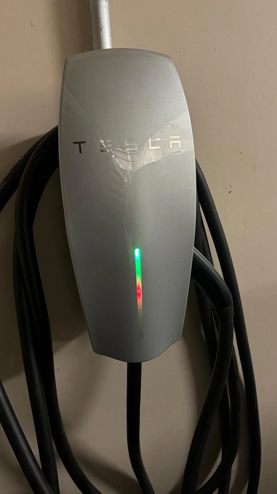

After the update, charging to the set level did not produce any errors in the truck. Even though the charger still displayed a red light, the truck port was no longer red.
Support did hint that there could be a “compatibility” issue with my older charger. I still need to find time to call home charger support.
