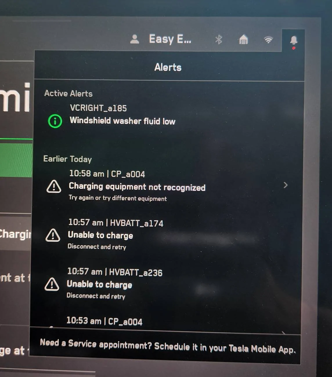

As the title says, I am getting an error every couple of minutes when trying to charge using a Lectron EVCharge14-50-40A and adaptor.
The errors are HVBATT_a174 and HVBAT_a236:
Tesla Cybertruck Charging fails when using a Lectron EVCharge14-50-40A and adaptor 20241125_105905
I have reached out to Lectron and they are suggesting a problem with the truck (works fine on my wall charger) or my adaptor (I have tried two with same result).
I have turned it down as low as 20A, and it seems to throw the error less frequently, but still an error. I have been unable to locate any information on the errors.

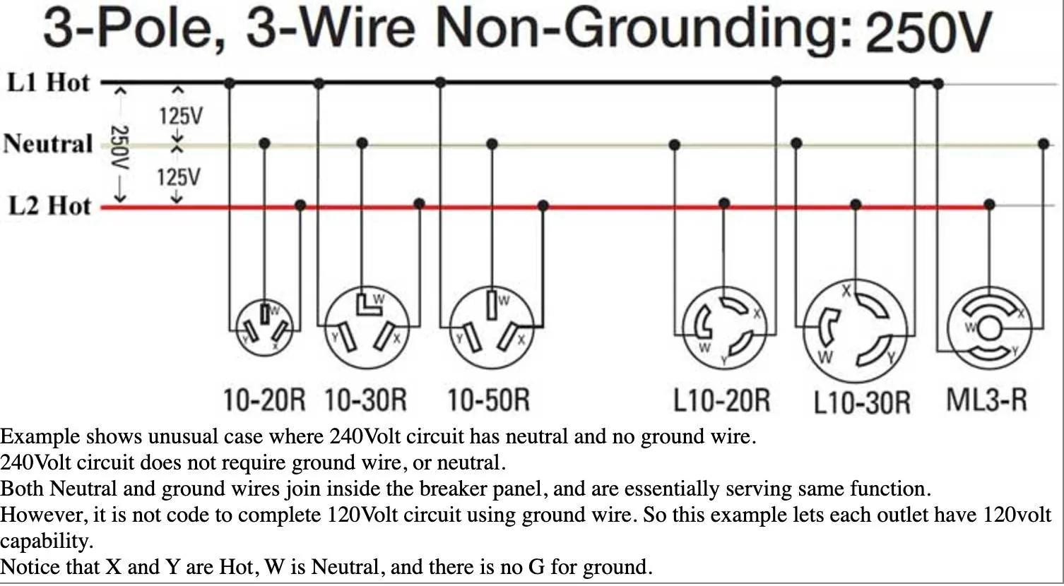

This:
Tesla Cybertruck Charging fails when using a Lectron EVCharge14-50-40A and adaptor Screenshot 2024-11-26 at 6.54.22 PM

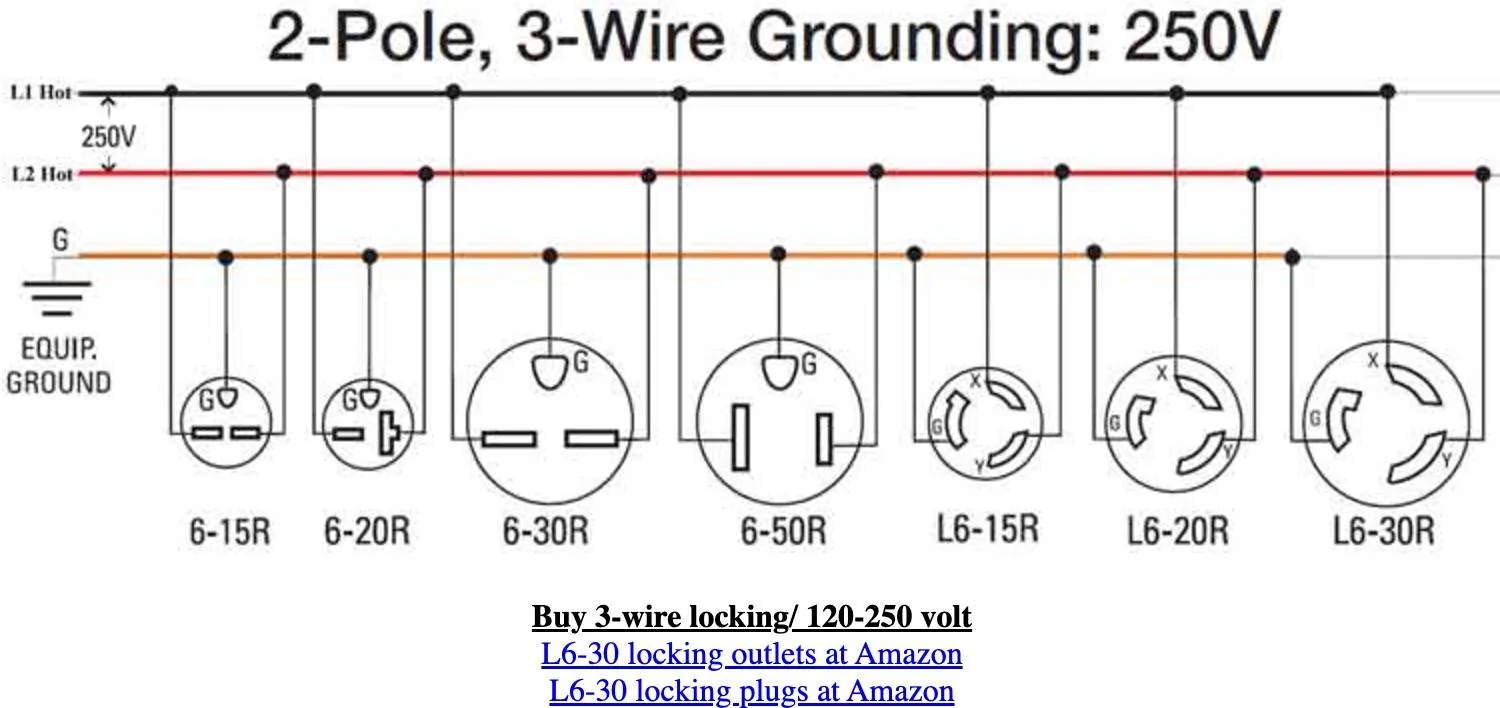

But also this:
Tesla Cybertruck Charging fails when using a Lectron EVCharge14-50-40A and adaptor Screenshot 2024-11-26 at 6.59.05 PM
That is because, as you correctly point out, Common and Ground are bonded at the main, or sometimes at a sub (most code does not allow ties at a sub these days). For most use-cases, Ground and Common are the same by virtue of being bonded.
Tesla may be a very special use-case, and I am curious. I will test tomorrow to determine if the Lectron works better (it works now, but just restarts periodically) when the bonding is at the panel and not at the receptacle.
A final note: The Lectron also has a problem running on my 4-wire solar inverter. This gives even more credence to Franks point that it is not about whether they are bonded (they are if you are code), what maters where they are bonded.
