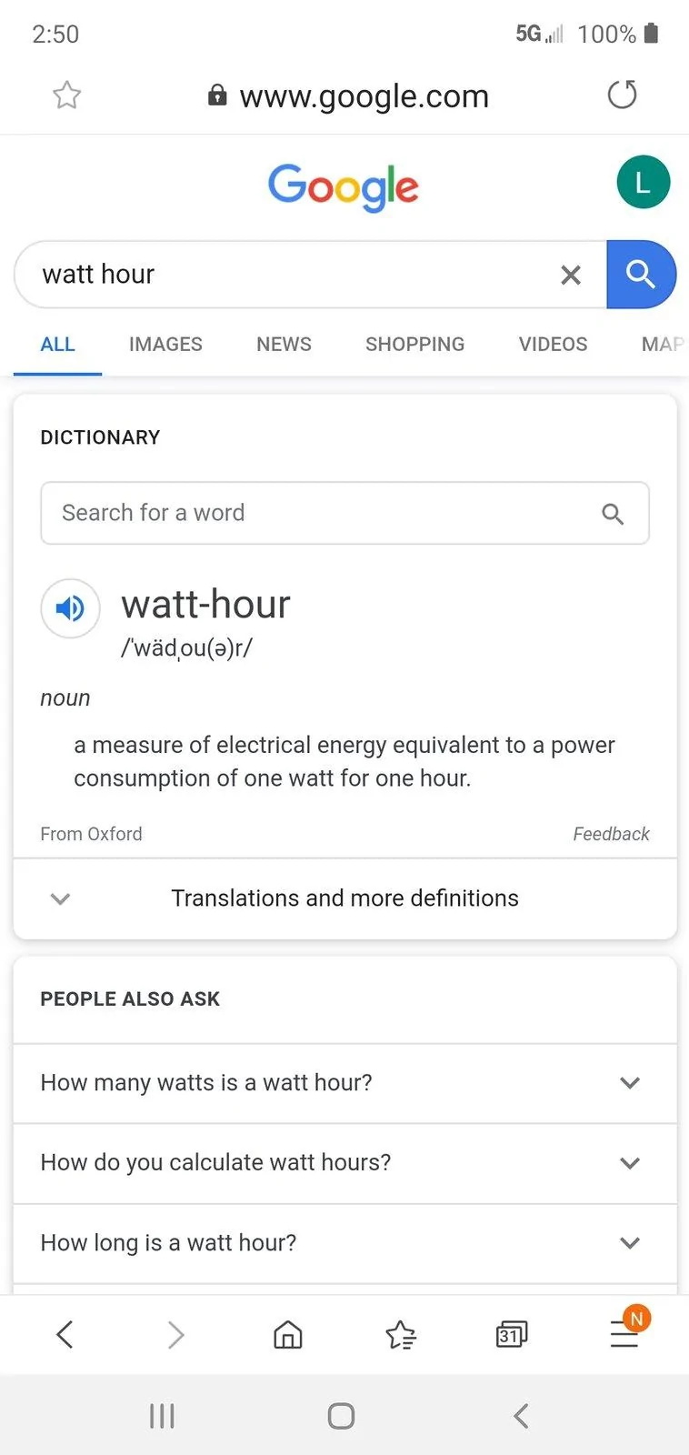

Now he wants us all to know that he doesn't understand the difference between watt-hour and watts per hour. Sorry guys. I put him on "ignore" status.

? that's because it's the same thing, no let me use the exact word " equivalent ".
