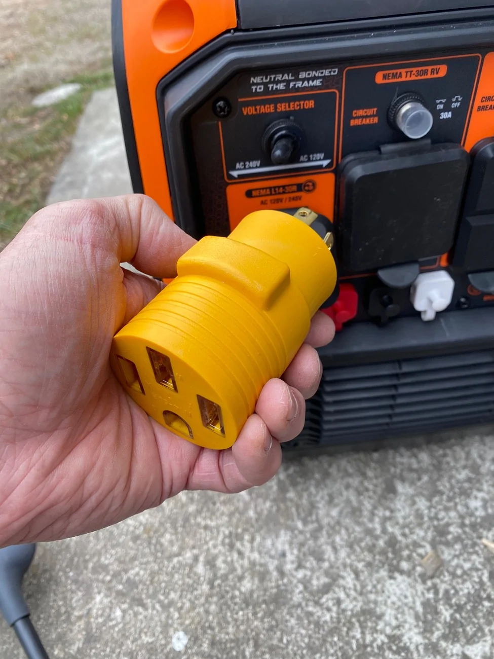

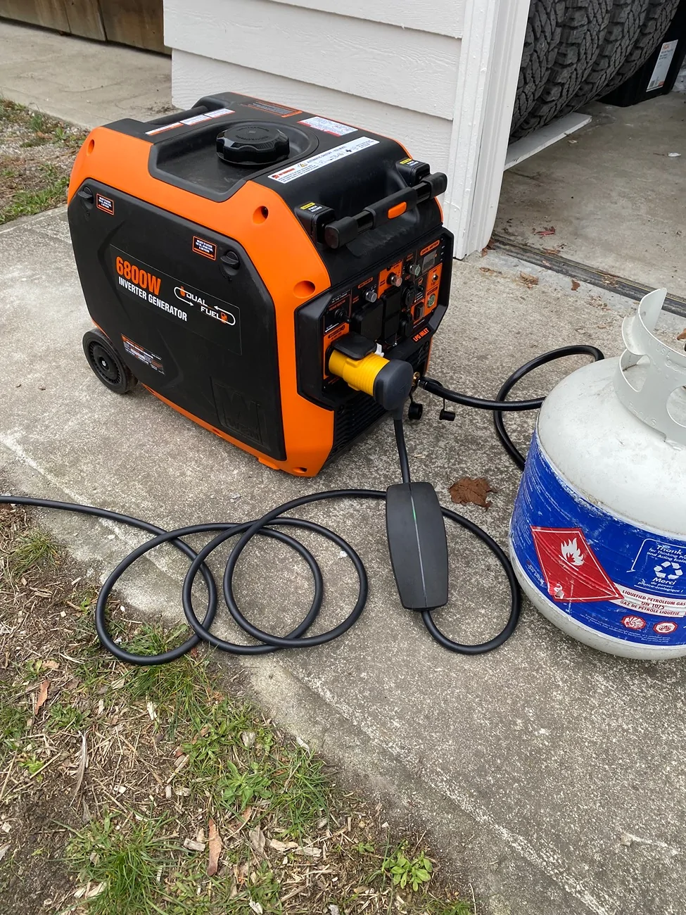

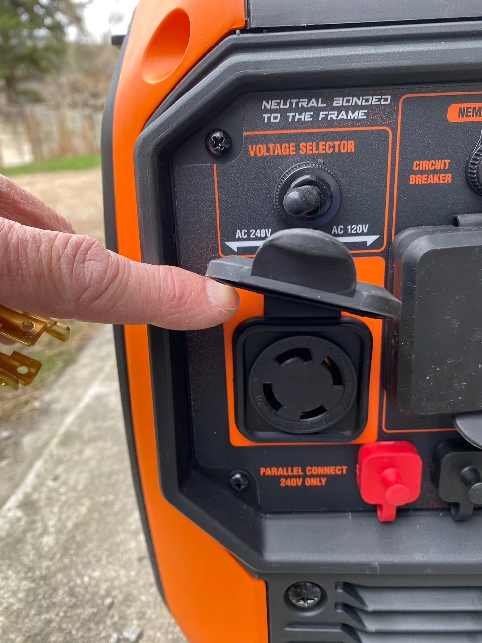

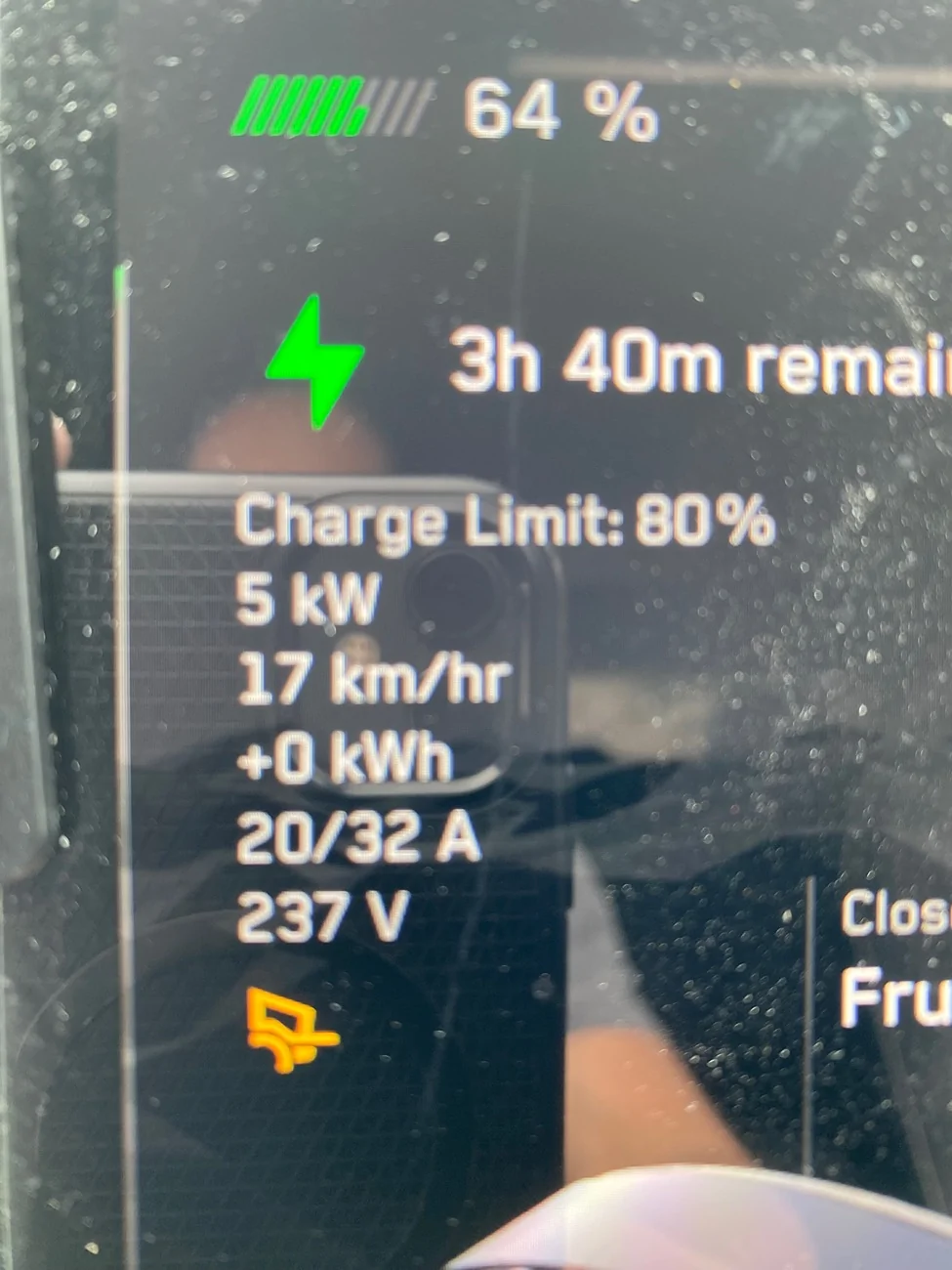

I bring this along just in case!
Haven't needed to use it yet, but better safe than sorry.
That's not going to add much range before that propane tank runs dry!

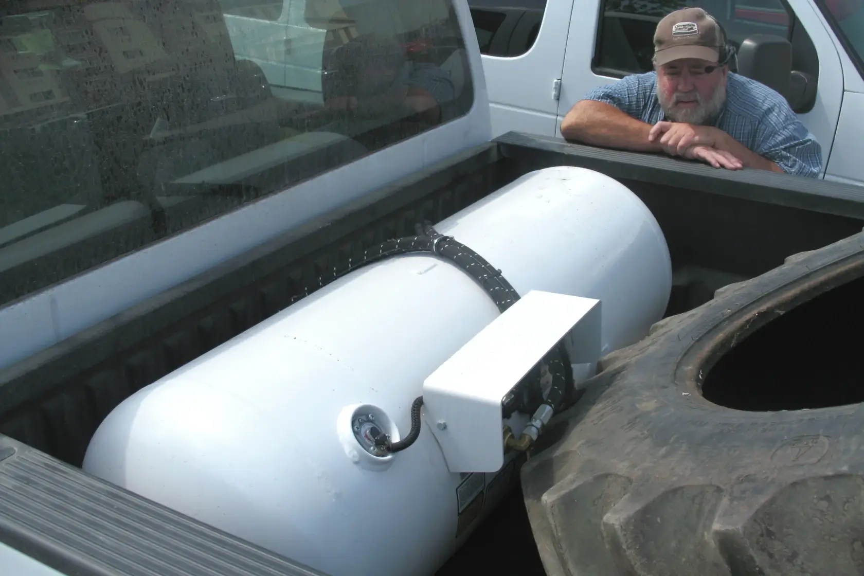

Many years ago I worked for a company with a small fleet of 4x4 pickups that had all been converted to run on propane instead of gasoline. They had a tank this size permanently mounted behind the cab:
Tesla Cybertruck Charging in remote areas 1776877458152-ra
They had a range of about 200 miles so we had to fill them up every time we used them because the round-trip was a bit over 100 miles. It was a stinky process bleeding off all the extra pressure as we filled the tank and it took around 15 minutes as I recall. They were about 20% more gutless than the gutless gas V8s the trucks came with. We had two Dodge Powerwagons, one F-150, and a GMC box truck, as I recall.
Pros:
Small fuel savings
Excellent ability to start in extreme cold
Less stinky exhaust
Potentially longer engine life and extended oil changes (less carbon buildup)
Cons:
Inconvenient to fuel
Gutless
Loss of bed space
More weight
I'm guessing a small propane tank will only add about 15-20 miles of range before running out. For extended boondocking my preference would be solar panels that could be deployed on the ground.
Pros:
Small fuel savings
Less stinky exhaust
Cons:
Gutless
Loss of bed space
More weight
All valid points and I agree, probably not the best set up for Boondocking. And now you've spurred me on to do a test run with a 20 pound tank and see exactly how many miles I get... that would be good to know!
This is just cheap insurance, I have several propane tanks and this compact unit only ran me about $800.
I do love the idea of a solar set up, but that gets pretty spendy!
