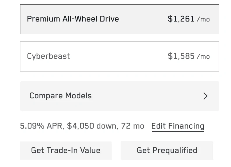

Financing just changed.
If I can't get 3.99%, I will not be buying.
Feeling like a bait and switch here.
